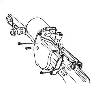

My original problem was the front wiper motor would not shut off. For about 2 weeks I was pulling the fuse and then the motor burned out. However, at that time the washer motor would run continuously. I got a new wiper motor and installed it and now I'm back where I started with the wipers not shutting off. I have removed and unplugged the multi switch from the steering wheel, and it still will not shut off. I also tried re grounding the motor, and still the same problem. This thing is driving me crazy! Can you please help?
P.s. There is no moisture sensor on this.

Replace the windshield wiper motor cover.

I have already changed the motor assembly, including the front cover and am still having problems. Any other suggestions?

Thank you. It makes sense what you are saying. The cover is good, but I do have a question.....is the black wire constantly hot to the motor? Aslo the yellow wire is hot when turning the switch on is that correct? Thank you again for your help Brian.

black is ground which is M on the connector and yellow is Accessory Voltage.1 question does this vehicle have outside moisture sensor? also I forgot alot of the 02-05 t blazers had a water intrustion problem at the wiper motor connector,it was very common and turned into a recall,check the connector very close for corrosion that will also cause the wipers to not shut off.if none of this solves the problem post back an will assist further.

No moister sensor.....I have 2 blacks at the connector.....one is thicker than the other....I replaced the motor plug connector on the female side....it was water damaged...if the thicker black wire is ground, than I'm shorting somewhere....I think? Please let me know your thoughts.....just rechecked and wires on supply to motor...found large black wire to ground got continuity and found a blue wire to ground, got continuity. Question, there is only supposed to be 1 ground with no voltage going to it correct? If so, which is the true ground?

M on the connector is ground,the other black wire is for the outside moisture sensor which is A on the connector,but you dont have rain sense wipers, so M is the only ground.also recheck the wires you repaired for loose connections or corrosion,as far as testing,your at the wrong part,start by disconnecting the connector at the multi-function switch.it gets its input from that switch to the wiper motor,and the wiper motor is the ground.on the chart that I posted follow that,your going to test the windshield wiper switch high signal circuit in the steering column harness for a short to ground. this is how you test it,Remove the power feed (i.e. fuse, control module) from the suspect circuit.
Disconnect the load.
Set the rotary dial of the DMM to the ohm position.
Connect one lead of the DMM to one end of the circuit to be tested.
Connect the other lead of the DMM to a good ground.
If the DMM does NOT display infinite resistance (OL), there is a short to ground in the circuit.you need to have a mult-meter to test it.your testing for a wire that might be grounded somewhere,which would cause the wipers to stay on,test this first,then will go to the next step.I have a feeling it might need a mult-funtion switch.but test this first.

Fixed problem....grounded wire....unfortunately, fixing one problem created another.....is there a way to reset the security light? Thank you again for your help.
