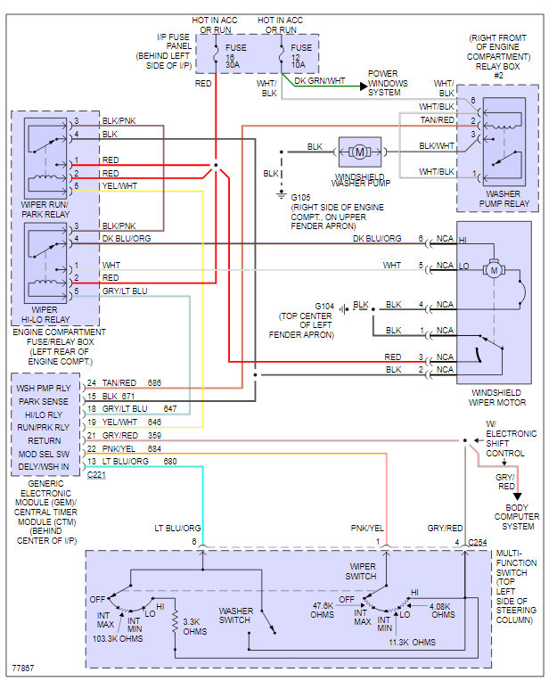

Wipers work when engine is turned not completely off. But will not or sometime works when engine is running.
Jul 20, 2017 at 1:57 PM
Experienced Mechanic
55,616 POSTS

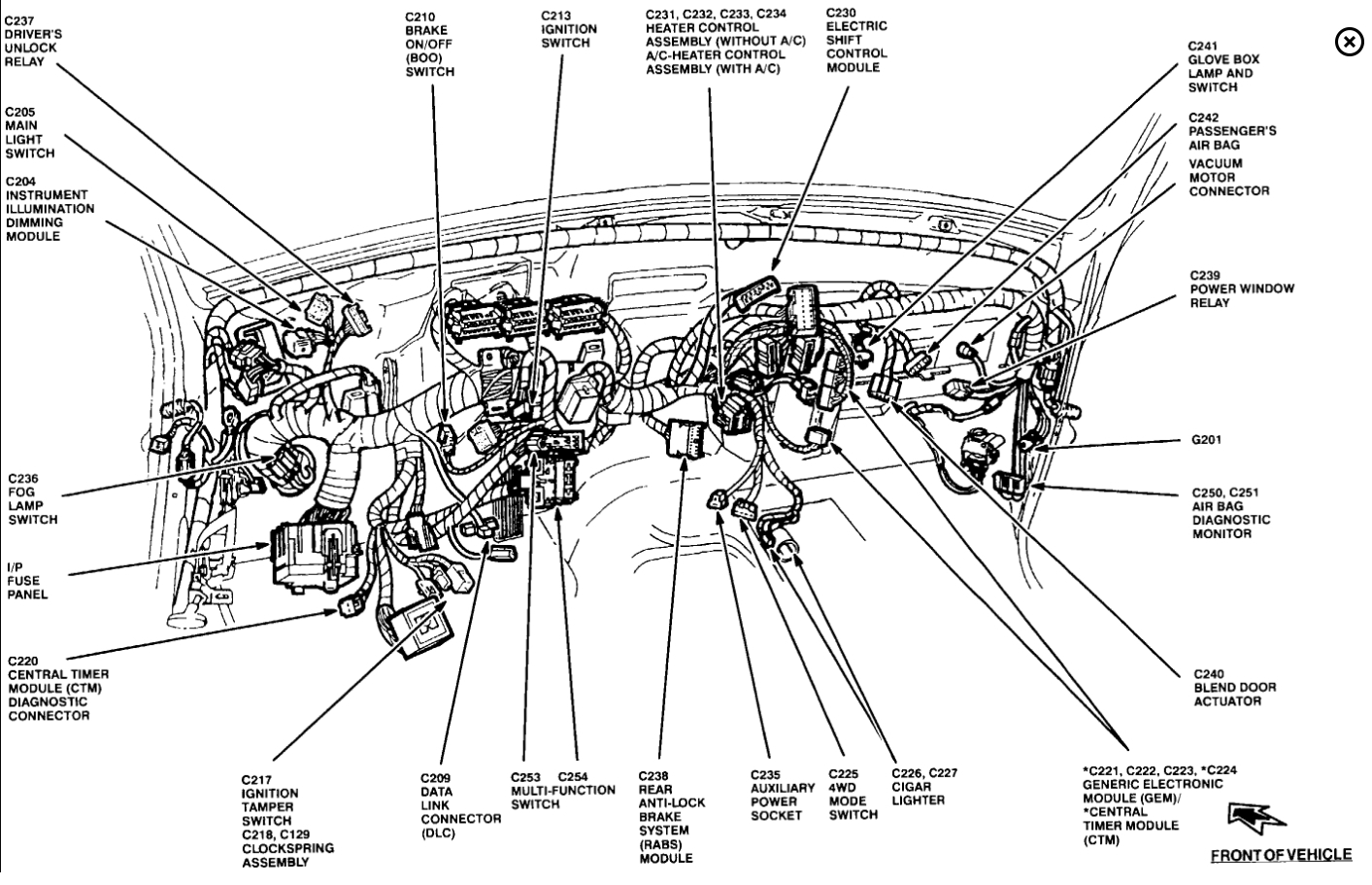

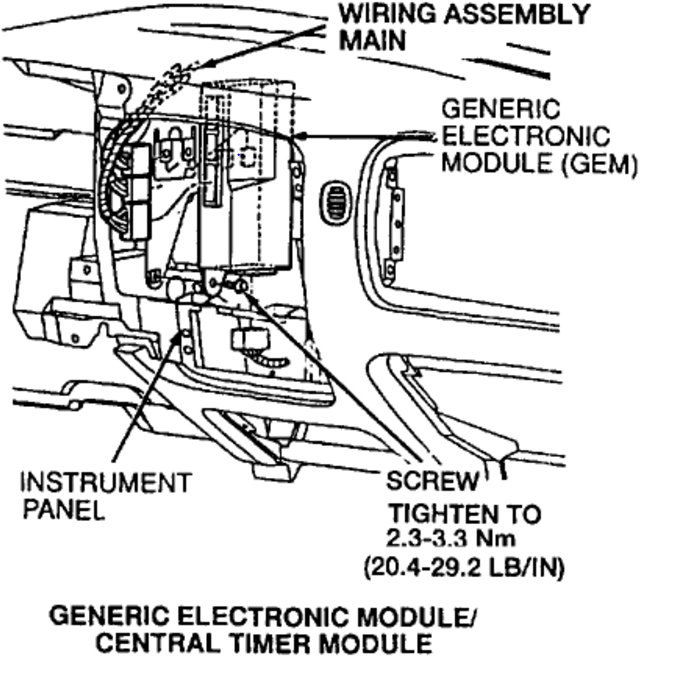

It sounds like you have a GEM going out (generic electronic module). Here is a wiring diagram and location (below) and some guides so you can confirm.
and
