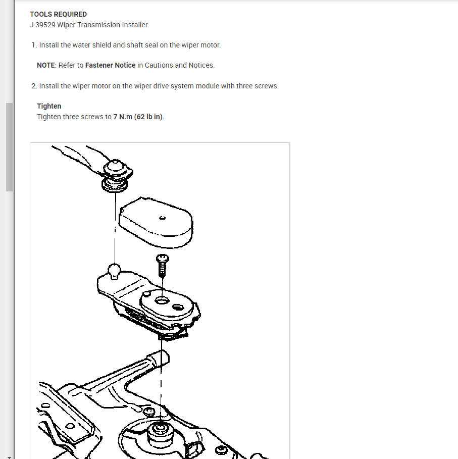

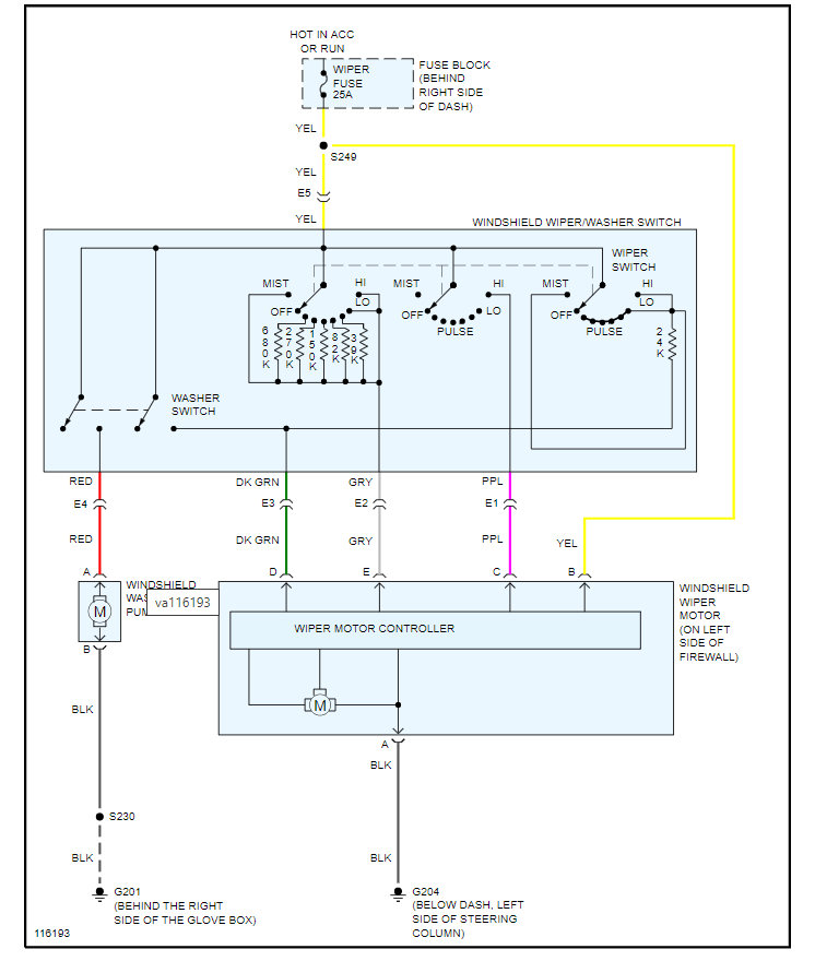

Ever since my motor in my windshield wipers has been replaced, they park in the upright position when on, when off they go back down. But today while I was on the highway, they just stopped wiping my windshield and stayed in the upright position for the rest of the 10-minute drive. At least until I pulled over to put them down so I could see, because they wouldn't go down when I turned them down.
Oct 5, 2021 at 7:12 AM
Just to be clear, this issue started after you replaced the wiper motor.
Did you replace this for a different issue or for this exact issue?

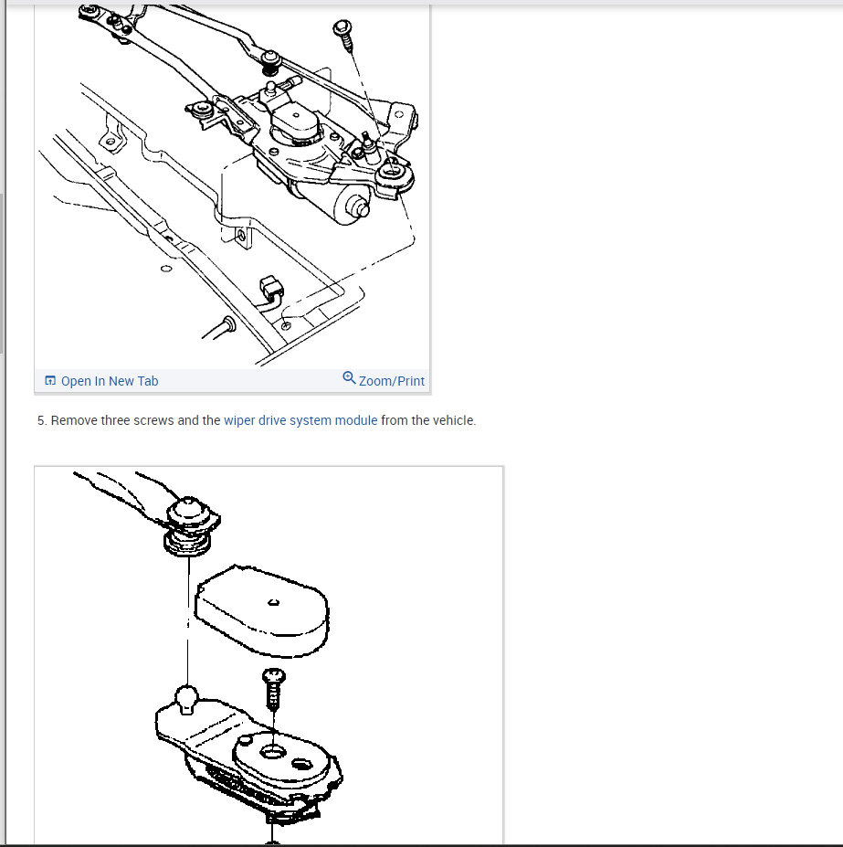

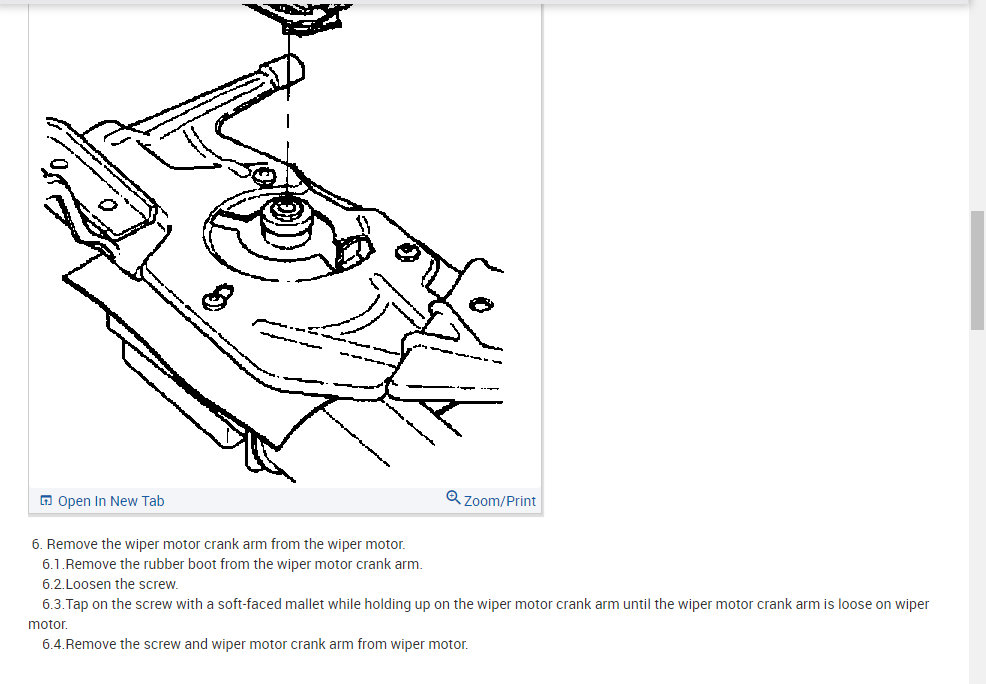

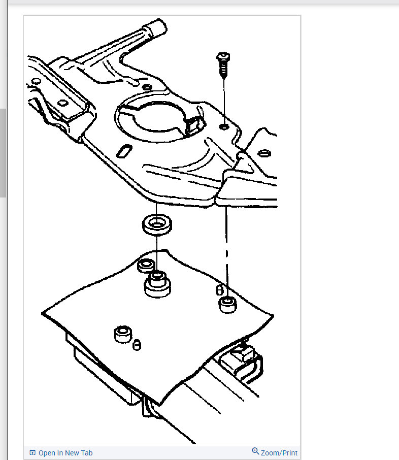

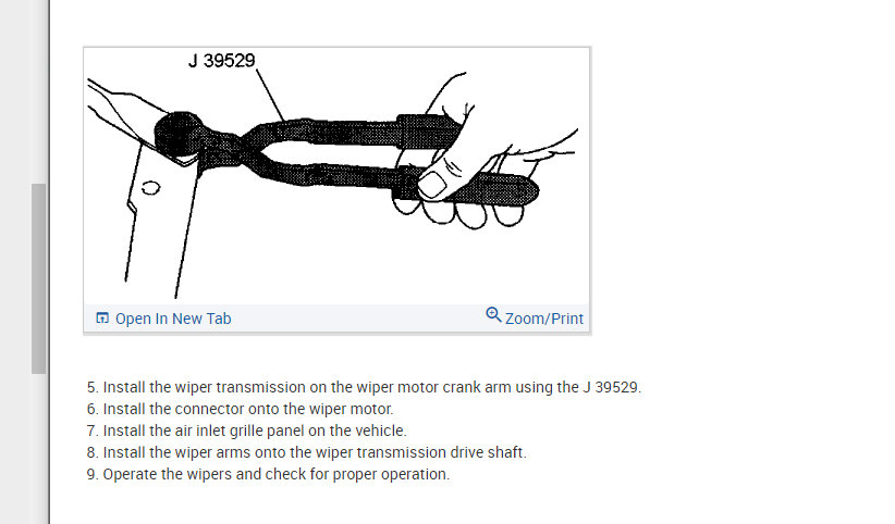

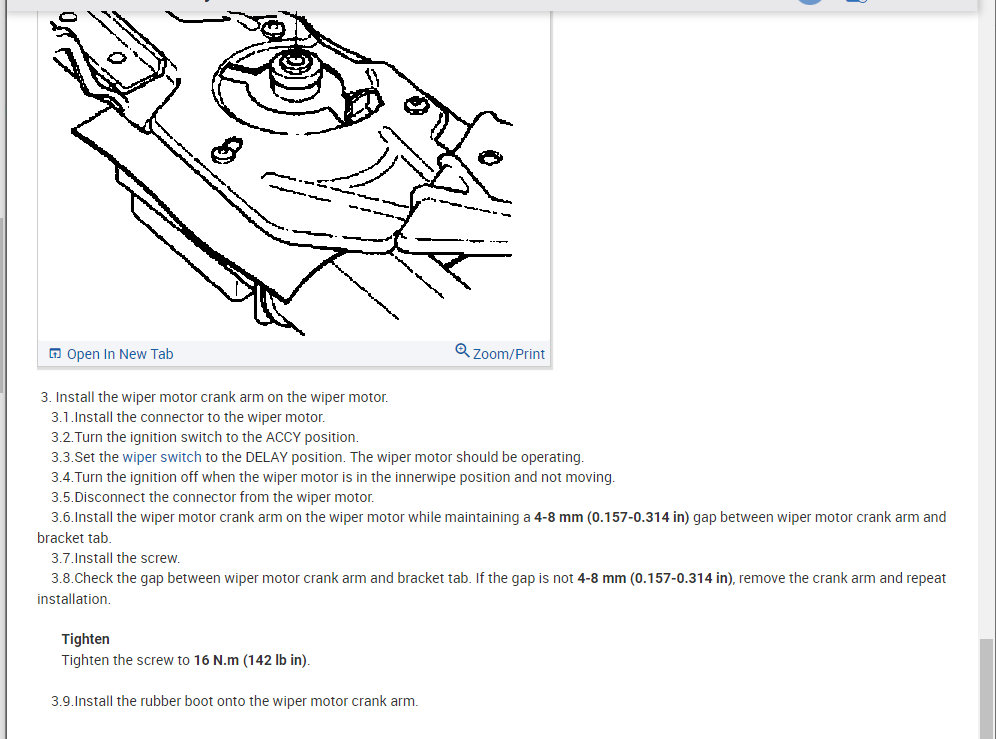

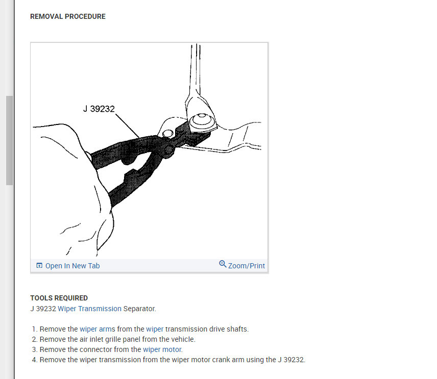

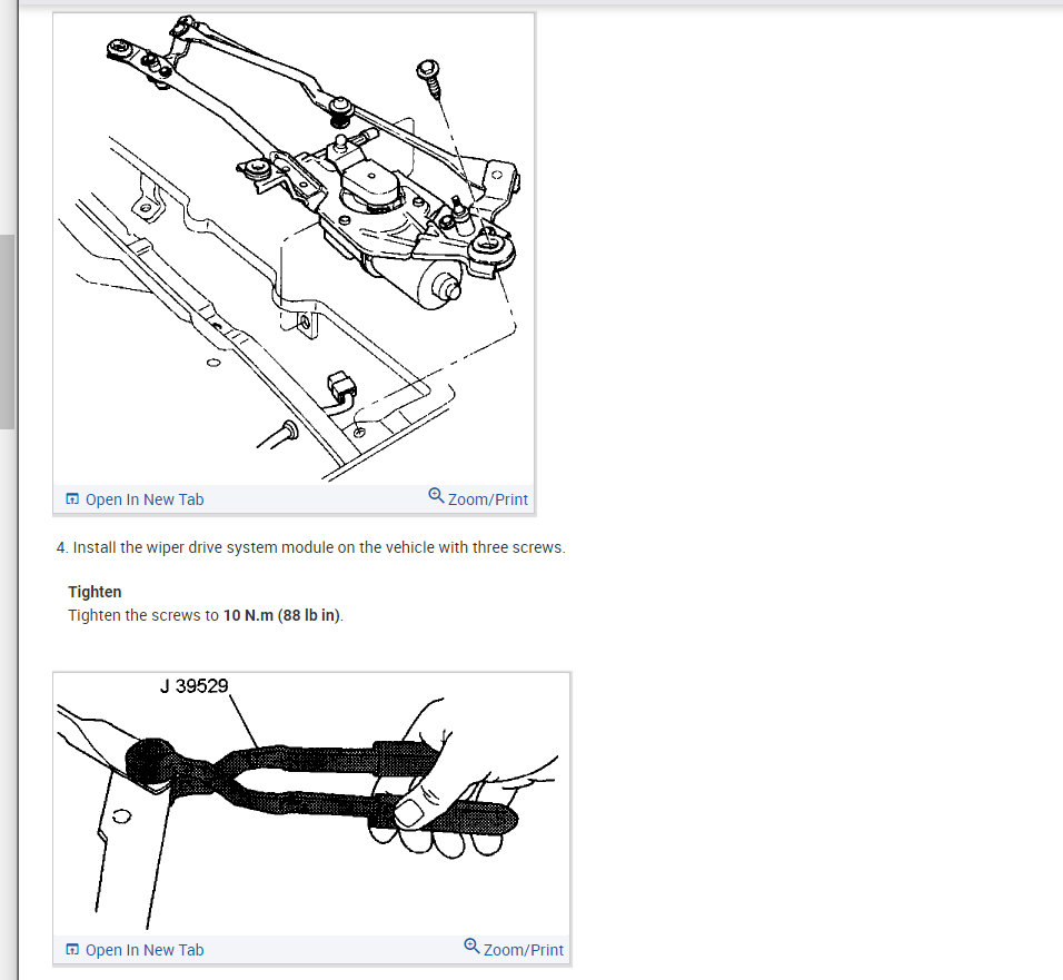

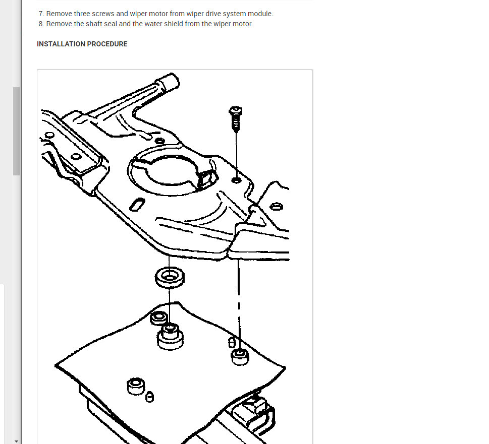

If this started after this was replaced, then the most likely cause is it was not installed in the correct position. Meaning when it was hooked up the arms were put on in a different position. However, the fact that it doesn't respond properly from the switch, I suspect the motor is faulty.
We can do a test at the motor at each wire and see what the voltage is from the switch to make sure that is not the issue but again, the way this is working points directly to the wiper control module which is part of the wiper.
I am attaching the wiring diagram, but I suspect you are going to have to replace the motor again.
Please run through this and let me know if you have questions.
