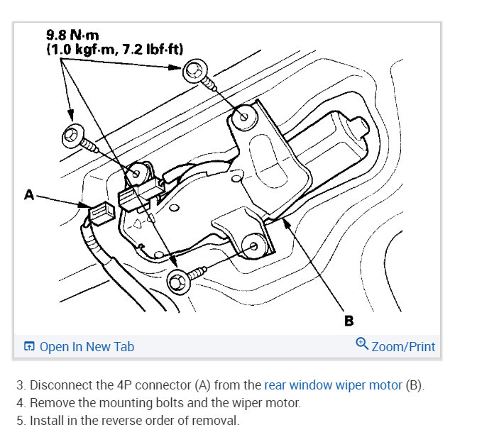

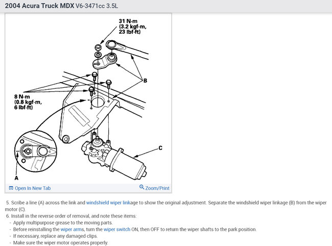

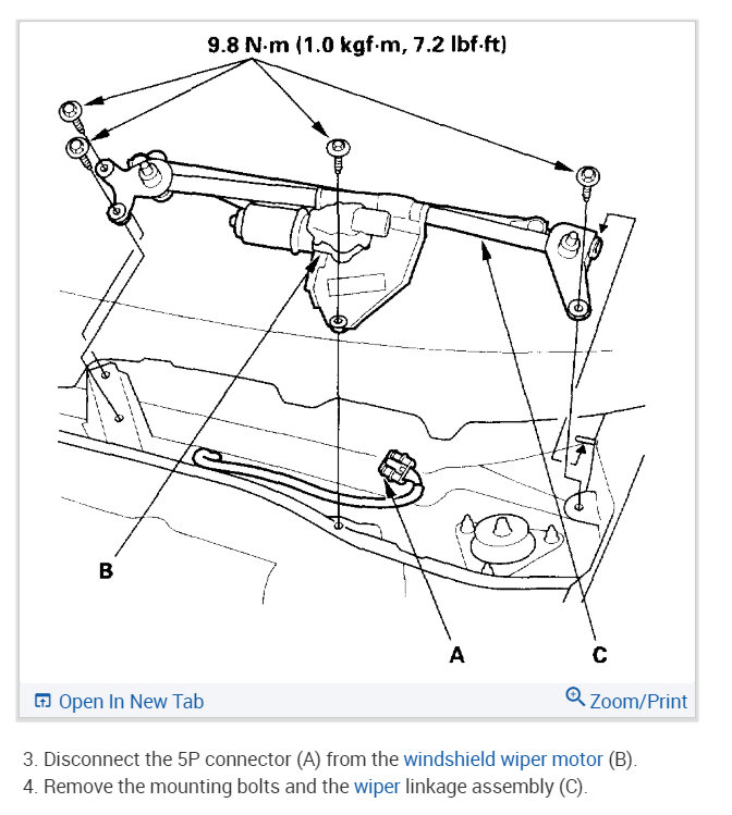

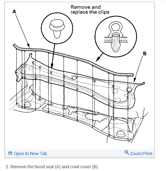

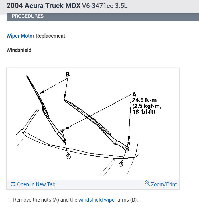

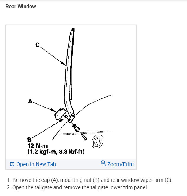

The auto park is built into the wiper motor itself. here is how you would replace it in the diagrams below. Here is the wiper motor on Amazon for $97.00:
