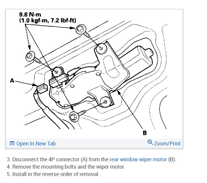

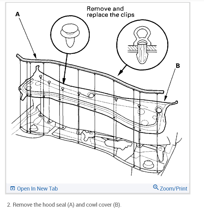

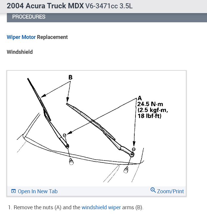

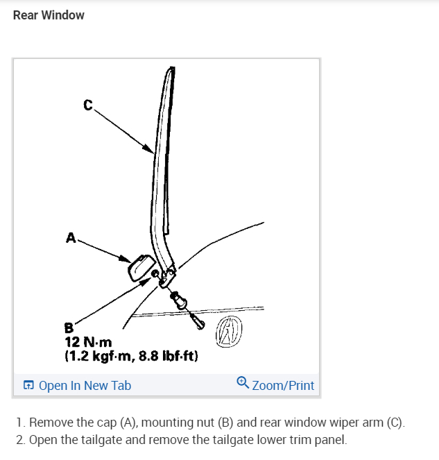

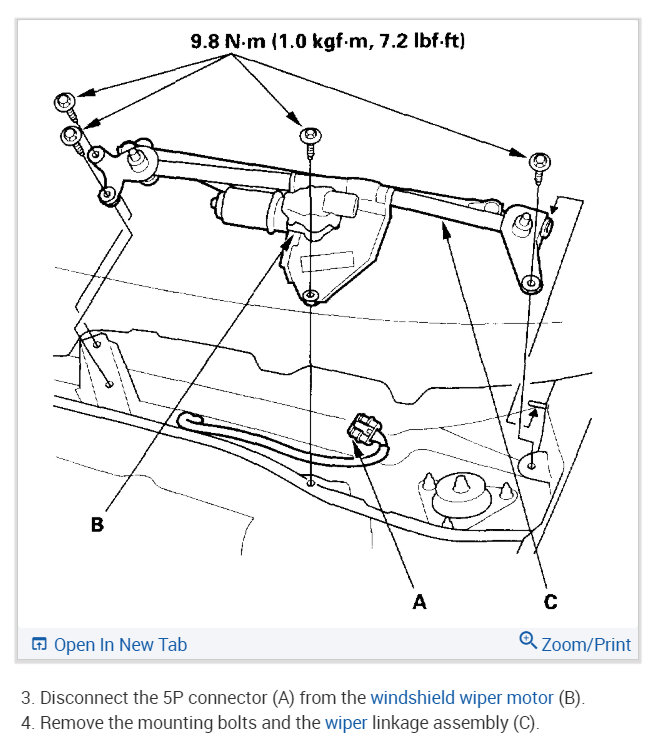

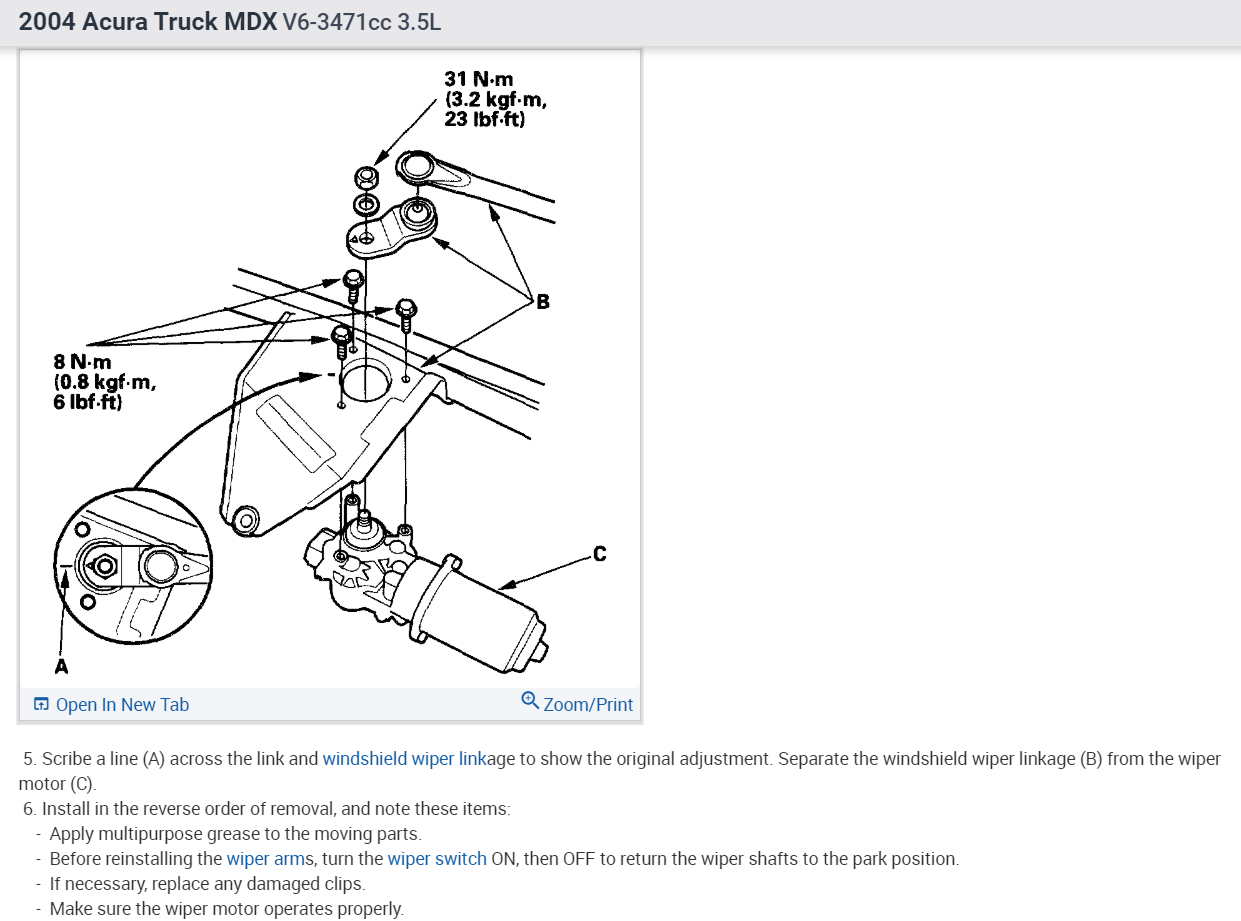

I see that the previous scenario on it stated there were two relays for it. I found the one in the front of the engine compartment next to the washer fluid, but cannot find the other. any ideas?
Jan 26, 2020 at 4:04 AM
  • 55,433 POSTS
The auto park is built into the wiper motor itself. here is how you would replace it in the diagrams below. Here is the wiper motor on Amazon for $97.00:

Thank you.. will order the motor today.
