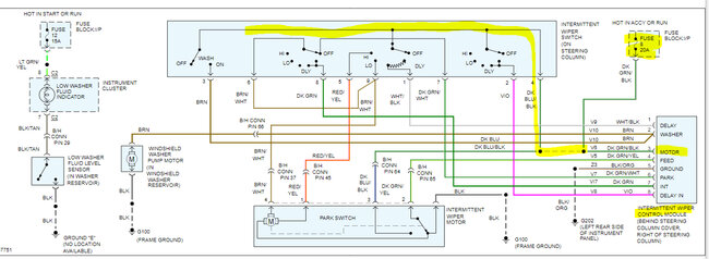

where is the relay location, in the engine or steering column.

The vehicle doesn't have a wiper relay. For both low and high speeds, power is direct from the switch. The delay function is controlled by the intermittent wiper control module.
I attached the wiring schematic below so that you have a reference. Let me know what is happening.
See pic below.
