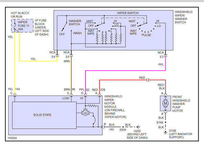

My wipers were getting stuck, so I did a little research and found out that it may be my "wiper pulse module". So I recently replaced it, and now I have no wipers at all.
Could it be that just my wiper motor went out?

It sounds like you lost power or the wiper motor went out. Here is a guide to help you check for power to confirm the failure and the wiper wiring diagram so you can see how then system works:
Check out the diagrams (below). Please let us know what you find.
