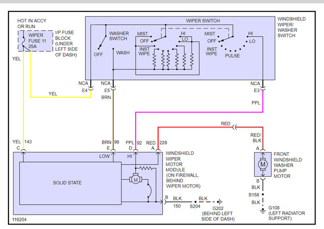

My wipers were getting stuck, so I did a little research and found out that it may be my "wiper pulse module". So I recently replaced it, and now I have no wipers at all.
Could it be that just my wiper motor went out?
Aug 12, 2018 at 6:29 PM
  • 54,832 POSTS

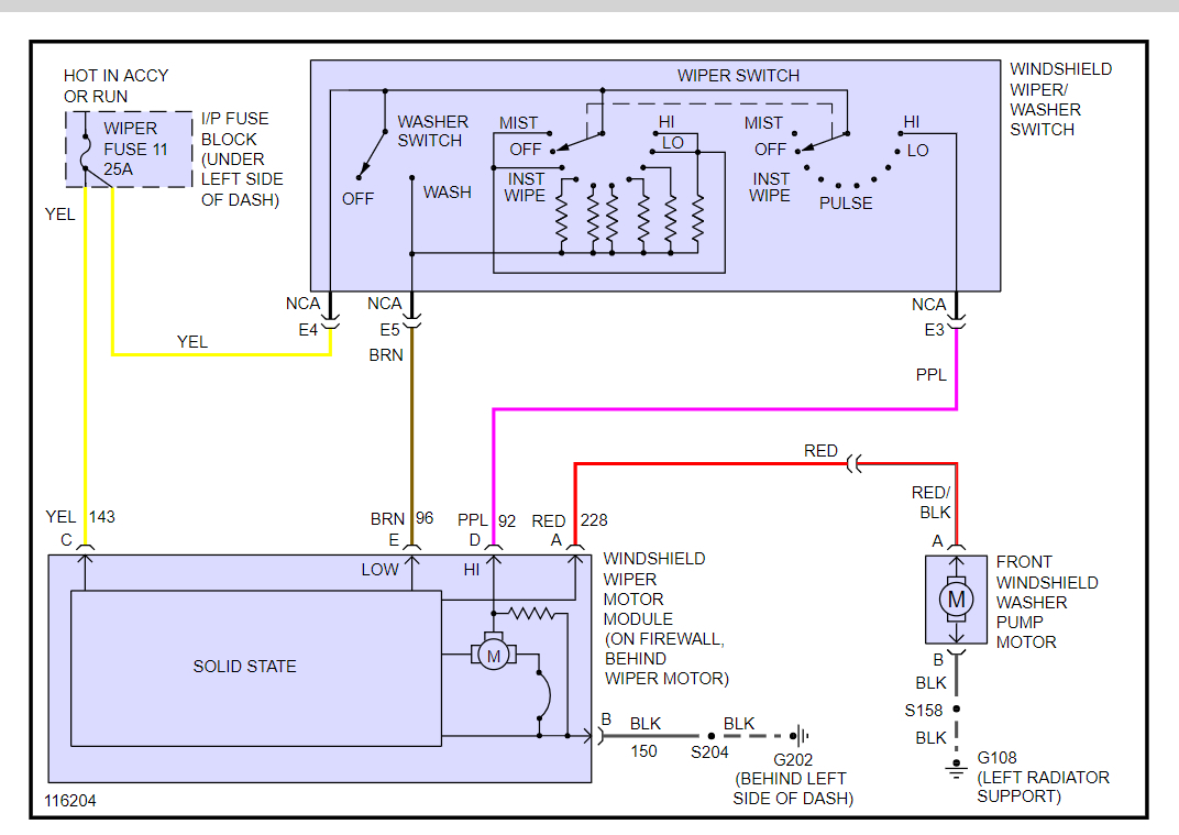

It sounds like you lost power or the wiper motor went out. Here is a guide to help you check for power to confirm the failure and the wiper wiring diagram so you can see how then system works:
Check out the diagrams (below). Please let us know what you find.
