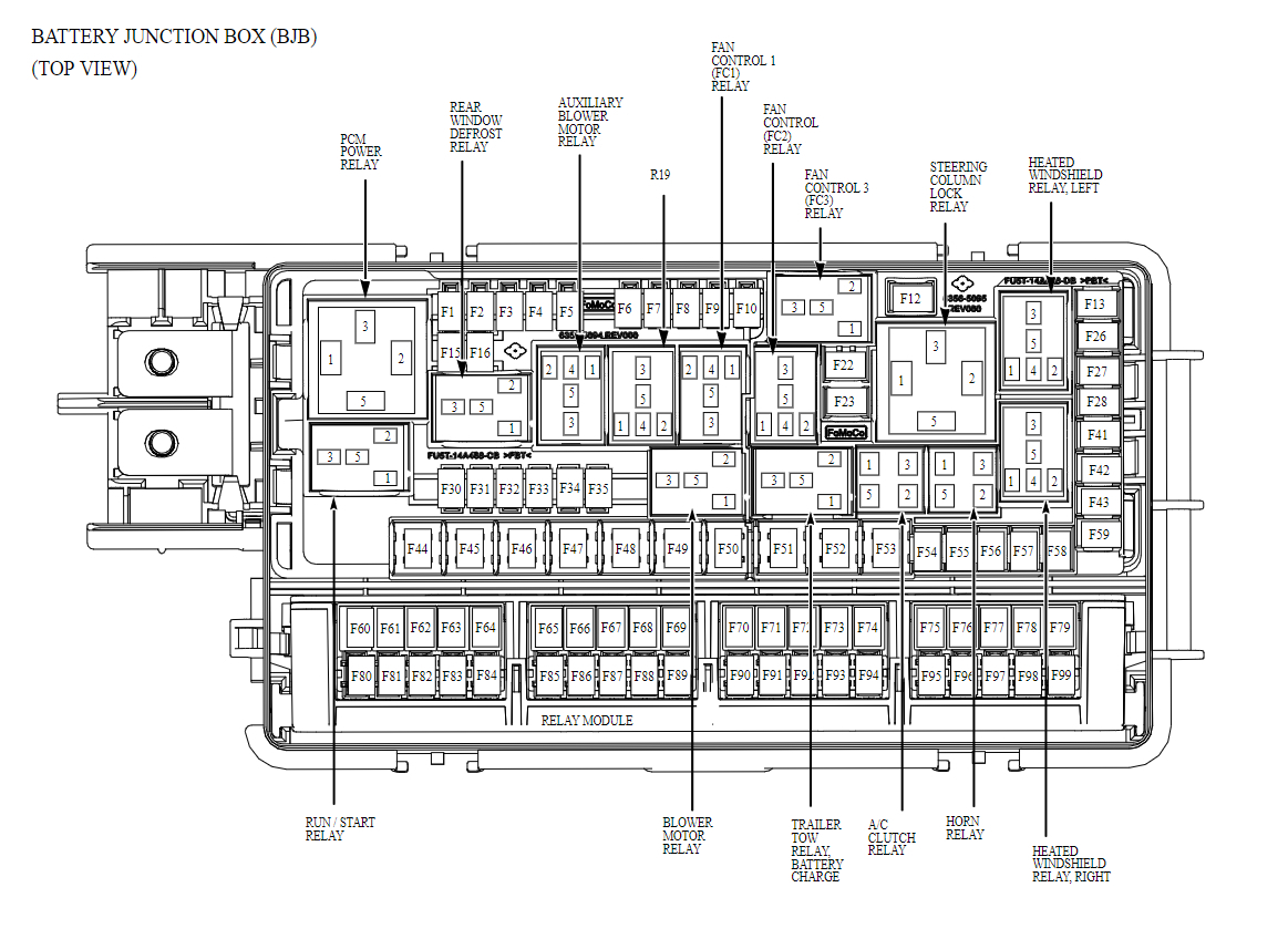

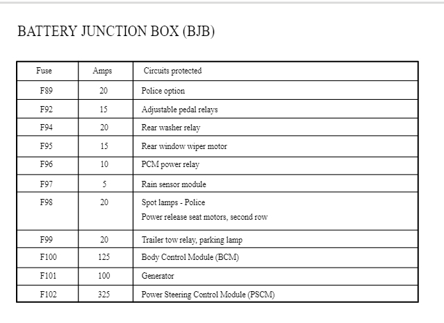

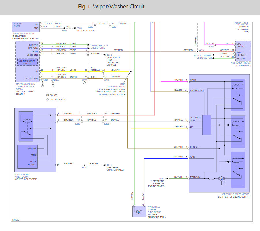

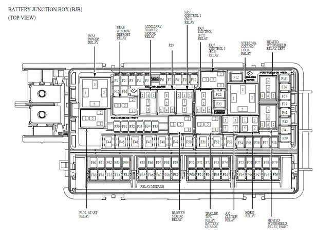

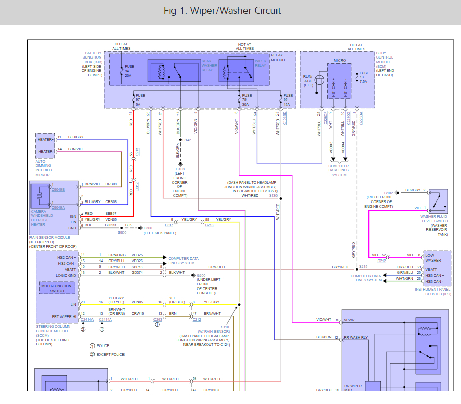

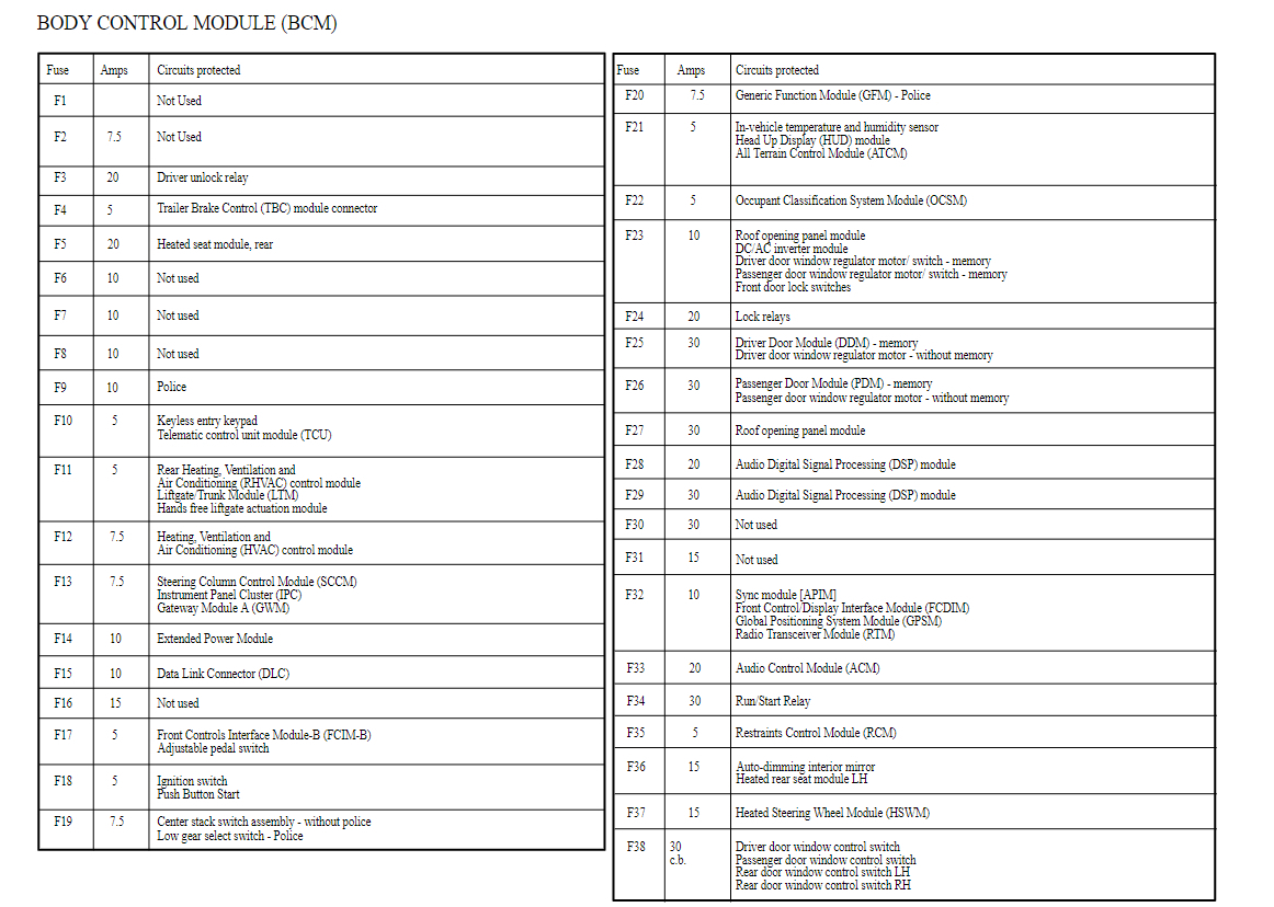

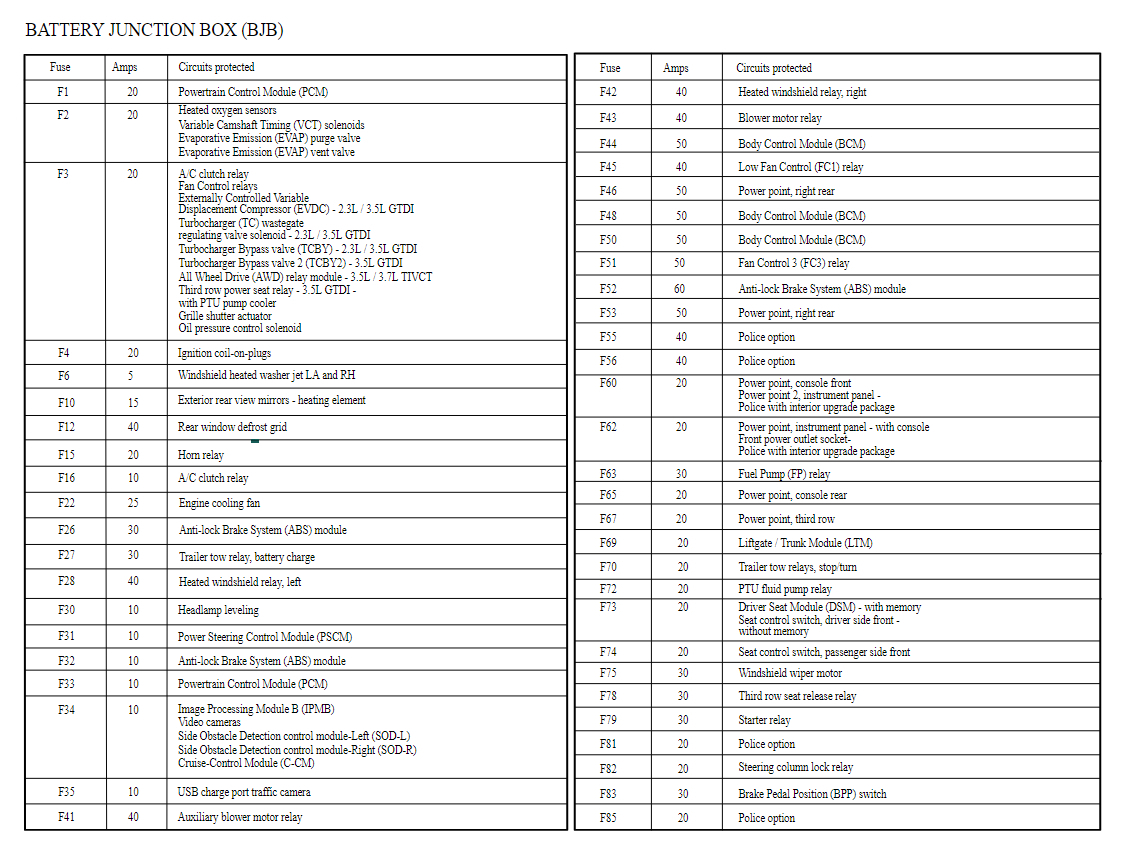

The front wiper's slow and intermittent speeds are not working
2018 FORD EXPLORER
87,000 MILES • 6 CYL • 4WD • AUTOMATIC
CHINNAK
Only the high-speed working. I need to know, how to check wiring circuit and relay location.
Jul 4, 2022 at 11:12 PM
  • 54,832 POSTS

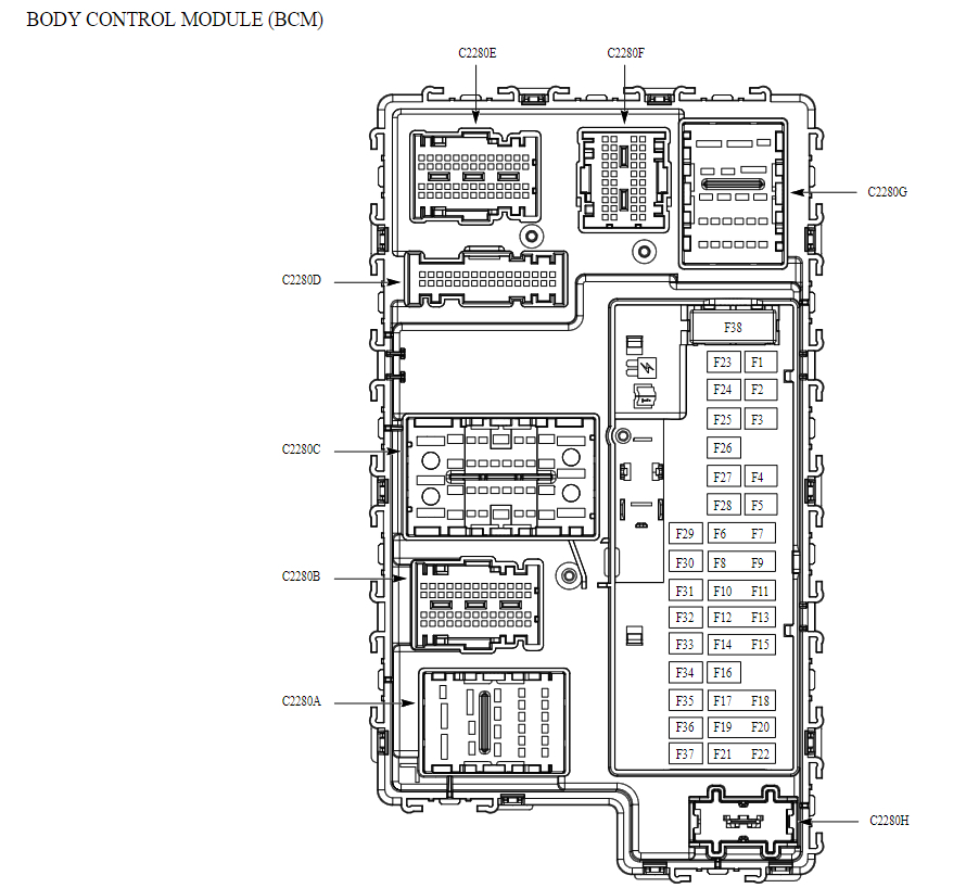

There are five fuses that run the system I would check those first (94, 95, 96, 37 and 13 on the inside fuse panel), here is a guide to help and the fuse locations, I have also included the wiper wiring diagrams so you can see how the system works.
