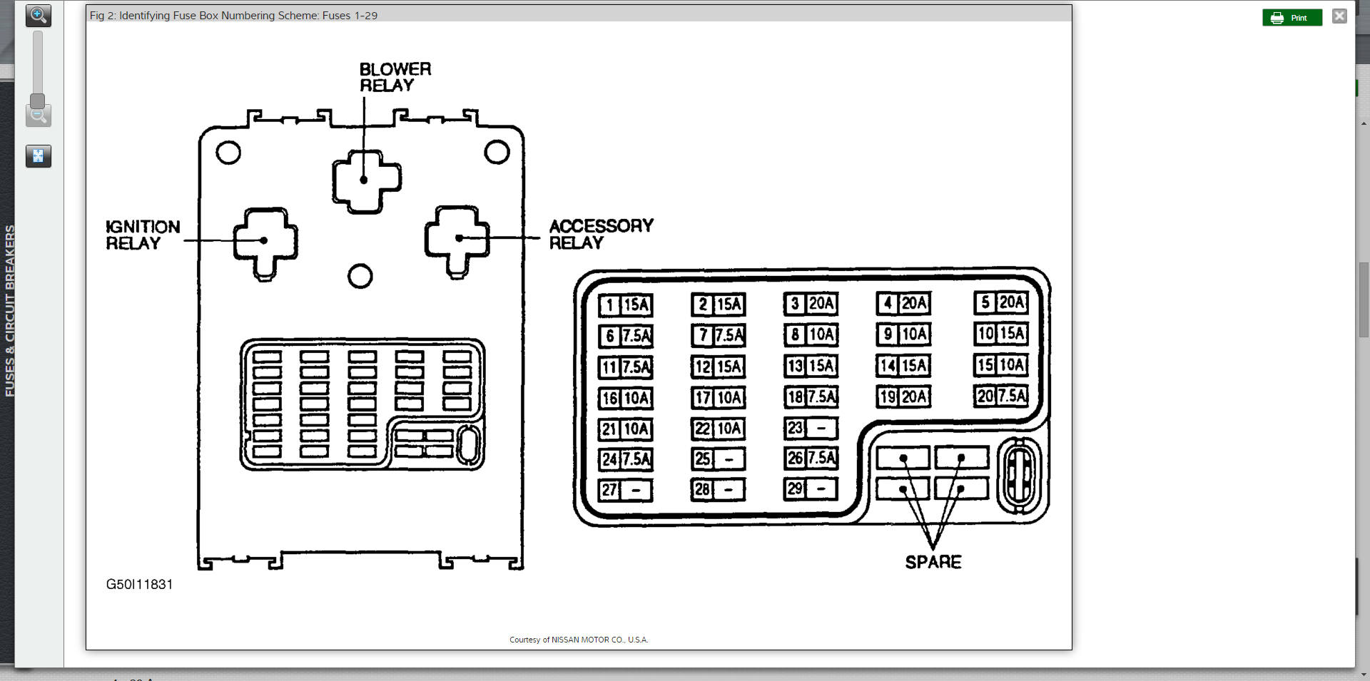

The wipers are no't working, I was wondering if anyone had a copy of a 1997 Nissan Sentra fuse cover so I can see where the fuses go? Thanks

Fuse 19 20amp

Now the wiper blades will not turn off. Any suggestions as to what is causing this?

I sugges you start at the wiper switch.

Nice reply CATAFINA I want to add the wiper motor has a internal park switch that can fail causing the problem you are describing. If the switch checks out the wiper motor will need to be replaced, Please get back to us.
