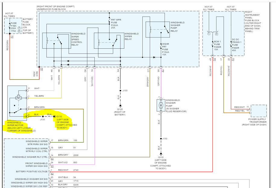

The wiper motor is not running. I have replaced the motor, checked fuses, switch seems to be working when checking for power at the wiper motor plug.
Sep 15, 2023 at 5:05 AM
  • 110,246 POSTS
If I understand correctly, you are getting power to the motor, but it won't run. Is that correct? If so, either we have a faulty ground or the motor is no good. However, I realize you have replaced it already.

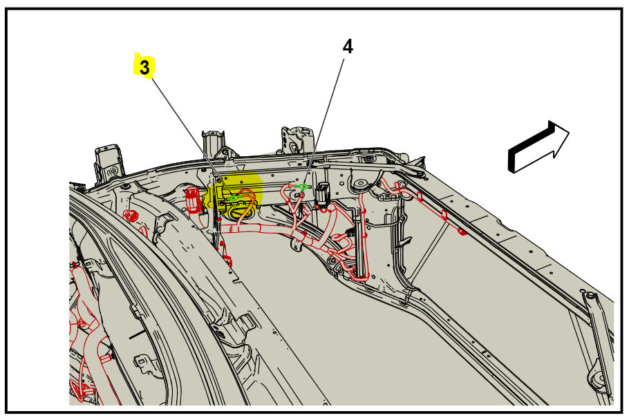

If you look below, I attached the wiring schematic for the circuit so that you have a reference. I highlighted the ground for the wiper motor. The ground, G110, is attached to the body of the vehicle on the driver's side of the engine compartment. See pic 3
If you disconnect the connector at the motor, check to see if there is continuity to ground via the black wire.

So the ground is good. I did notice that I always have 12 VDC on the brown green park wire, even with the vehicle off.
