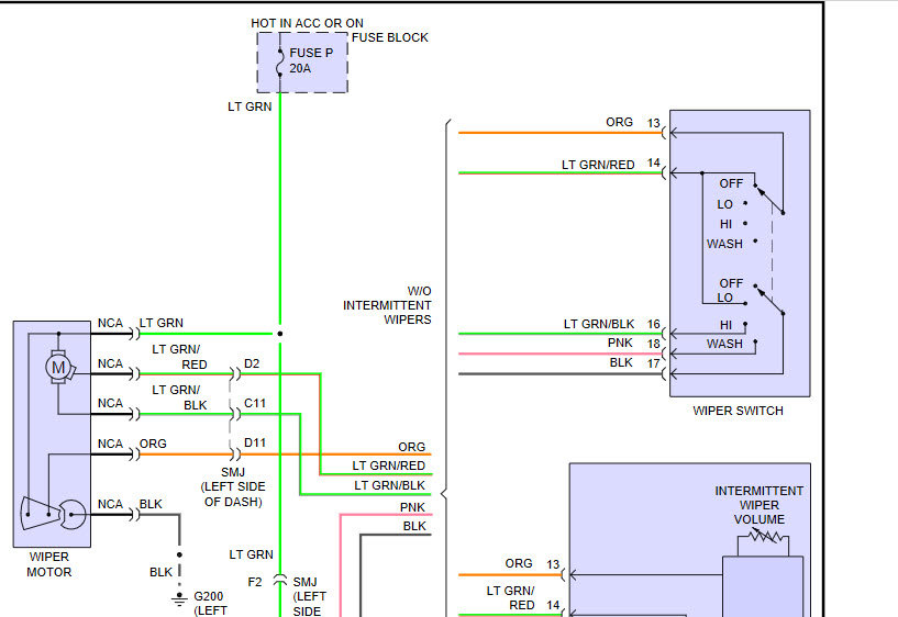

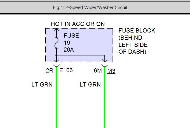

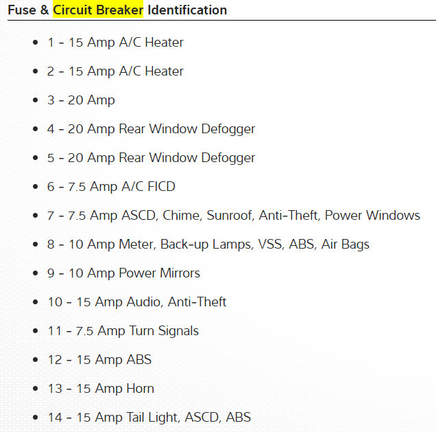

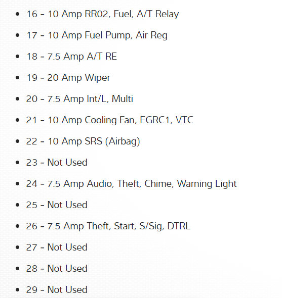

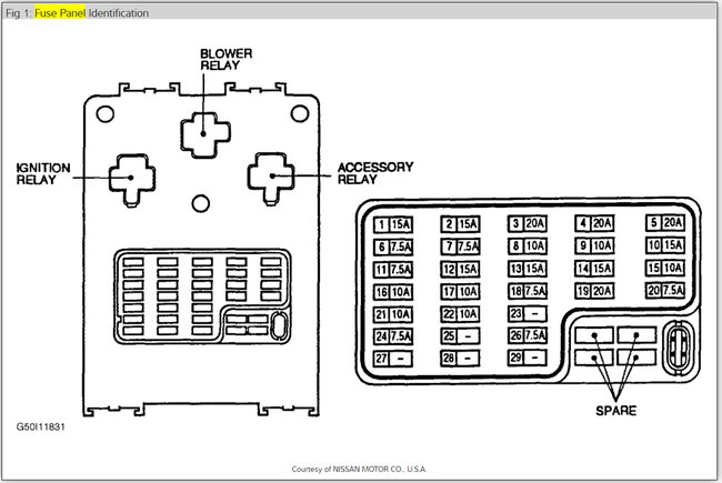

The windshield wiper motor went out on this car a week ago. It made an awful noise and the wipers moved very unevenly across the windshield. It quit all together the second time I went to check it - likely blown fuse or something. I tried to gentle work the wipers but they would not move at all. I pull the motor and checked the linkage. Linkage was fine. I replaced the motor, but I do not know where the fuse is for the wipers, or it their is a relay that could impact the wipers. Nissan is very bad about making information available to fix this stuff. I can figure it out, but if I knew which fuses and relays controlled the thing, it would make life easier. Can you identify fuses and relays that control power to the wiper motor? It has no power right now.
Apr 12, 2015 at 4:58 AM
JDL
  • 16,098 POSTS
Is fuse #19 in the fuse panel here is guide to help you test the fuse and the fuse location as well in the diagrams below.

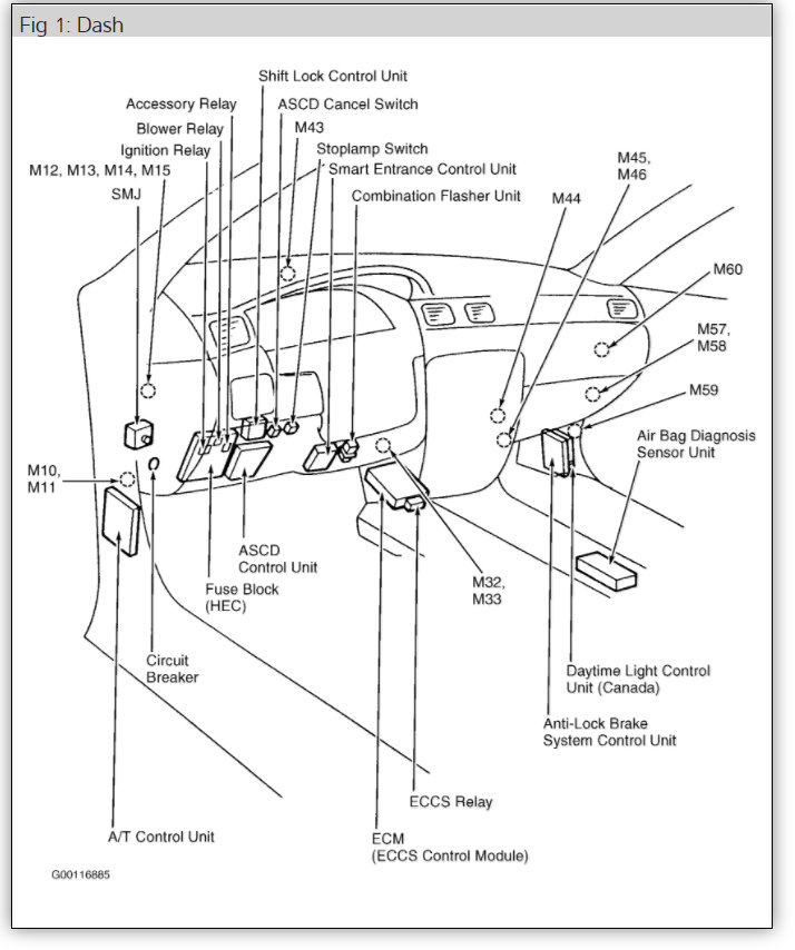

1993 Nissan Sentra 4 cyl Front Wheel Drive Automatic
My vehicle is equiped with the standard off/low/high wiper switch. I would like to convert it to a switch that has a delay option. I think I need to change a relay and buy an alternate wiper switch but I am not sure if this can be done. I am requesting help to identify which relay I would have to replace (as well as what to replace it with) and if there is a delayed wiper switch for my year vehicle. I cant seem to find one online at the autostores. If there is not, can I use an aftermarket switch, and do you have any recommendations.
Thanks for taking your time to help.
Dan
Oct 2, 2018 at 5:32 AM (Merged)
ZACKMAN
  • 4,202 POSTS
It can be done, but it is a long and timely process. You will need to start with a multi function switch out of another Sentra with delay option. You will also need the wiper amplifier (high power relay). I am not sure where the location for B13, but for B14, it is located in the passenger side kick panel. Your vehicle should have the wiring harness for it, except no relay.

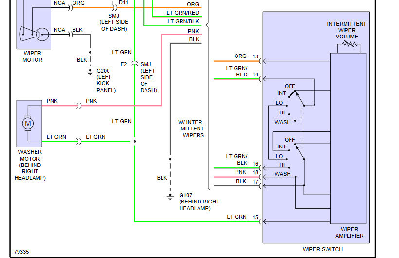

BILBO1947
While working on my son's car I grounded the positive side of battery to something in the car. Now the windshield wipers will not shut off and there is a short somewhere. Is it possible I shorted off the relay and if so is it located next to fuses in car on drivers side? There was something down there that got pretty hot. Could that be problem and if so how to get to it. I can see it but not see how to get out. Thank you.
HMAC300
  • 48,601 POSTS
doing what you did happens a lot if you ever want to disconnect battery always do the negative side first. You could have burnt anything up . there is a fuse for this but no relay so best to check this it may be a switch or amplifier in switch. See pictures check grounds in pictures as well. the switch grounds the motor to work.
