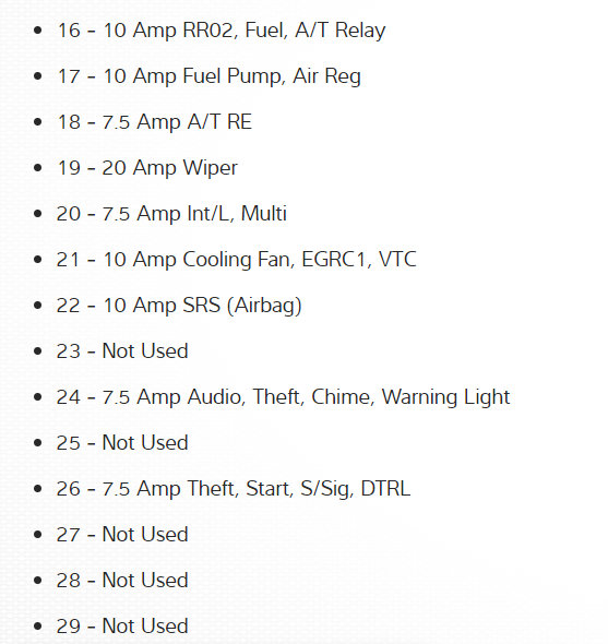

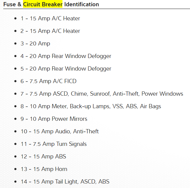

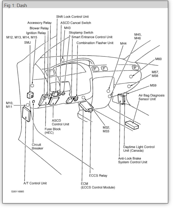

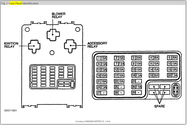

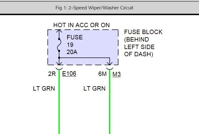

The windshield wiper motor went out on this car a week ago. It made an awful noise and the wipers moved very unevenly across the windshield. It quit all together the second time I went to check it - likely blown fuse or something. I tried to gentle work the wipers but they would not move at all. I pull the motor and checked the linkage. Linkage was fine. I replaced the motor, but I do not know where the fuse is for the wipers, or it their is a relay that could impact the wipers. Nissan is very bad about making information available to fix this stuff. I can figure it out, but if I knew which fuses and relays controlled the thing, it would make life easier. Can you identify fuses and relays that control power to the wiper motor? It has no power right now.
Apr 12, 2015 at 4:58 AM
JDL
  • 16,098 POSTS
Is fuse #19 in the fuse panel here is guide to help you test the fuse and the fuse location as well in the diagrams below.

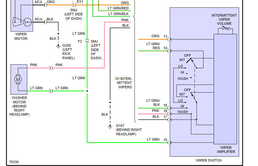

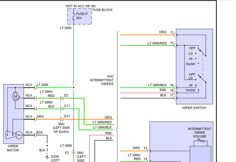

While working on my son's car I grounded the positive side of battery to something in the car. Now the windshield wipers will not shut off and there is a short somewhere. Is it possible I shorted off the relay and if so is it located next to fuses in car on drivers side? There was something down there that got pretty hot. Could that be problem and if so how to get to it. I can see it but not see how to get out. Thank you.
Oct 2, 2018 at 5:32 AM (Merged)
HMAC300
  • 48,601 POSTS
doing what you did happens a lot if you ever want to disconnect battery always do the negative side first. You could have burnt anything up . there is a fuse for this but no relay so best to check this it may be a switch or amplifier in switch. See pictures check grounds in pictures as well. the switch grounds the motor to work.
