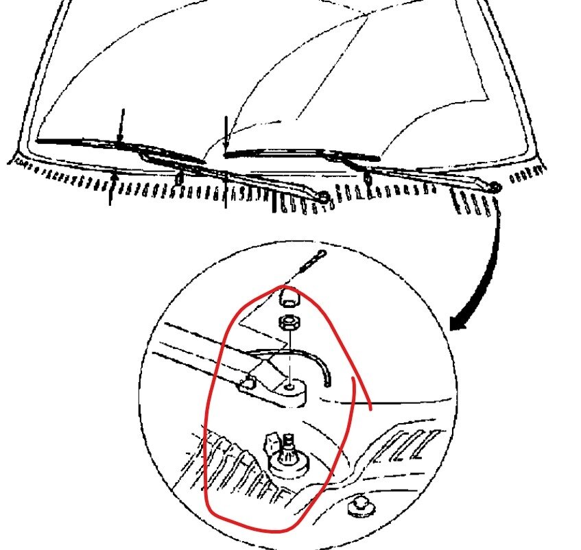

the little wiper hose or wire that's connected to the wiper arm is no longer connected to the arm itself and now that wipers not working how do I fix it or do I just replace the wiper arm itself while I'm also changing the wiper blades as well
Jan 2, 2026 at 9:11 PM
STEVE W.
  • 15,296 POSTS
The hose is the washer line, it shouldn't stop the arm from working though, it would only prevent the washer fluid from spraying. The line connects to a small hose barb that is near the wiper arm base, if the hose itself broke you can buy generic hose at many parts stores that works. If it is the barb that failed it is a bit harder as you need to remove the cowl trim to get to it. Now if the hose failed and the wiper doesn't move when you switch it on that could be a failed arm or a bad wiper transmission. Think you could shoot a few pictures or a video to show the problem and post it? That would make it far easier to tell which parts are the problem.

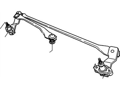

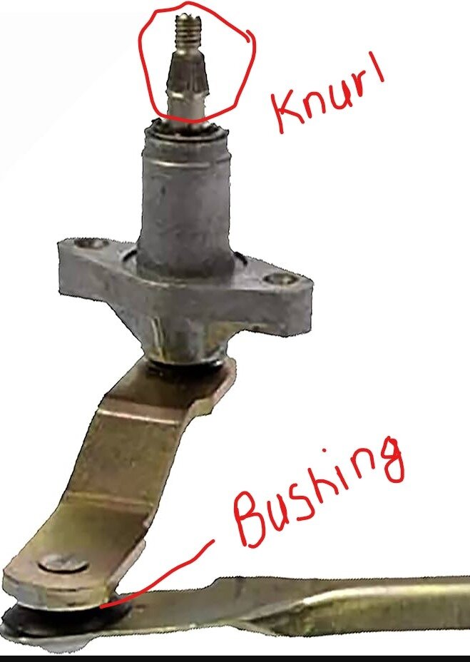

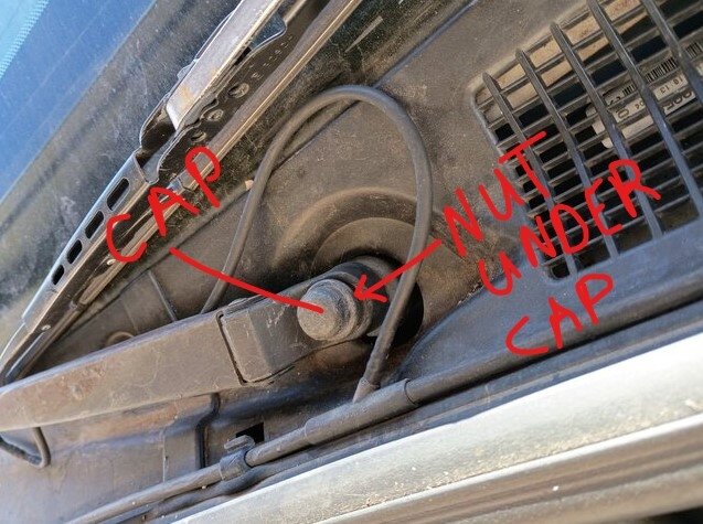

The issue could be that the arm is loose on the wiper transmission shaft, There is a shaft that comes out of the cowl that the arm bolts onto, the end of it is tapered and has a knurl on it. The nut is tightened at the factory so the metal of the arm is pressed into the knurl and locked in place. Over time the metal of the arm shears off and then it no longer moves with the shaft. On that system it should be easy to tell if this is the problem, the trim cap and nut on the arm will move with the wipers on but the arm doesn't move. The repair in that case is to remove the trim cap, then the nut. Lift the arm off. Now use a pick or similar to remove the sheared metal from the knurling. Then once clean you put the arm back on and line it up in the parked position and use a socket and hammer to hit the arm so it forms a new spline area, then put the nut back on and torque it to 22 ft. lb. Then test. Now if the nut and shaft are not moving then you will need to remove the arms and the cowl trim to get to the wiper transmission and determine if the drive arm popped off on one end from a bad bushing or if it's otherwise damaged. If it's a bad bushing you can sometimes get replacements at a parts store in the HELP line of parts or ask at the counter. They snap into the metal arms and are snapped onto the drive studs. Sometimes it is easier to just replace the transmission assembly (GM 12336025) than it is to fight with the bushings.

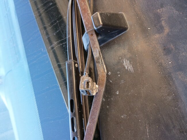

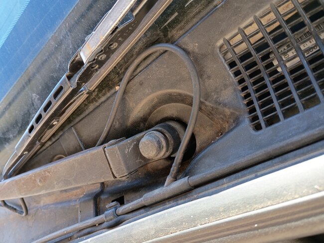

ok so the driver's side works the passenger side tho won't lift at all but I can see where it's trying to rotate at the bolt where it's attached to the cowl (pic #1) but I'm guessing it's the fluid hose clamps broken(pic #2)the ds wiper arm sits firm in place but the ps wiper arm can move and lift with ease your thoughts please

Then the right side is the one to pull the cap off and remove the nut and clean it up and put it back on and see if it at least wipes. The washer nozzles come on a new arm. I don't believe they are available as a repair part on that design. So I would try to tighten it and at least have a wiper while you wait for the parts.
