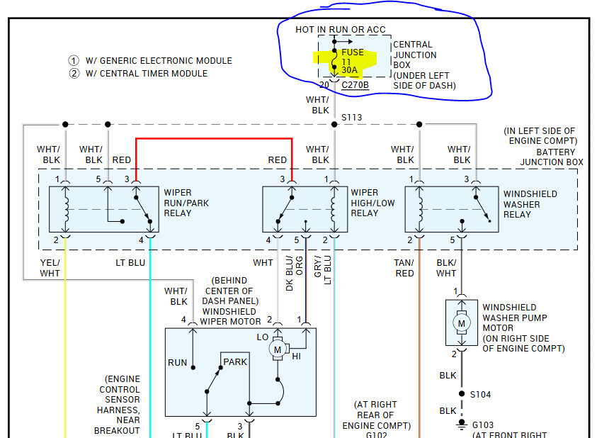

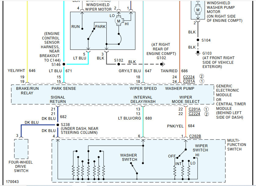

The windshield washer and wipers have stopped working.
Aug 17, 2025 at 2:46 PM
  • 110,194 POSTS
Hi:
I attached the wiring schematic below for you. If you lost both the washer and wiper functions at the same time, it is likely a fuse.
The fuse to check first is fuse 11 in the central junction box under the left side of the dash. Confirm there is power to and from it, and let me know what you find. Here is a link you may find helpful.
Let us know what you find.
