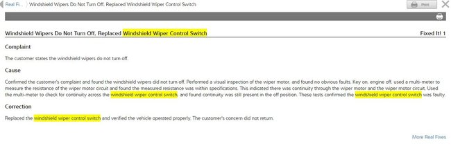

Windshield wipers will not turn off
148,000 MILES • 3.3L • 6 CYL • 2WD • AUTOMATIC
JAYMAR85
Wipers continue to go until you take the fuse out.
Jul 14, 2018 at 5:03 AM
  • 110,248 POSTS
I did a little research on your issue and found that the most common problem is the switch itself. I attached a picture which is from Mitchel service manuals online which indicates the same issue and how they fixed it.
Take a look at it and let me know your thoughts.
