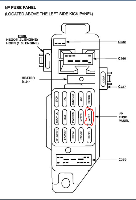

Windshield wipers will not stop even when engine is off
1994 FORD ESCORT
135,000 MILES • V6 • AUTOMATIC
YOLANDE LEVASSEUR
This issue is draining the battery. Can I just pull the fuse and if so where is it?
Jun 1, 2019 at 10:26 AM
DANNY L
  • 5,648 POSTS
Hello, I'm Danny.
I've attached a photo below of the fuse block.It's located above the left side kick panel. I've circled the wiper fuse in red.We can also help you try to fix the problem.Hope this helps and thanks for using 2CarPros.
