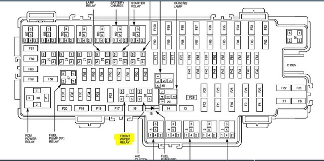

windshield wipers are stuck on high and will not shut off
2011 FORD F-250
175,000 MILES • 6.7L • 4WD • AUTOMATIC
DSTEPP84
I changed out the multi-switch and that didn't fix the problem.
Jun 26, 2019 at 7:23 PM
  • 110,244 POSTS
Welcome to 2CarPros.

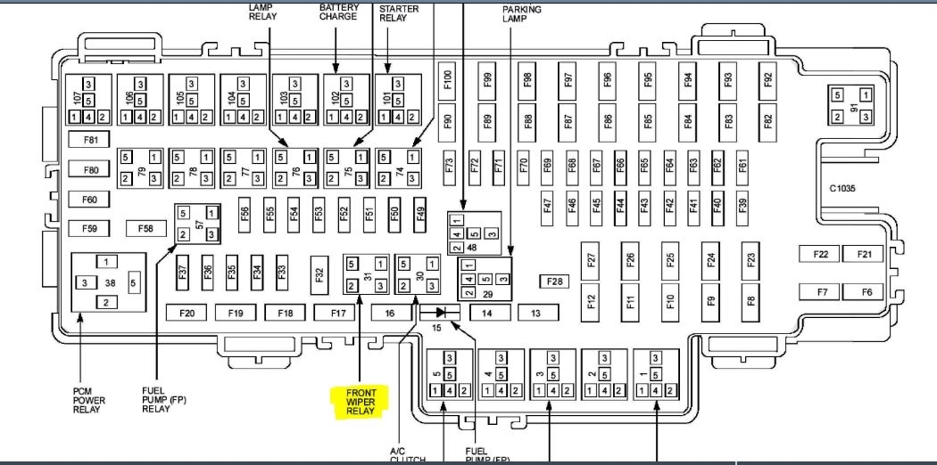

The first thing I need you to do is remove the wiper relay and see if they still stay running. If they do, then we have a short to power between the switch and motor (brown/white) wire at motor. If the relay stops the problem, check the relay. Picture 1 shows the relay I am referring to and picture 2 shows its location. I highlighted each. Here is a link that explains how to check a relay:
I Let me know what you find.
