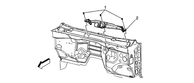

The windshield wipers abruptly stopped working. I checked the fuse and it is good. Could this be anything other than a bad motor? How do I get to the motor to replace it?
Aug 18, 2018 at 7:14 AM
  • 110,244 POSTS

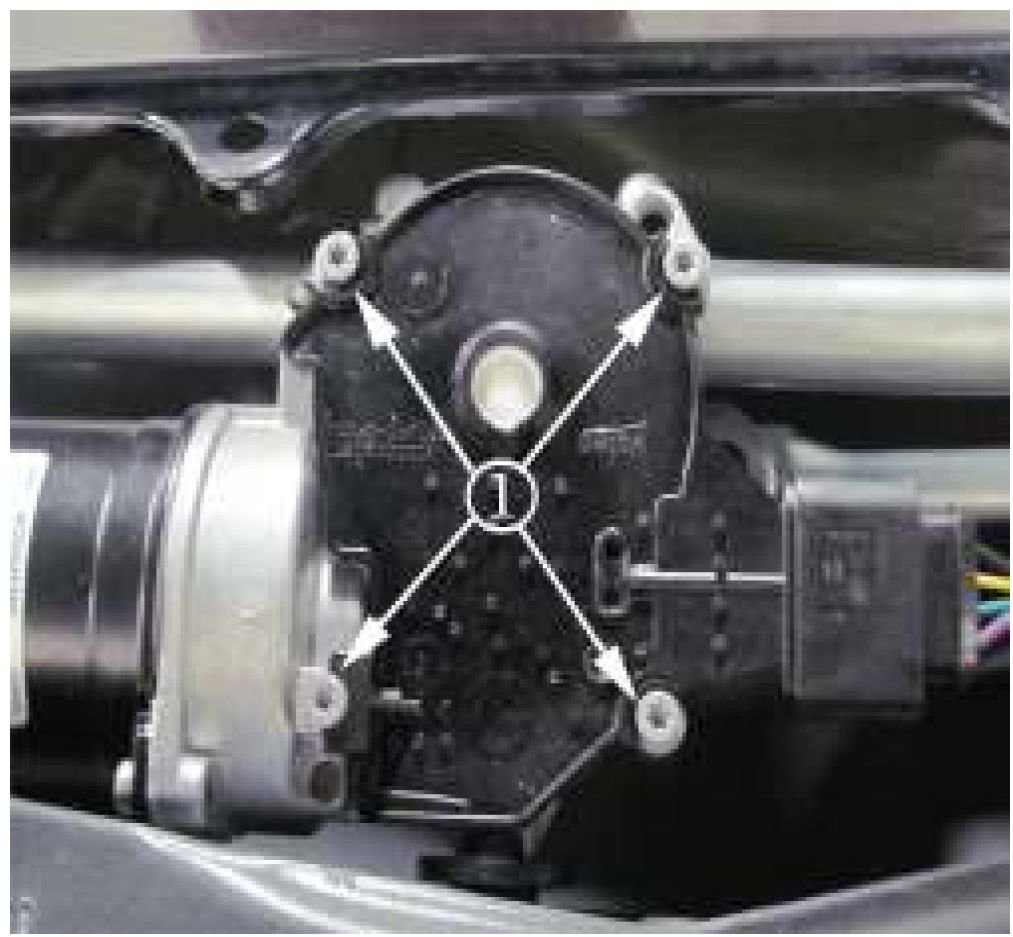

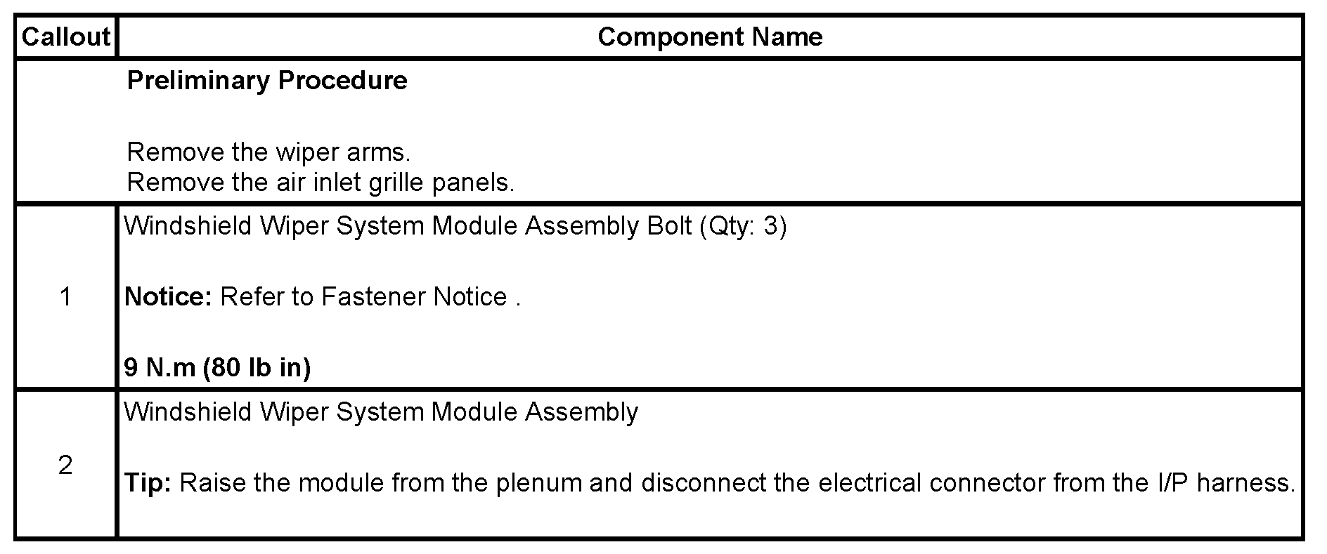

First, if the motor was ever replaced, it may fall under a recall. Take a look through this. The pictures I attach will show where the motor is located and give general directions for removal. It is located at the bottom of the windshield (exterior) and requires removal of the cowl to access.
To answer your other question, there are other things that may have failed. I would recommend checking to see if there is power to the motor and a good ground. If there is power and ground, the motor is bad. Here are a couple links that show how to check wiring and use a test light:

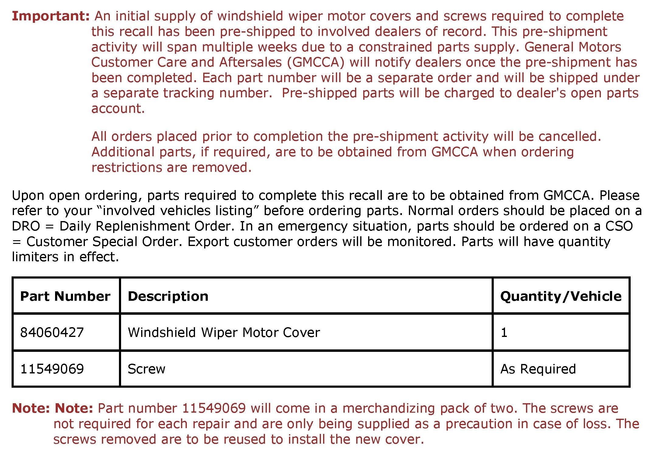

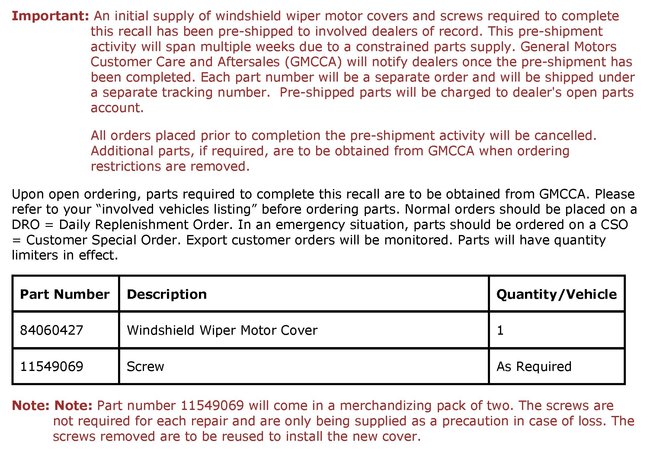

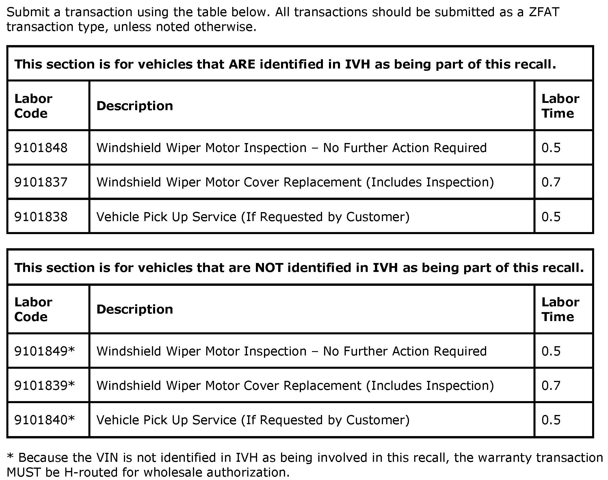

Here is the recall. It may or may not relate to your vehicle. You will need a dealer to run your vehicle identification number (VIN) and then inspect the motor. This is extensive and the pictures starting with number 3 correlate to the recall.
_________________________________________
Recall - Windshield Wiper Motor Failure
Vehicle Wiper and Washer Systems Windshield Washer Motor Technical Service Bulletins Recall - Windshield Wiper Motor Failure
RECALL - WINDSHIELD WIPER MOTOR FAILURE
# 15789: Service Parts Safety - Windshield Wiper Motor Failure - (Oct 26, 2015)
Subject: 15789 - Windshield Wiper Motor Failure Models: Various Serviced Vehicles and Over-The-Counter Part Sales
The windshield wiper motors involved in this recall were used by GM dealers to repair various serviced vehicles. Dealers who ordered this part for service or over-the-counter sale are identified in the file attached to the GM GlobalConnect message (U.S.) or Dealer Communication (Canada). Please see the Vehicles Involved section of this bulletin for details.

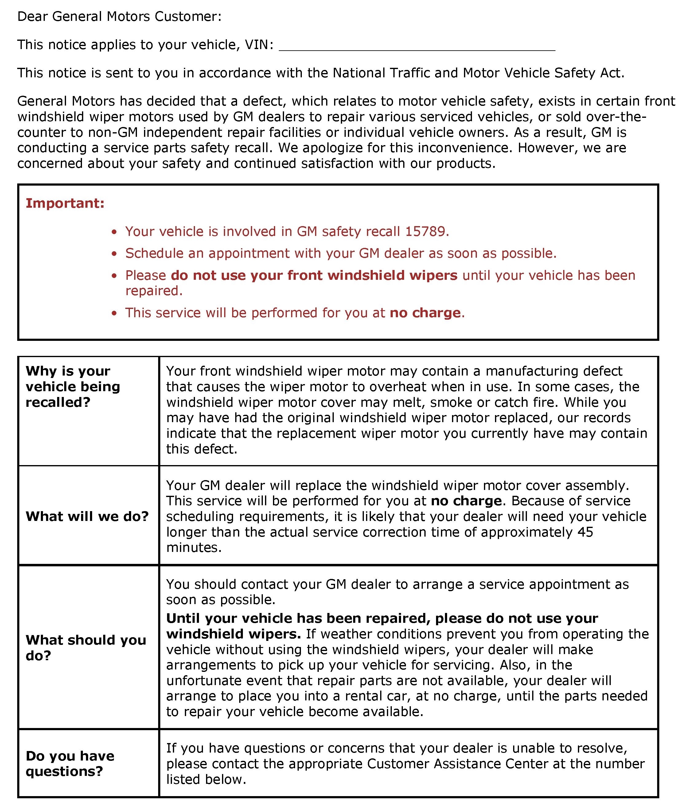

General Motors has decided that a defect which relates to motor vehicle safety exists in certain front windshield wiper motors used by GM dealers to repair various serviced vehicles or sold over-the-counter to non-GM independent repair facilities or individual vehicle owners. These front windshield wiper motors may contain a manufacturing defect that causes the wiper motor to overheat when in use. In some cases, the windshield wiper motor cover may melt, smoke or catch fire.
Important: In the sample customer notification letter on the last page of this bulletin, customers are being advised to contact their dealer to arrange a service appointment as soon as possible and not use their windshield wipers until they have been repaired. Customers are also being advised that if weather conditions prevent them from operating the vehicle without using the windshield wipers, their dealer will make arrangements to pick up the vehicle for servicing. Additionally, in the unfortunate event that repair parts are not available, customers are being advised that their dealer will arrange to place them into a rental car, at no charge, until the parts needed to repair their vehicle become available.
Correction
Dealers are to inspect the windshield wiper motor build date, and if necessary, replace the windshield wiper motor cover. This service will be performed at no charge to the customer.

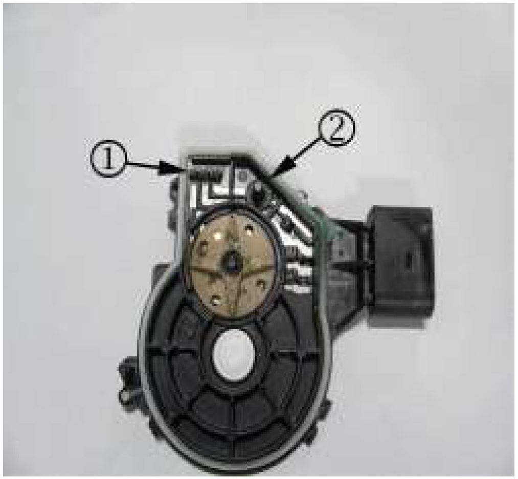

1.Remove the air inlet grille panel. Refer to Air Inlet Grille Panel Replacement in SI.
Note: The date formatting is DD-MM-YY.

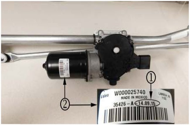

2.Verify the build date (1) printed on the label (2) of the wiper motor.
^ If the build date is between 15-08-15 and 18-09-15, proceed to step 3.
^ If the build date is NOT between 15-08-15 and 18-09-15, no further action is required. Reattach the air inlet grille panel.
3.Disconnect the wiper motor electrical connection.
4.If required, remove dirt, debris or moisture from the wiper motor cover.
5.Remove the 4 wiper motor cover fasteners (1).
6.Remove the wiper motor cover.

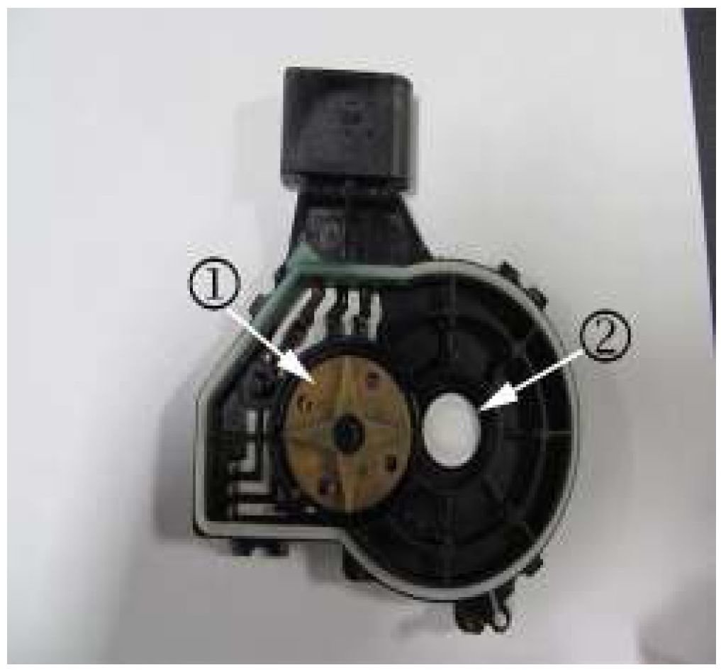

Caution: Damage may occur to the part if the sprocket is not aligned properly.
7.On the new wiper cover, align the sprocket (1) with the breather (2) as shown in the picture above.

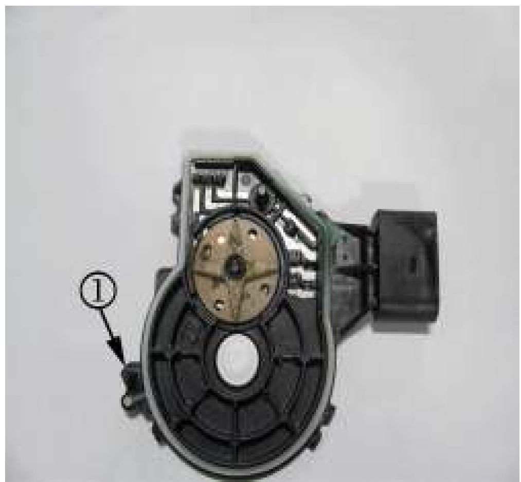

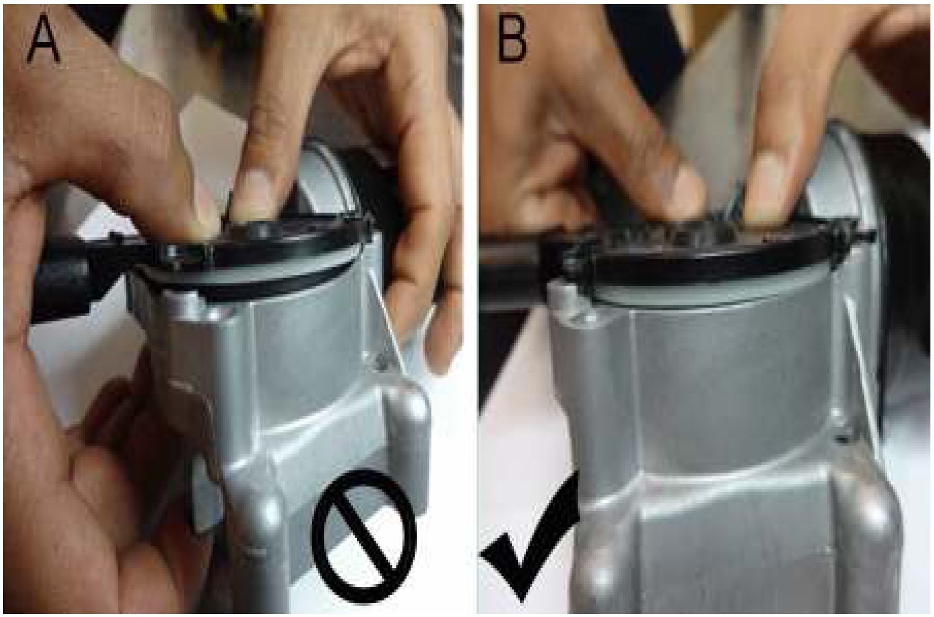

8.Install the new cover onto the motor starting with the terminals (1) and pin A (2).
9.Push down carefully on the cover to align pin B (1).
10.Verify the cover lays flat on the motor assembly as shown in picture B.
11.Tighten the 4 wiper motor fasteners (1) in a "X" pattern to 3.5 Nm (31 in lb). Verify the fasteners are bottomed out on the wiper motor casting.
