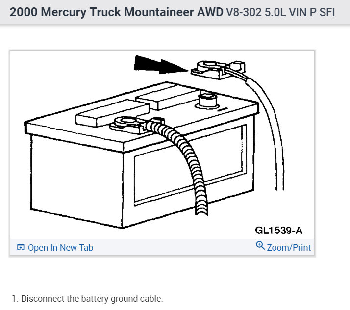

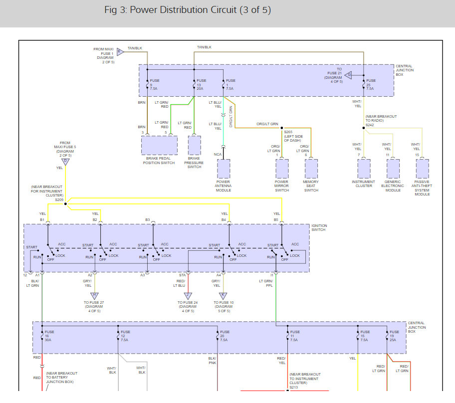

My wife and I were going to the store and gray smoke come from the instrument cluster and the speedometer quit working along with the wind shield wipers, the dome lights and the power windows. I changed the gem module and fuses and relays. What can it be?

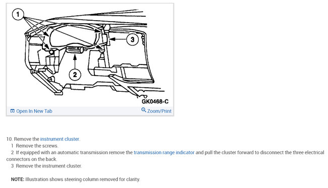

It sounds like the cluster has burned out. Here is a video of the rebuild unit being installed into a similar car. Where there burned fuses?

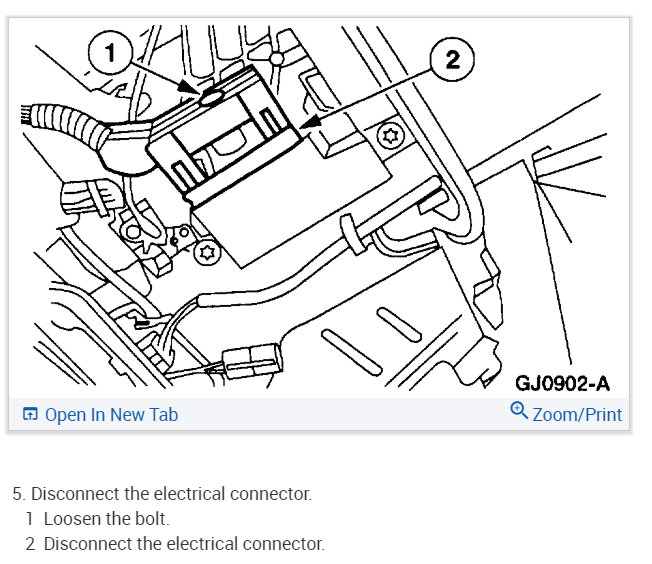

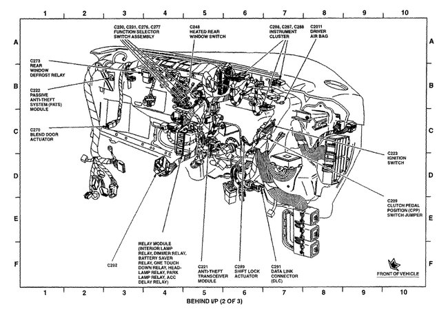

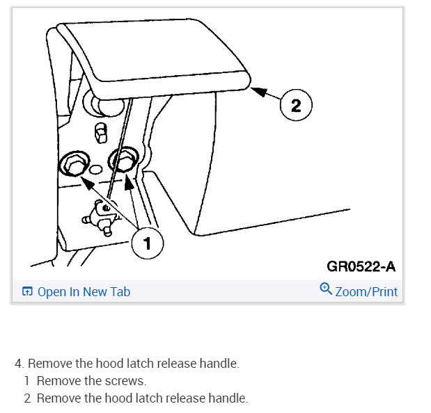

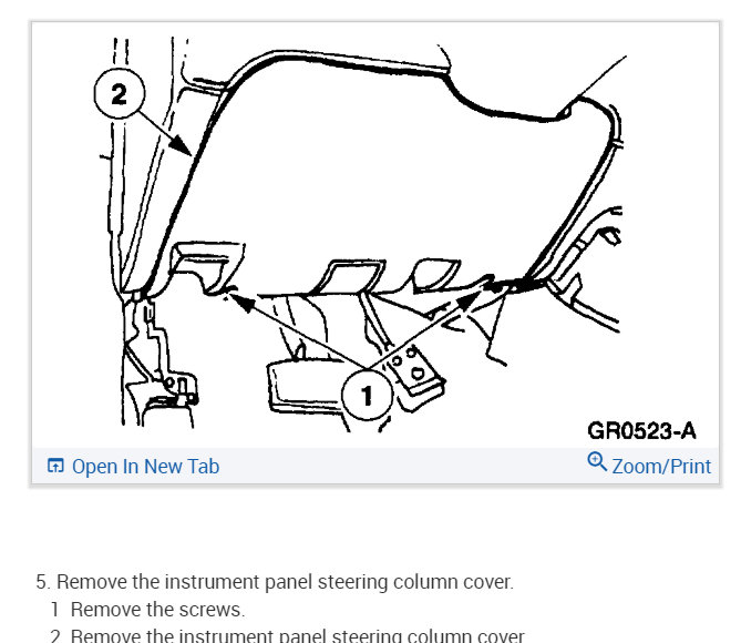

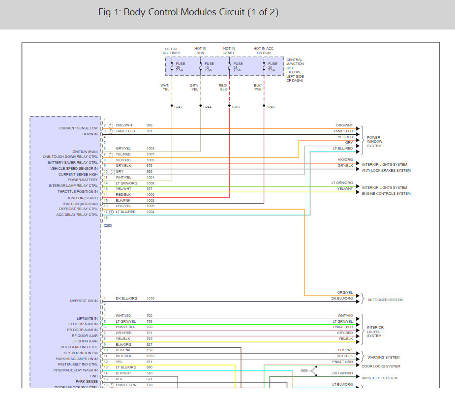

Sorry about that, can you check to see if you are getting power out of the ignition switch with the switch on check the black/light green and light green and purple. Here is a guide to help:

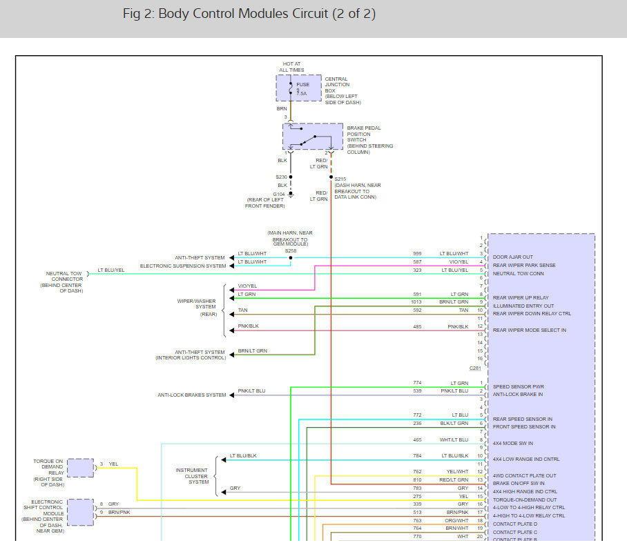

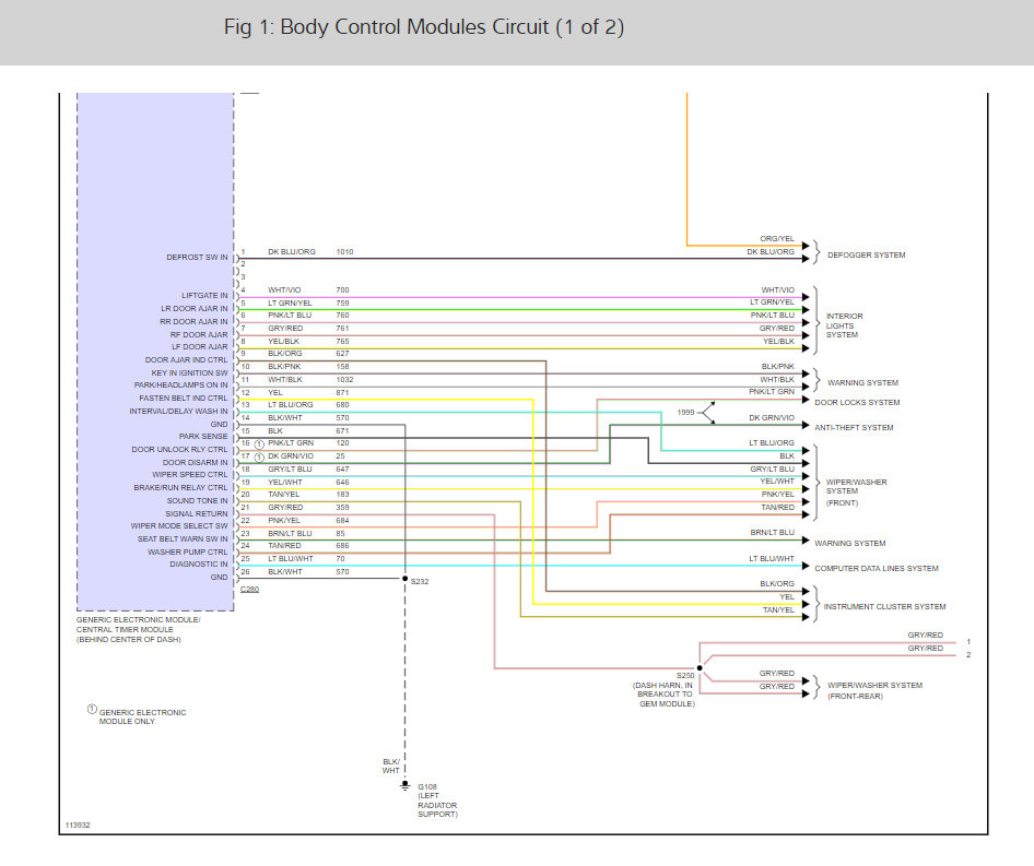

Here is a wiring diagram so you can see how it works.
Nov 16, 2018 at 4:51 AM
GERALD6364
  • 23 POSTS
It does not have power going to it. Now what?
Nov 18, 2018 at 10:50 AM
  • 55,797 POSTS

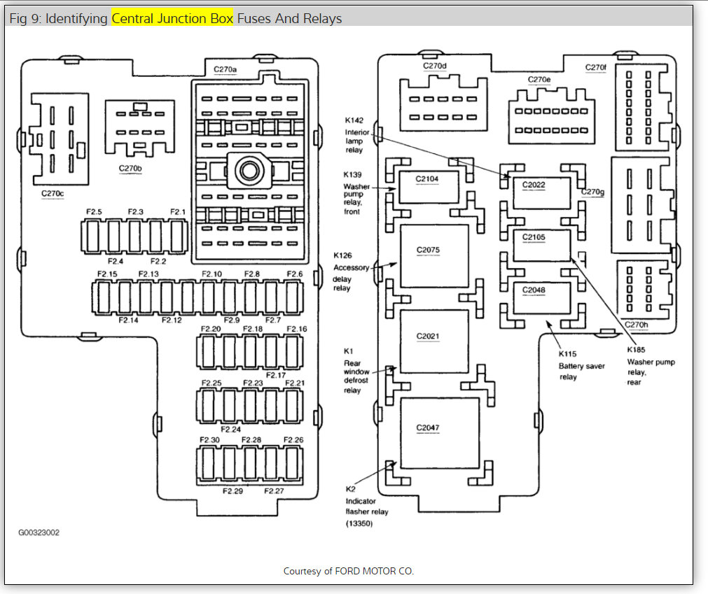

Does the car run? Do you have power at the yellow wires going into the ignition switch?

Yes, we have been driving it to the grocery store, but the speedometer power windows and dome lights not working.

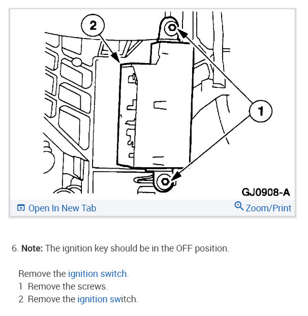

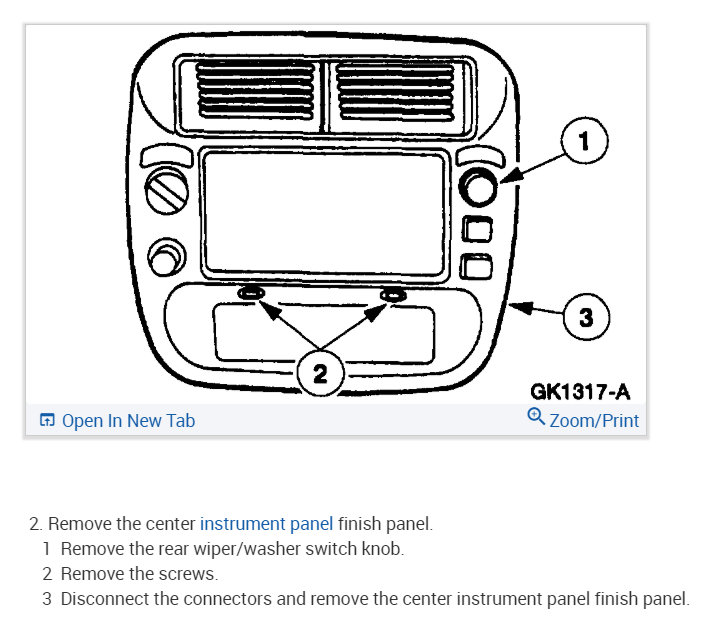

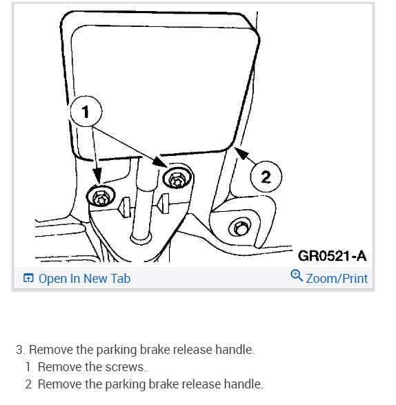

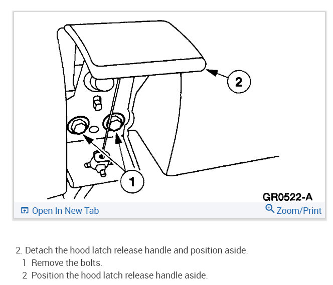

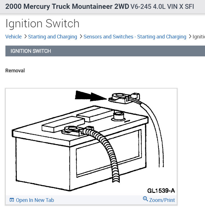

If you do not have power at the black/light green and light green and purple with the switch in the on position the ignition switch is bad and needs to be replaced. Here are diagrams to show you how. Check out the diagrams (below). Please let us know what happens.

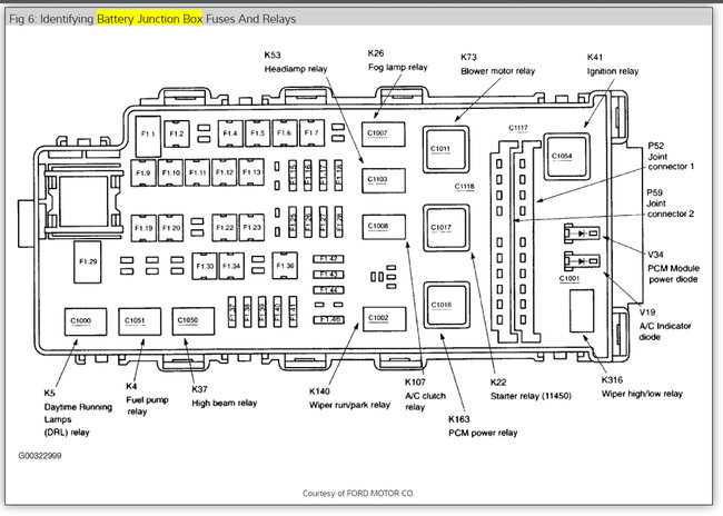

Can you tell me where the battery saver relay is located?
Nov 22, 2018 at 3:19 AM
  • 55,797 POSTS

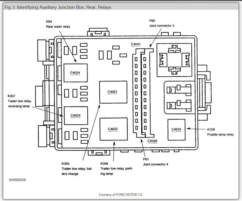

Yes, water can cause all kinds of issues. Battery Saver Relay - In relay module. Here is a guide to help you test it:
Check out the diagrams (below). Please let us know what you find.

I changed the ignition switch. Gem module. All the fuses and relays and it is still doing the same thing. I checked the wire's again and now I am getting power to the light green and purple but no power to the black and light green wire. Now what do I do?

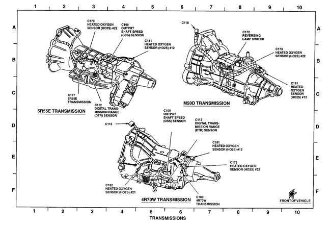

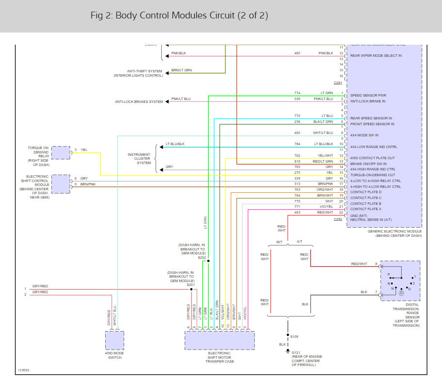

It sounds like when the cluster blew it took out the VSS. Here is its location. (output speed sensor)
Dec 3, 2018 at 1:18 AM
GERALD6364
  • 23 POSTS
Does it have anything to do with the power windows windshield wipers and the dome light not working?
Dec 10, 2018 at 2:29 PM
  • 55,797 POSTS

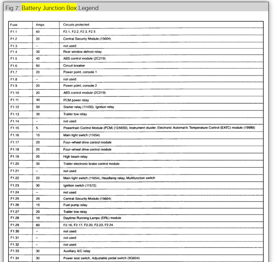

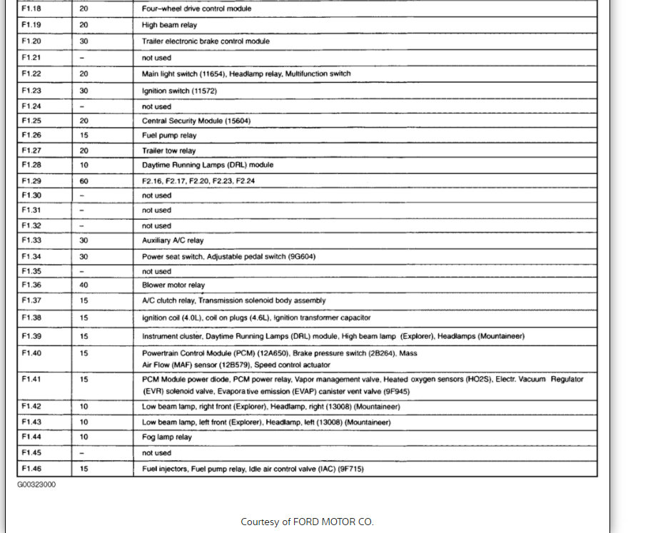

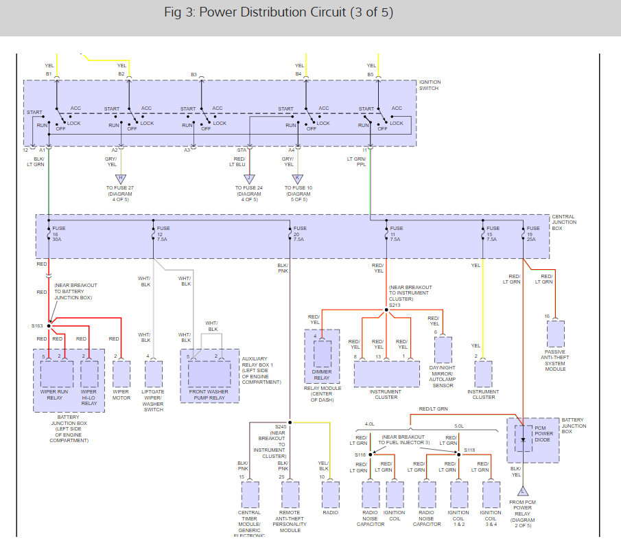

No. Can you use a test light to check for power at fuse # 18 and #26 and maxi fuse #4?
Dec 11, 2018 at 3:49 AM
GERALD6364
  • 23 POSTS
The ones on the inside or outside?
Dec 11, 2018 at 7:09 PM
  • 55,797 POSTS
They are both the maxi fuse is for sure under the hood.

I checked all of the fuses and they are showing 12 volts.
Dec 13, 2018 at 5:55 AM
  • 55,797 POSTS

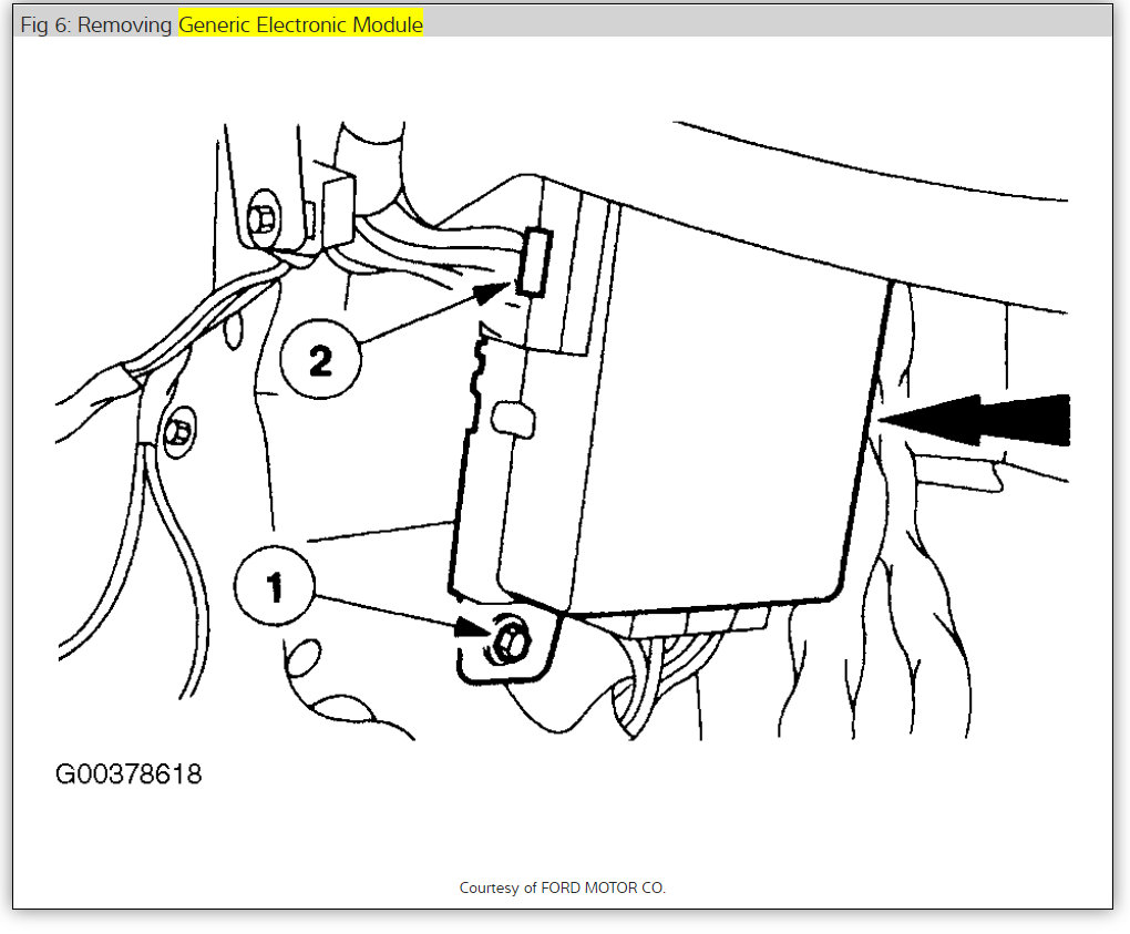

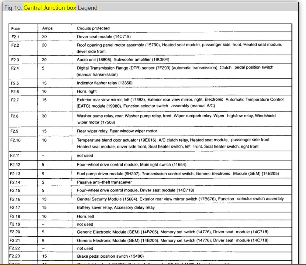

Then the only thing that ties these together is the GEM but you said you replaced that right? Let's check the wiring to the GEM. Here is a guide and wiring diagrams below:
Check fuses 25, 10, 28, 20, check for power and ground at the module.
Dec 14, 2018 at 2:36 AM
GERALD6364
  • 23 POSTS
I bought the GEM off the internet for $18.00. Could it be bad and can you test them?
Dec 14, 2018 at 9:31 AM
  • 55,797 POSTS
Not really, I would try a new unit.

What color wire's would it be? I can't read a wiring diagram. I'm trying to learn.
Dec 16, 2018 at 1:14 AM
GERALD6364
  • 23 POSTS
If I buy a new gem module will i have to have it programmed to my vehicles identification number for it to work?
Dec 16, 2018 at 4:16 AM
  • 55,797 POSTS
I believe the GEM self initializes. Check out the diagrams (below). Please let us know what happens.

I'm getting power to 10 20 and 25 fuses but there's no power going to the number 28. Fuse
Dec 17, 2018 at 2:44 AM
  • 55,797 POSTS
Sorry # 28 will only have power when cranking can you please check?
Dec 18, 2018 at 2:01 AM
GERALD6364
  • 23 POSTS
I cranked the car and checked it again and it shows 7.5

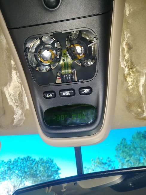

I pulled the sun visor down and found this.
Dec 18, 2018 at 4:29 AM
  • 55,797 POSTS

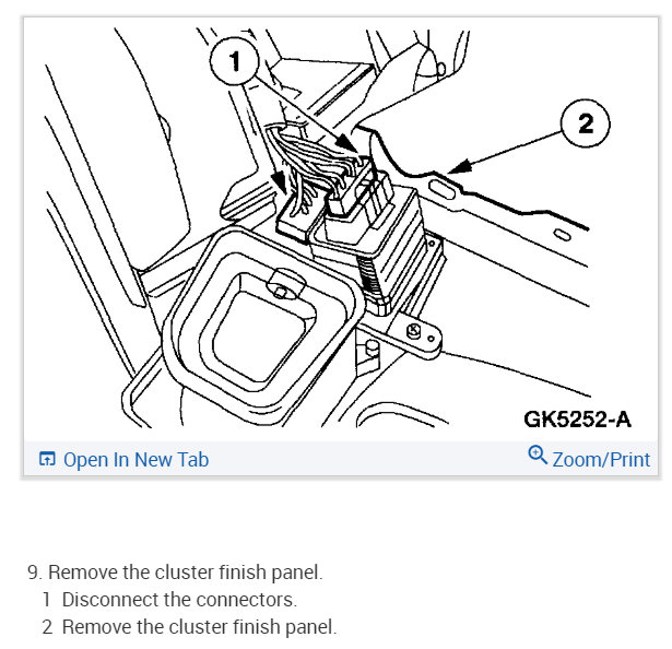

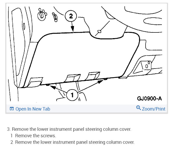

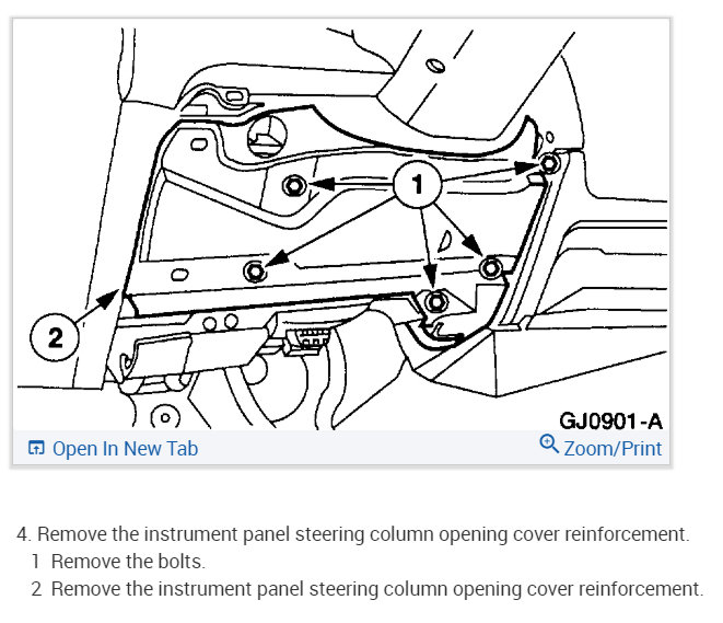

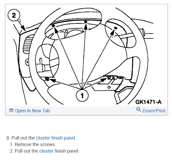

Good find, the car looks like it has severe water damage from a leaking windshield. You better have that fixed first before trying to fix the electrical. Can you remove the cluster and take a picture of the electrical connector? We need to look for corrosion.
Dec 19, 2018 at 3:52 AM
GERALD6364
  • 23 POSTS

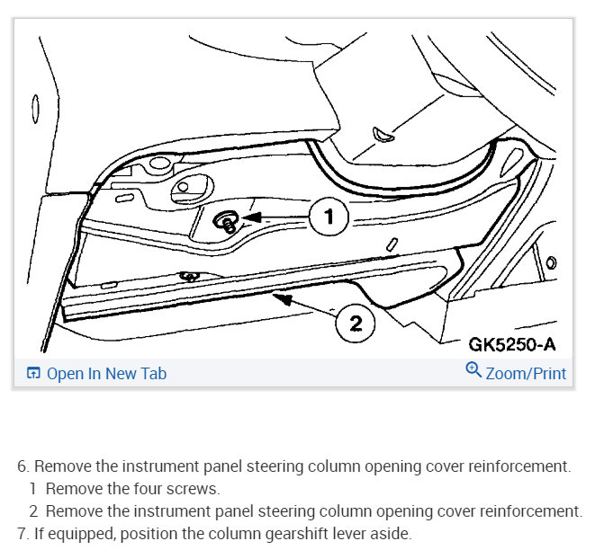

I can remove it after Christmas. What all do we need to look at while i got it out?

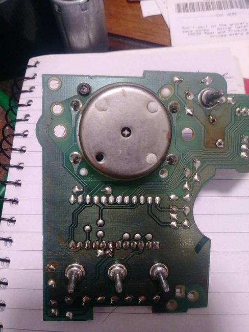

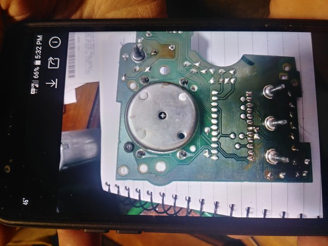

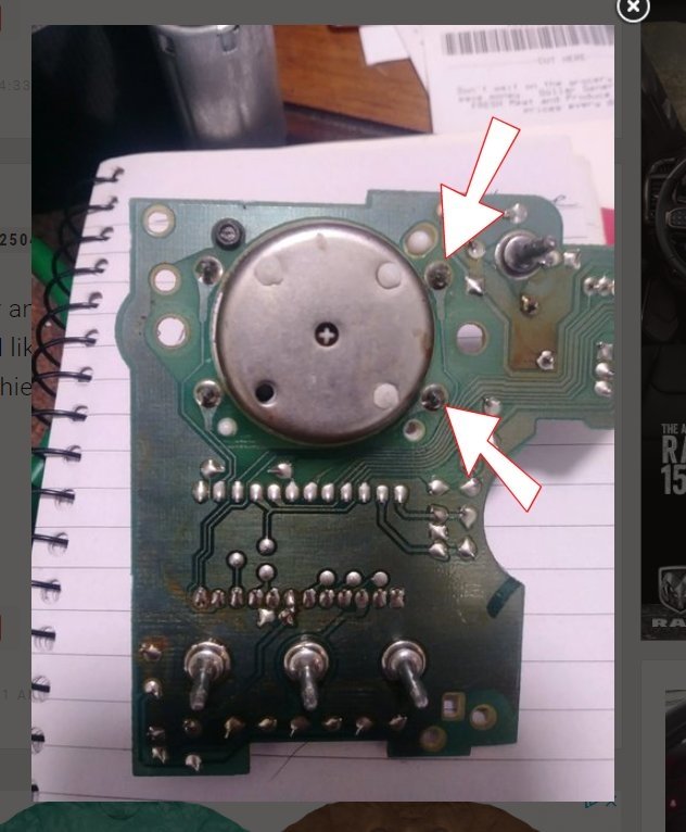

This is off my old cluster the one that gray smoke came from and it smells like burnt wire's. Does it look burnt to you?
Dec 20, 2018 at 6:44 AM
  • 55,797 POSTS
Hard to tell picture in picture but I think I see burnt solder joints in the circuit board.
Dec 20, 2018 at 7:19 AM
GERALD6364
  • 23 POSTS
Could it have shorted out from the water leak?
Dec 20, 2018 at 8:33 AM
GERALD6364
  • 23 POSTS
Can you see this one better and tell from it? When this shored out smoke came from it and it smelled like burnt wires and my power windows, radio, dome lights, sunroof windshield wipers stopped working at the same time.
Dec 21, 2018 at 3:21 AM
  • 55,797 POSTS
I have marked the problem areas in the diagrams below you must be able to clean i up and solder the joints. If not I would try a new or used one.
