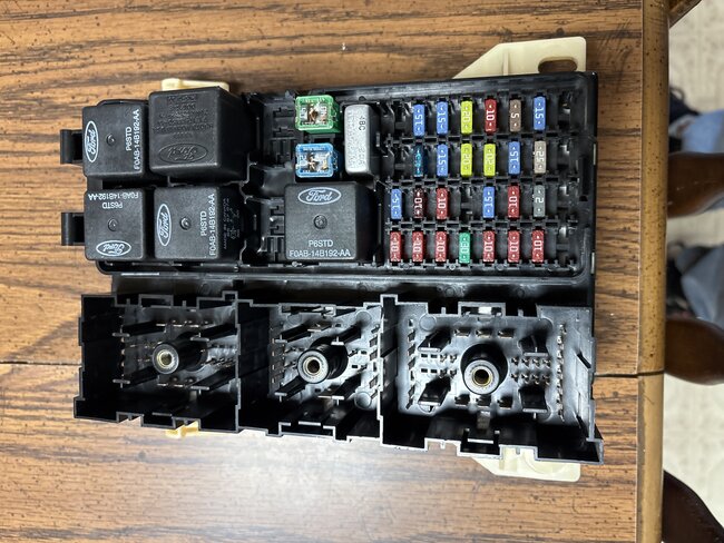

My windshield wipers only work on high, and they do not park. There is no low or no intermittent they shut off where you shut them off at. I replaced the multi switch in the steering column and also the wiper motor I now have the GEM out. I was wondering if there’s a pin out diagram that I could test continuity on the pins from the GEM module that’s already out do you think this is the problem?

Yep, you are on the right track, the GEM controls the wipers this way. I would replace it which should fix the problem.

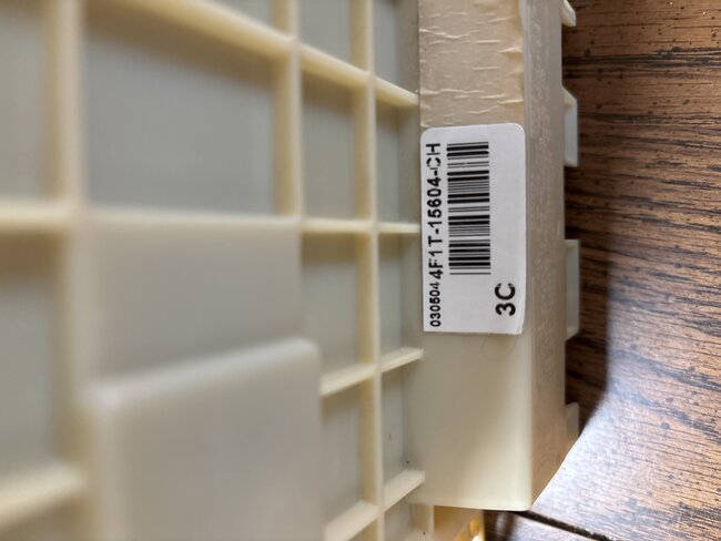

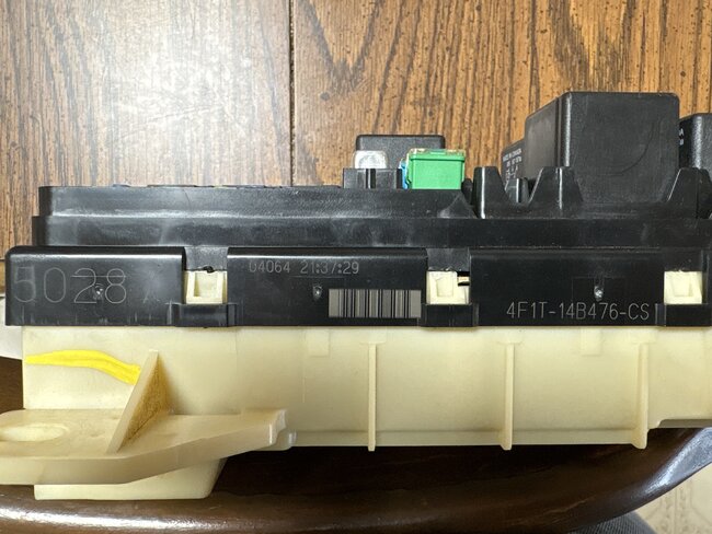

They are not manufactured anymore. so, I have to try to go to a junkyard and find a compatible GEM mod for my 2004 Mercury Sable LS premium. Do you know what cars are compatible with the swap? I have power locks power windows sunroof so forth anti-theft my VIN number is. 1MEFM55S84A621815 in my research it says 2004 2005 say all LS or Taurus will fit.

That is what I took out of the sable I have.

Yep, that is it, here are the cars you that should fit your car:
2004-2005 Mercury Sable LS models (sedan or wagon, with similar options)
2004-2005 Ford Taurus SEL models (particularly ones with sunroof, anti-theft, power locks/windows)
Let us know how it goes.
