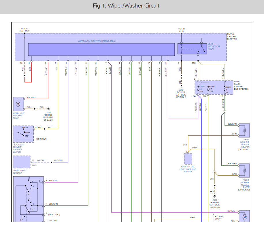

Wipers just stopped working while they were on. Checked what I think is the fuse for them, looked and tested to be good. Not sure what the problem could be.
Oct 4, 2022 at 4:12 AM
  • 55,232 POSTS

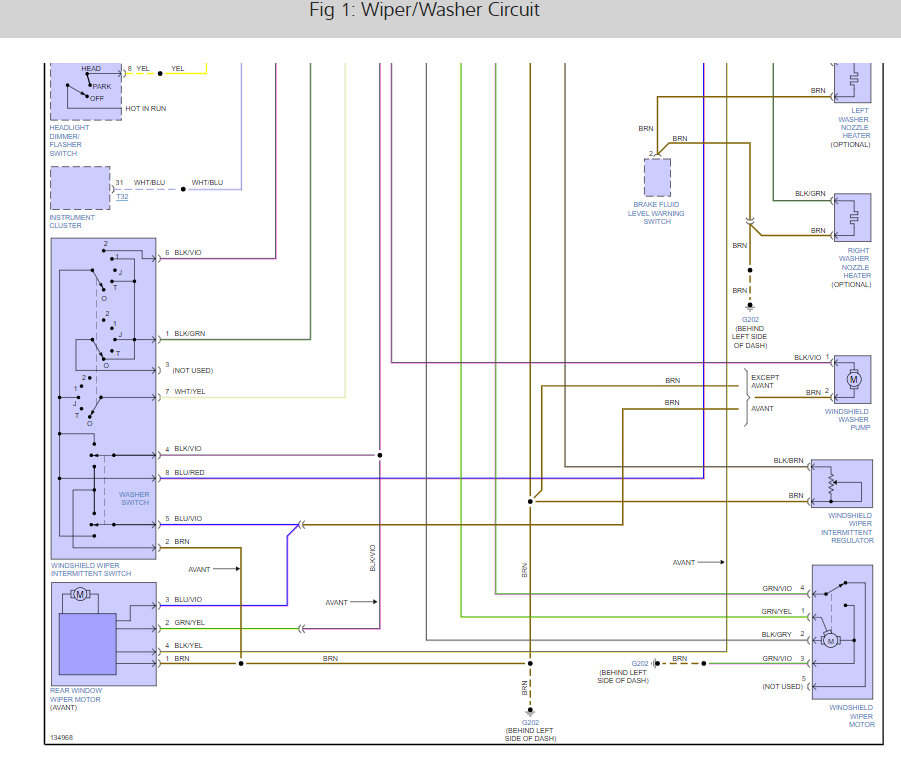

On the left side of the dash there is a fuse panel please check fuses# 24, 27, and 1. here is a guide to help you with the wiper wiring diagrams in the images below so you can see how the wiper system works.
Check out the images (below). Let us know what happens and please upload pictures or videos of the problem.
