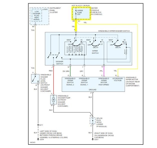

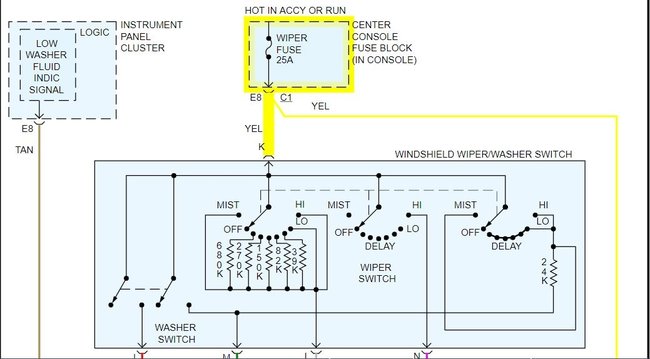

Windshield wipers not working. I turn the switch nothing happens. There isn't any noise, movement.
Jun 25, 2019 at 1:50 AM
Good morning,
You need to start with checking the fuse. Verify power on both sides.
Beyond that, you need to check for power to the switch at the yellow wire in the switch.
