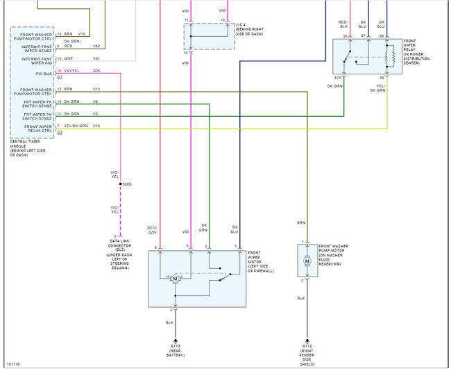

Hello, I have the vehicle listed above Sport model, 287 ci Gas MFI vin N - 2 valve SOHC where the windshield wipers only worked on high. I purchased a new windshield wiper/multi-switch and installed it. Wipers continued to only work on high. I then bought a whole new windshield wiper motor and installed that. Again, the wipers still only worked on high. Once I opened the relay box, I noticed that the relay was completely removed. So, I installed an already-in-use working relay and tried the wipers again. I started the car with the old windshield wiper switch and now the wipers won't turn off at all. I installed the new windshield wiper switch again and the wipers still won't turn off. I am trying to figure out what is wrong and what part I need. With the relay installed the wipers only turn off. When the relay is not installed, the wipers only work on high. You also have to turn them off at the right moment to get them in the down position. With the relay not installed, they won't turn off.
I have also disconnected the battery for a while and re-connected it to no avail.
The computer is not throwing any codes out either.

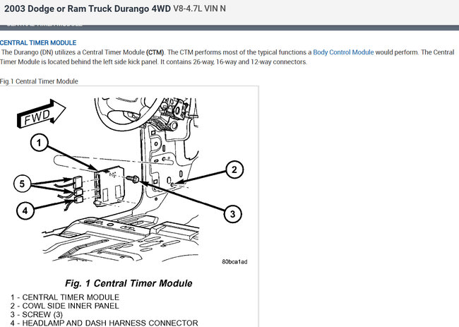

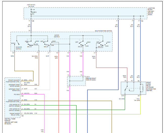

It sounds like the central timer module at the left side of the dash has done out, here is the location so you can swap it out which should fix the problem. I also included the wiper wiring diagrams so you can see how the system works. Check out the images (below). Let us know if you need anything else.

Hi, Ken! Thank you so much for your help! Would I need to have the CTM backed up or can I just swap this part out? If I were to buy a used one it should already be programmed, right?

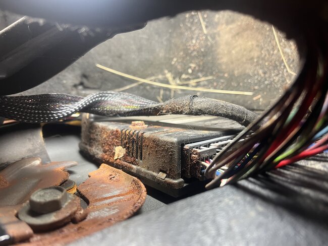

She is certainly all rusty.

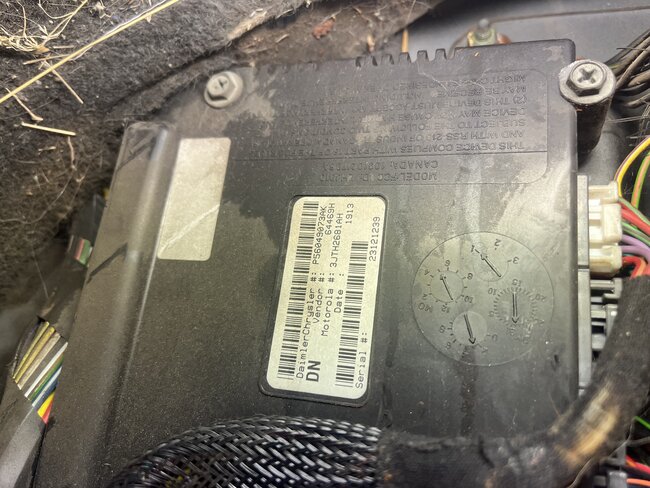

Side view.

Yep, I would get a used one from eBay, thanks for the images they help. They don't need to be programmed.
