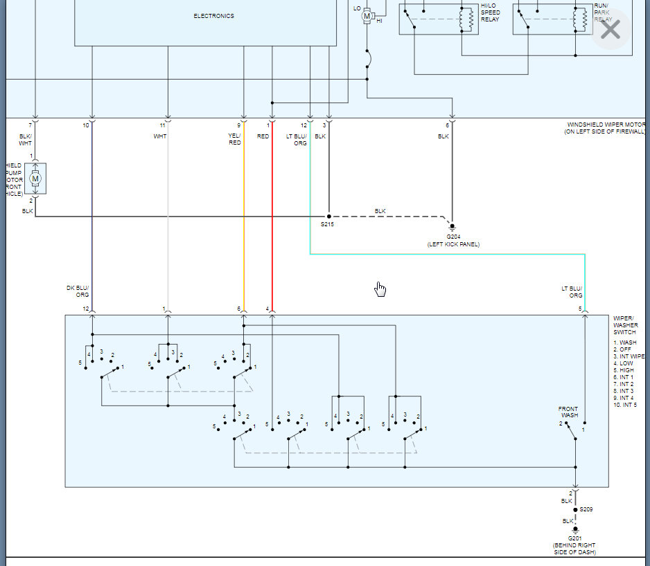

I am not sure I understand what the wipers are doing. When you say they are wacky, does that mean they operate on their own or that they are not wiping in tandem?
Can you get a video of what this is doing?
Also, the washer fluid that is working when the engine is off. Does that mean they are spraying at all times?

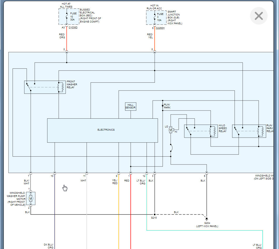

If that is the case then you most likely have a stuck relay. I included the wiring diagram below. We are going to have to check voltage coming from the relay to confirm this.
Let us know what you find with this.

You are correct. The wiper motors are kind of an all encompassing part. So if they are getting power then they take care of it them selves.
However, I would check and clean both grounds. The washer pump and motor share a ground so if that is loose or dirty then you are going to get all sorts of crazy function.
G204 is on the left kick panel.
G201 is behind the dash on the passenger side.
They don't have a diagram showing this location but they should be pretty obvious in that area.
