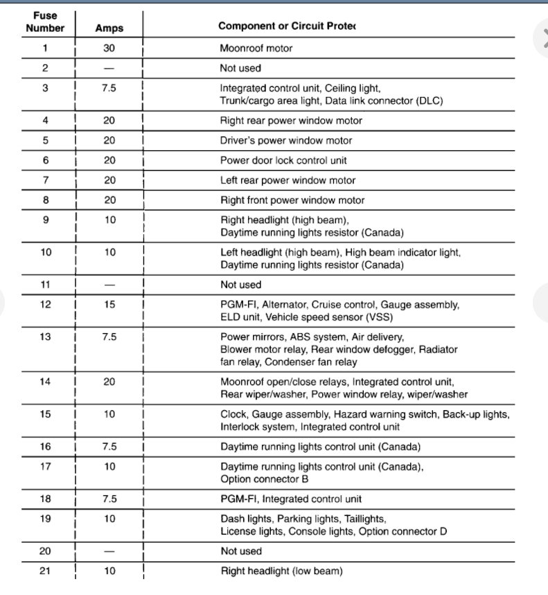

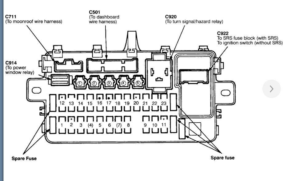

Windshield wipers fuse location
1995 HONDA CIVIC
170,000 MILES • 1.5L • 4 CYL • 2WD • MANUAL
BE FOOTMAN
My under dash fuse box has a cover but the cover doesnt have a legend on it describing which fuse is what, so just trying 2 figure out where the wiper fuse is.
Sep 10, 2020 at 4:53 AM
I attached the info for this fuse box. Looks like it is number 14 fuse. Let us know if you need more info. Check out the diagrams (Below). Please let us know if you need anything else to get the problem fixed. Thanks.
