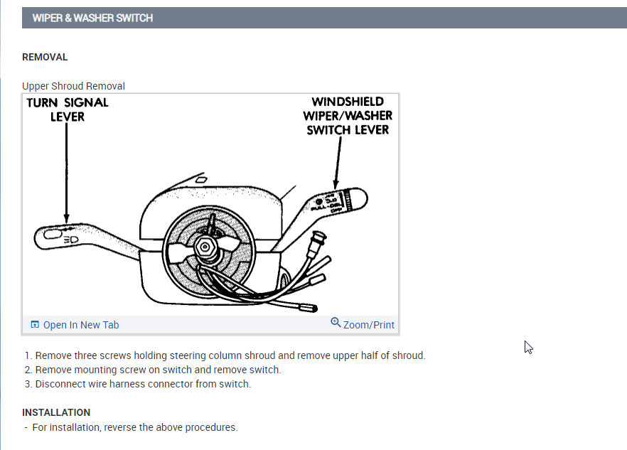

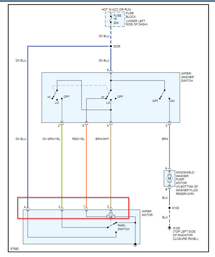

More then likely this is the wiper switch. There is a logic "resistor" inside the switch that is most likely failed.
What I would do is go to the wiper motor and check voltage at each wire on each setting. Clearly you should only have voltage on the wire for that speed. So if you don't have voltage, I would replace the switch.
Here is the wiring diagram and the process on how to replace the switch if this proves out:
https://youtu.be/Hlna_kUt7As
Let me know what questions you have and we can go from there. Thanks

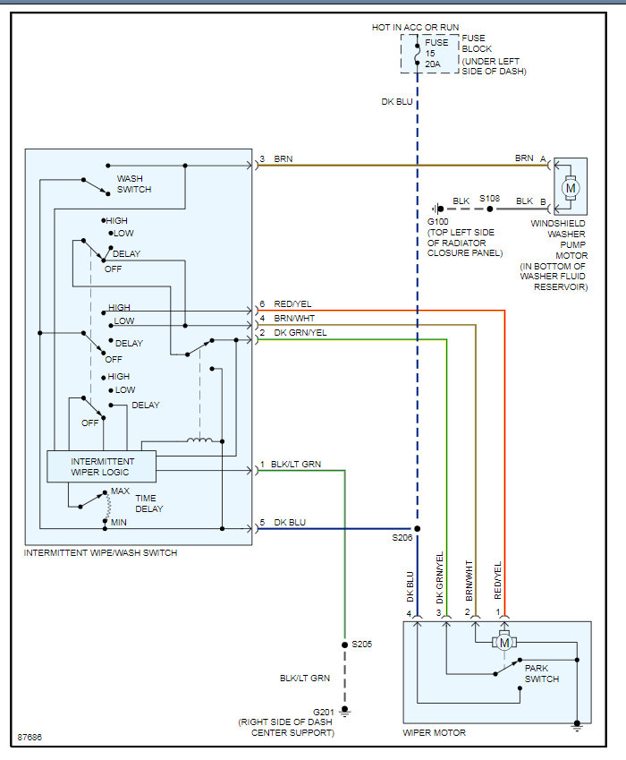

That is interesting. It could be the motor so the way we confirm that is to monitor the voltage at the motor on each wire on each speed setting. Here are a couple guides that can help with that:
If the voltage is correct at the motor on each wire then it is the motor and the switch is fine. However, the fact that it seems to operate when you remove the load of the wipers then that points to a failing motor.
Let me know what questions you have. I attached the wiring below for your review.
