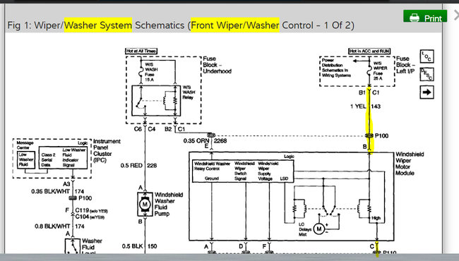

Windshield wipers
JSCOTT572
  • 2003 CHEVROLET SILVERADO
  • 5.0L
  • 6 CYL
  • 4WD
  • 20,000 MILES
Only work on low.
Monday, May 27th, 2019 AT 8:53 AM
SCGRANTURISMO
  • 4,897 POSTS

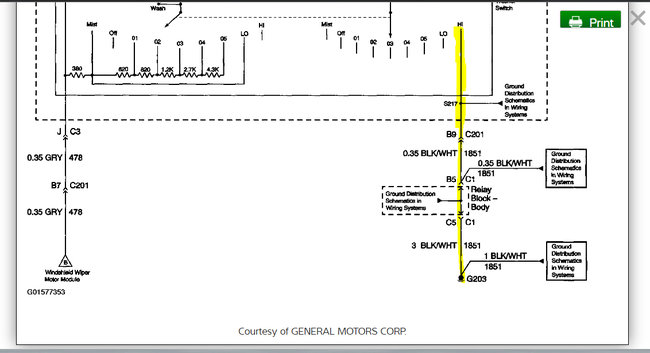

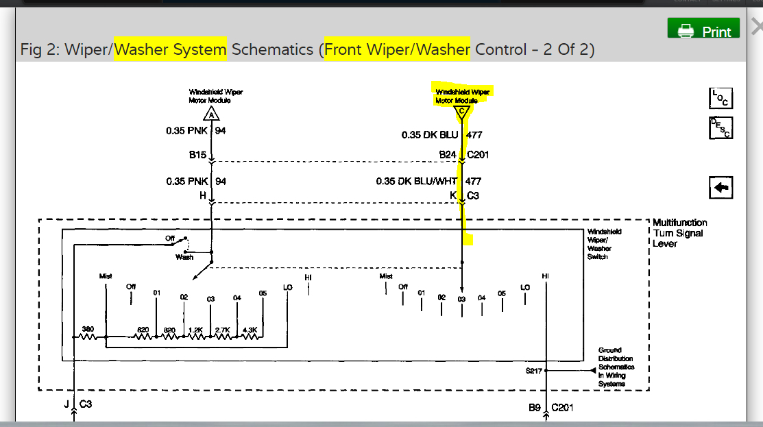

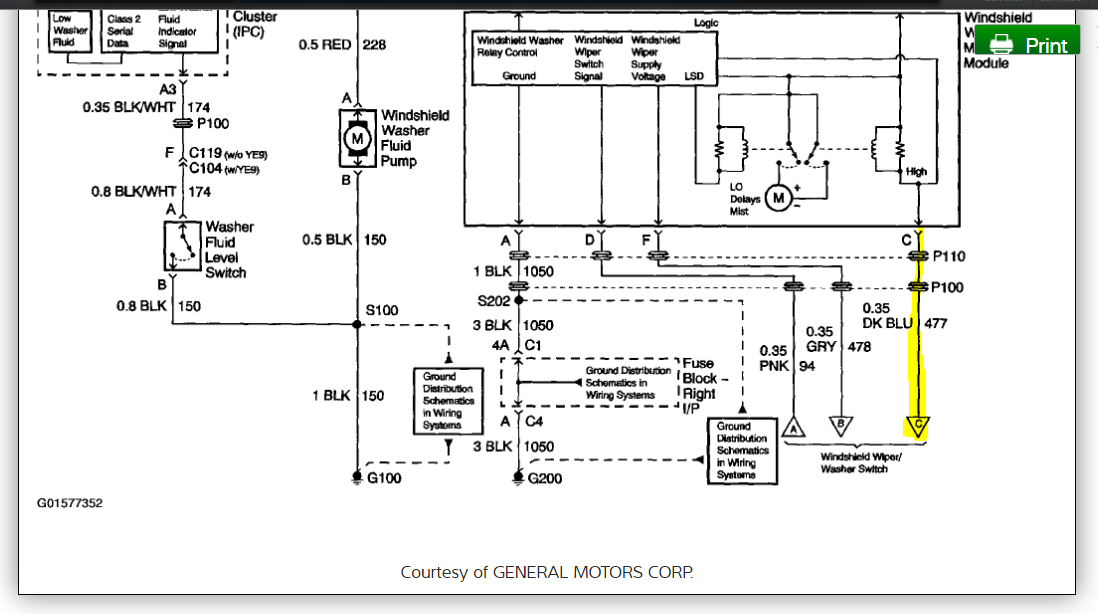

This could be a problem with the wire that is highlighted in the wiring diagrams that I've included in the diagrams down below. I have also included instructions on how to find an open in a circuit. It will require you to use a multi-meter, so I've also included a link for you to go to below if you are not familiar with how to use one.
Please go through these guides and get back to us with what you are able to find out.
