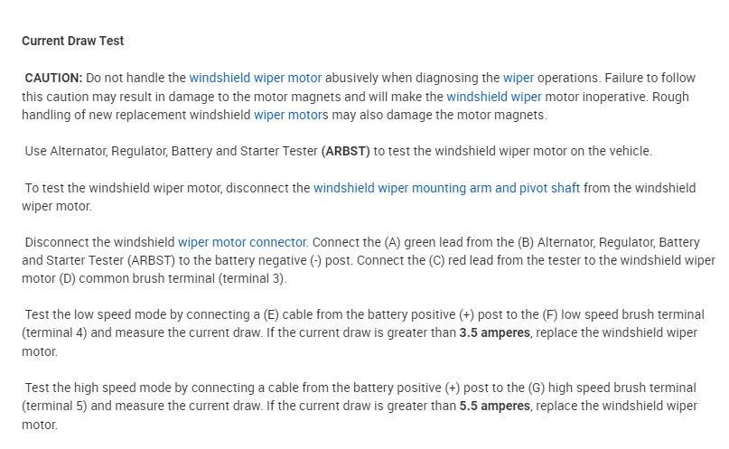

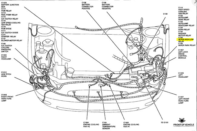

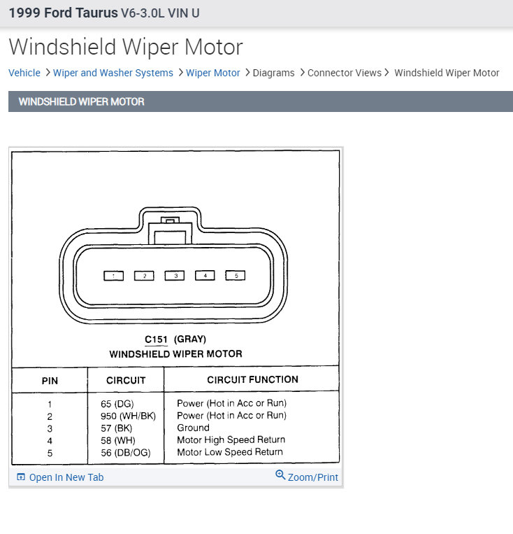

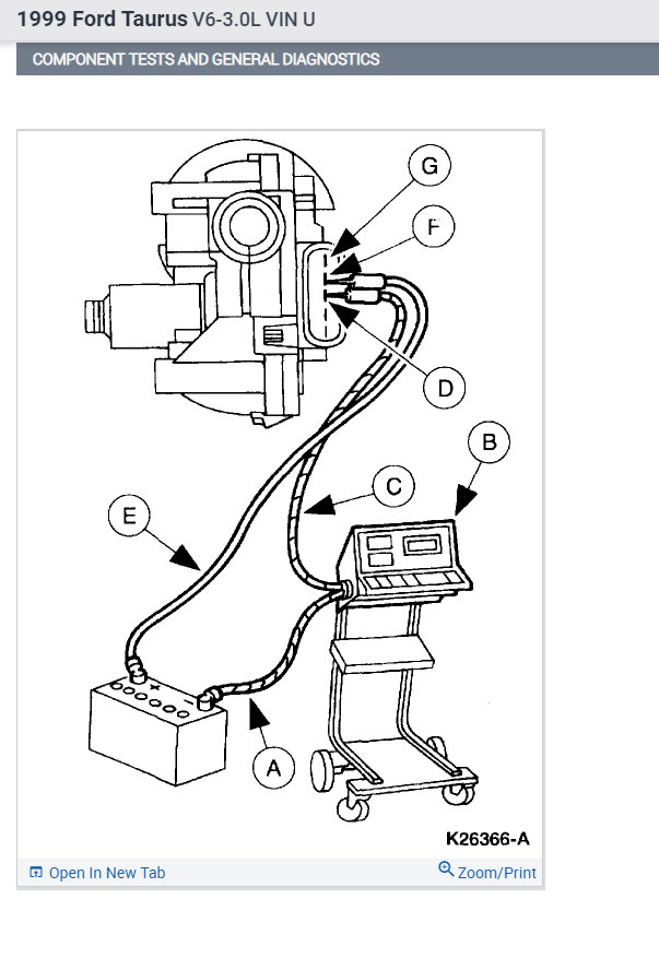

If the fuse is good the next item, you will have to check is to see if there is power to the wiper motor. The issue could be faulty wiring or bad wiper motor or a bad relay for the wiper motor.
The relay is located under the hood (see diagram below). It will be a good idea to inspect the relay. Look for any burnt pins or corrosion.
If there is power to the motor, then the issue is a faulty motor and will need to be replaced.
