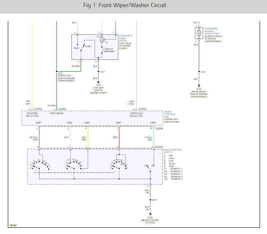

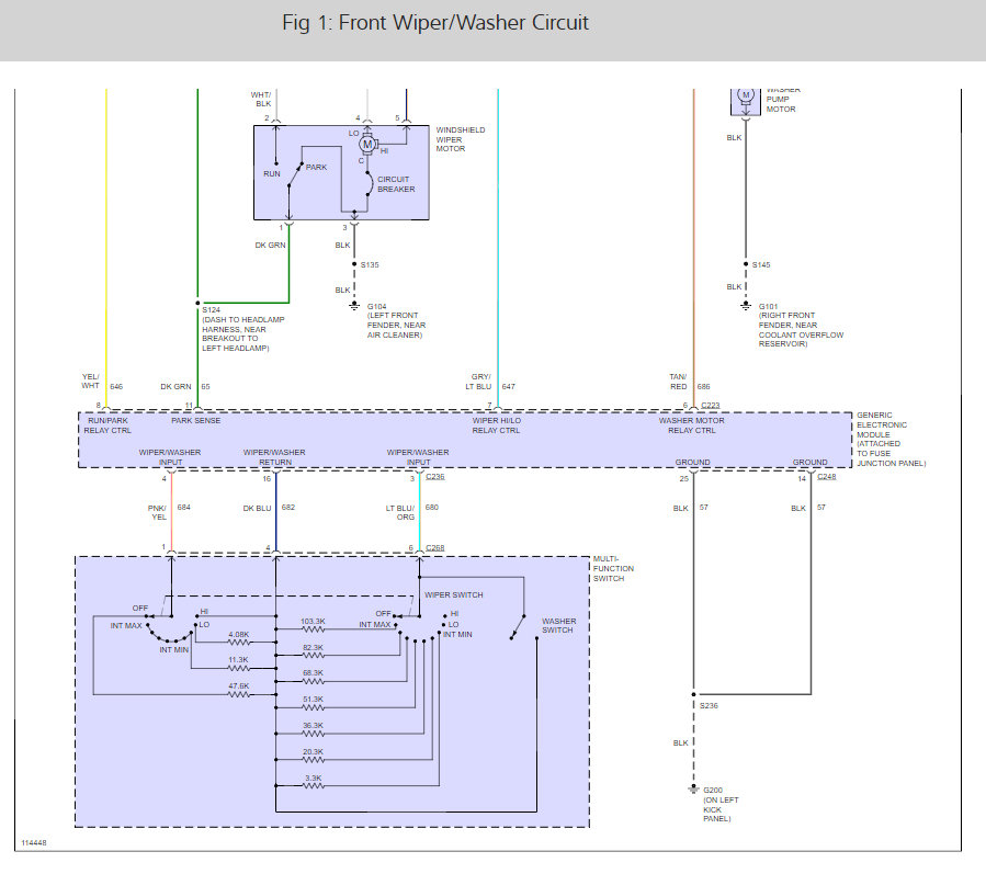

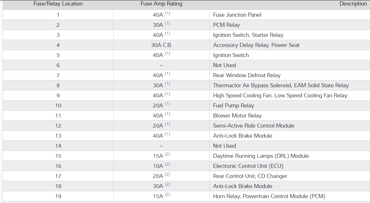

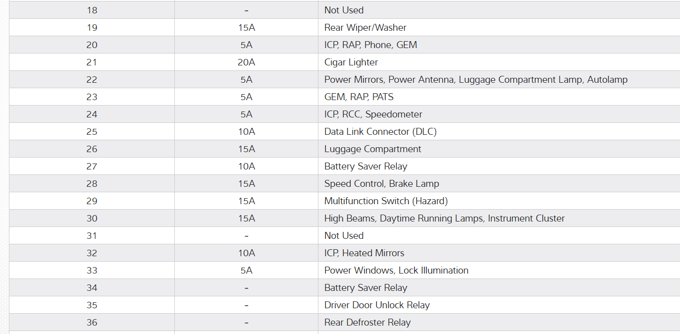

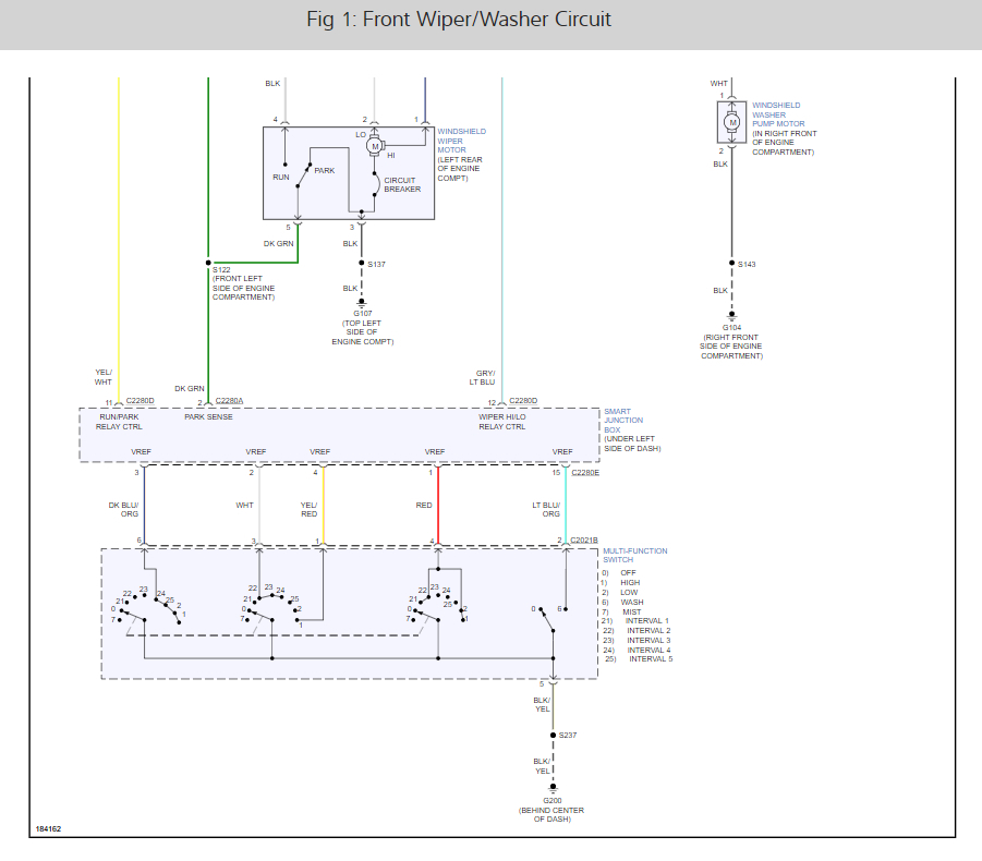

My windshield wipers worked just fine last night, but this morning they wouldn't move. I took them in to be looked at and I was told it was an electrical problem and that an entire fuse box needed to be replaced, for a grand total of about $570. That seems a bit much to me. Is there anything else it could be or any other alternative?
Nov 10, 2010 at 3:57 PM
BMRFIXIT
  • 19,053 POSTS
Hmm.. usually it will be the switch or the motor lets find out which and fix it ourselves. Here is a guide to help test and the wiper wiring diagrams so you can see how the system works.
Lets test of power at the motor. Check out the diagrams (Below). Please run this test and get back to us.
Dec 31, 2016 at 4:30 PM

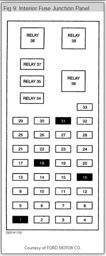

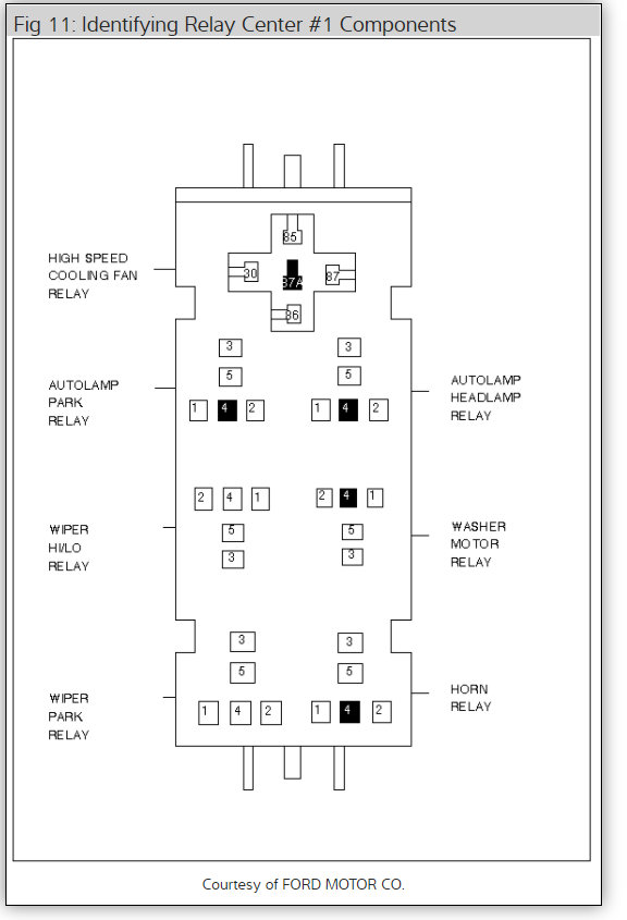

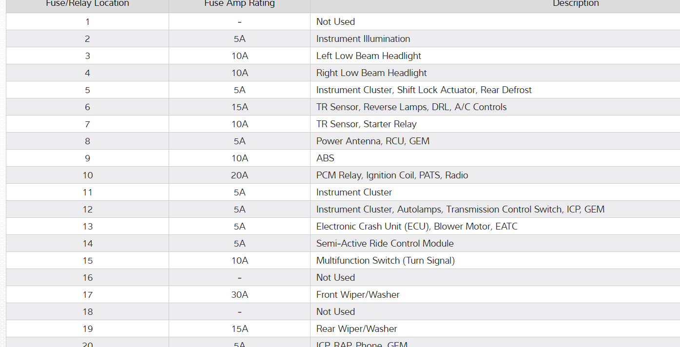

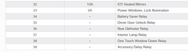

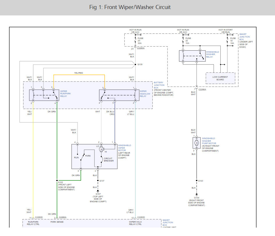

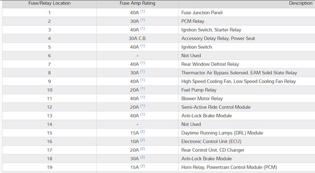

windshield wipers will not work , nothing, no noise, no movement, etc.
Jun 9, 2020 at 9:59 AM (Merged)
  • 75,992 POSTS
It sounds like you have a fuse or relay out here are guides to help you run some easy tests to see if any have failed.
Here are the guides.
and
Here are the wiper fuse and relay locations see where you are losing power my guess would be one of the three relays that run the system.
Please run some tests and get back to us.
Cheers

RTHOMAS621
Swapped the relays. Can hear the relays click in when the car is off, but no motion on the wiper motor at all. Thoughts?
  • 75,992 POSTS
Can you test for power at the motor with the switch on please?
RTHOMAS621
Ras,
With the engine off, but the main power switch on (as though the car were running), I can move the wiper switch through its positions and hear a click from the relays. It seems like maybe the switch and relays might be okay and it may be a bad wiper motor? So I replaced it with a rebuilt one and WOW works great!. Thanks for your help I love this site.
Best, Tom H.

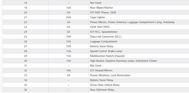

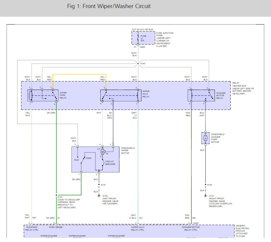

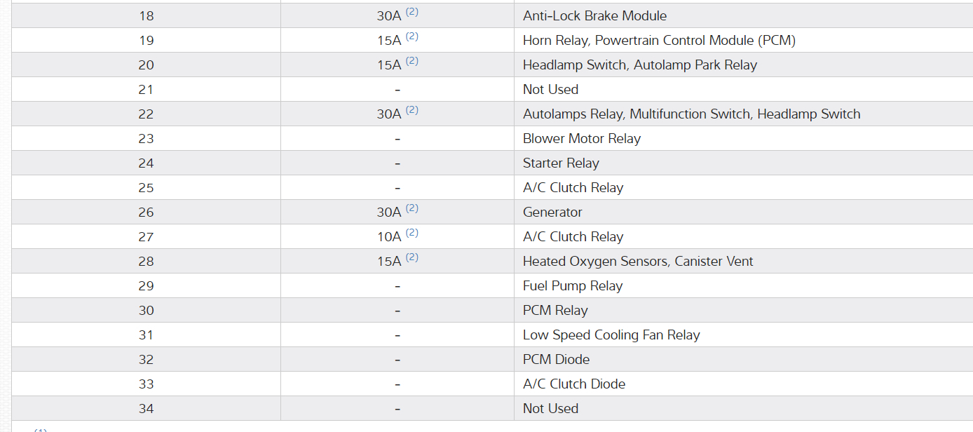

PAF7HOT
I have a 1999 Ford Taurus about 75,000 miles-
Question: Where is the GEM module for the wipers. I have replaced the fuse, switch, relay,motor for the wipers and they still don't work the manual I have says it the only thing left but it doesn't give me a hint as to where it is. The local Ford dealer said it was at the back of the box where all the fuses and and relays are under the the drivers side dash panel BUT it is not. So can you tell just where it is. Thanks Ron :(
Jun 9, 2020 at 10:00 AM (Merged)
SCCAIN
the GEM module is piggybacked behind the fuse box inside the car.
