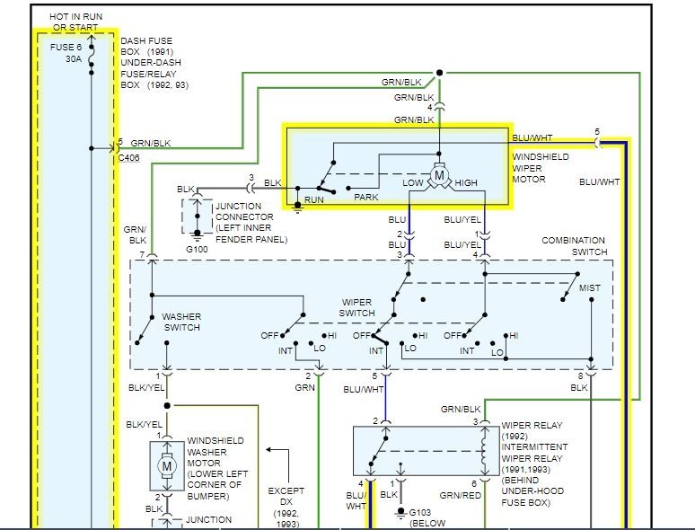

Wipers will operate in the pulse position and will not turn off (wipers will turn off when ignition
is turned off). Thanks
Apr 9, 2020 at 1:14 AM
Good morning,

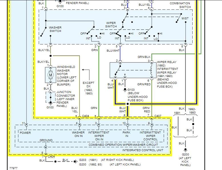

The park control is handled by both the motor itself and the control which is in the fuse block under the hood.
Do you have a voltmeter or test light to do some testing? I attached a wiring diagram for you to view.
In most cases it is the wiper motor itself but needs to be confirmed.
