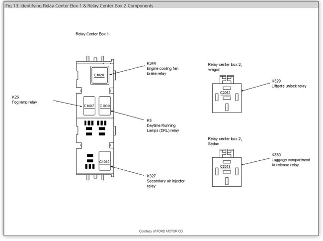

windshield wiper's are not working
2001 MERCURY SABLE
178,500 MILES • 3.0L • 6 CYL • FWD • AUTOMATIC
CJJENNINGS

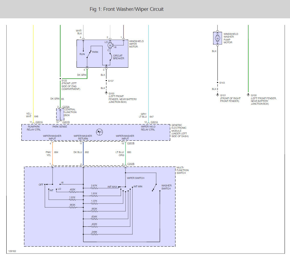

i replaced the wiper motor and there is no power to the motor. the fuse is good and the whole blinker arm that works the works everything but the wipers.
Oct 12, 2017 at 10:45 AM
MHPAUTOS
  • 31,937 POSTS
Sounds as if the wiper switch may be a fault. are you able to test the circuit through the switch with a multi meter?
Oct 12, 2017 at 8:03 PM
CJJENNINGS
No and thank you.
Oct 12, 2017 at 8:25 PM
  • 54,832 POSTS

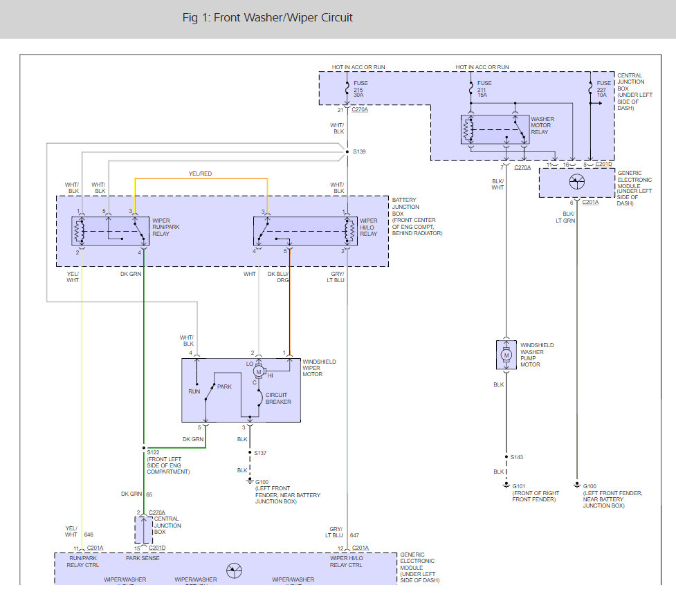

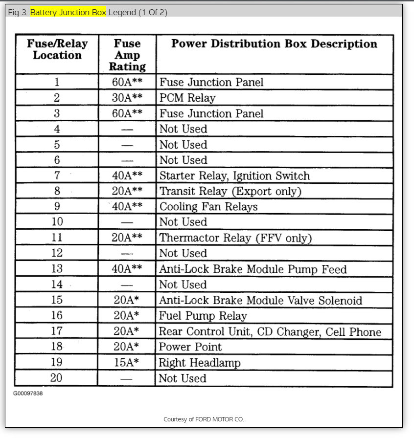

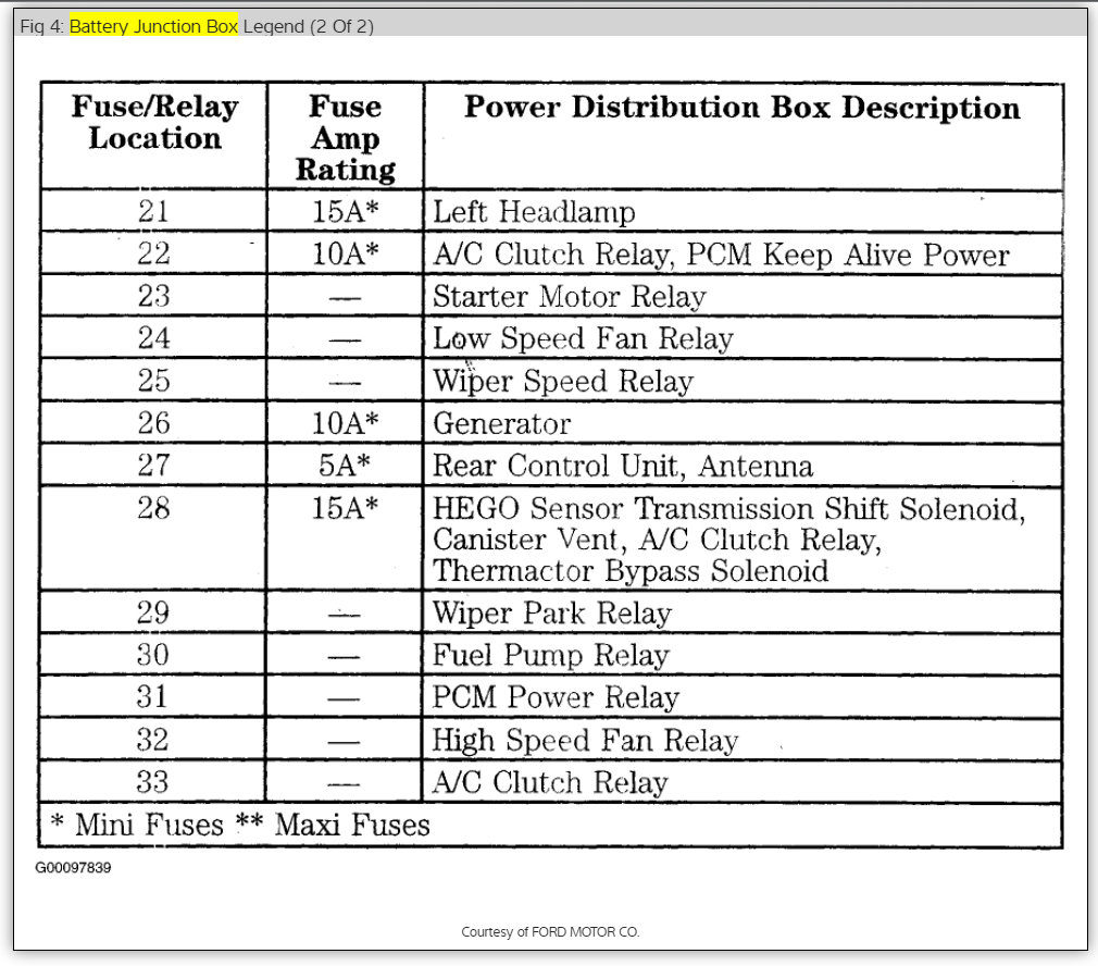

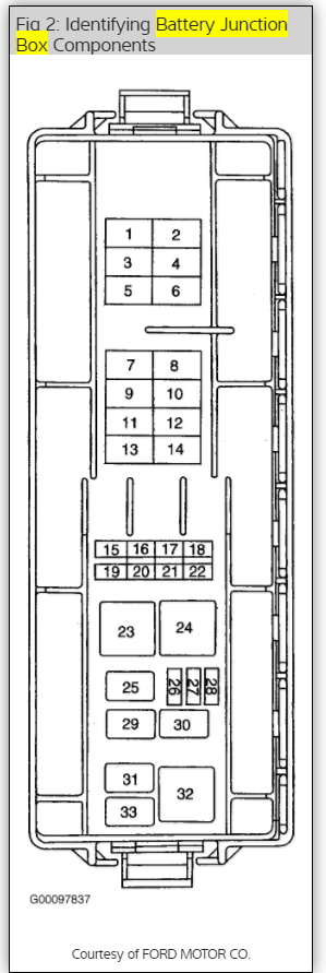

There are two wiper relays that I would check because I think that is your problem.
Here is a guide and some wiring guides to help you do some easy testing/replacing:
and
