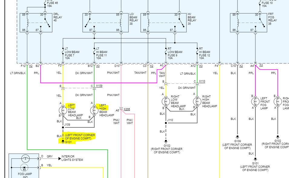

Driver's side headlight was replaced. Now windshield wipers turn on with lights, have to turn off auto lights to shut wipers off. Also turn signals work but no click sound. The driver's side headlight also looks less bright than the other one. I need help please. Thank you

Wiring issues are usually crazy. I just looked through the schematics. I noted that the body control module controls the wiper motor and washer.
Both the headlamp and wiper share a common ground, G101 at the left front of the engine compartment.

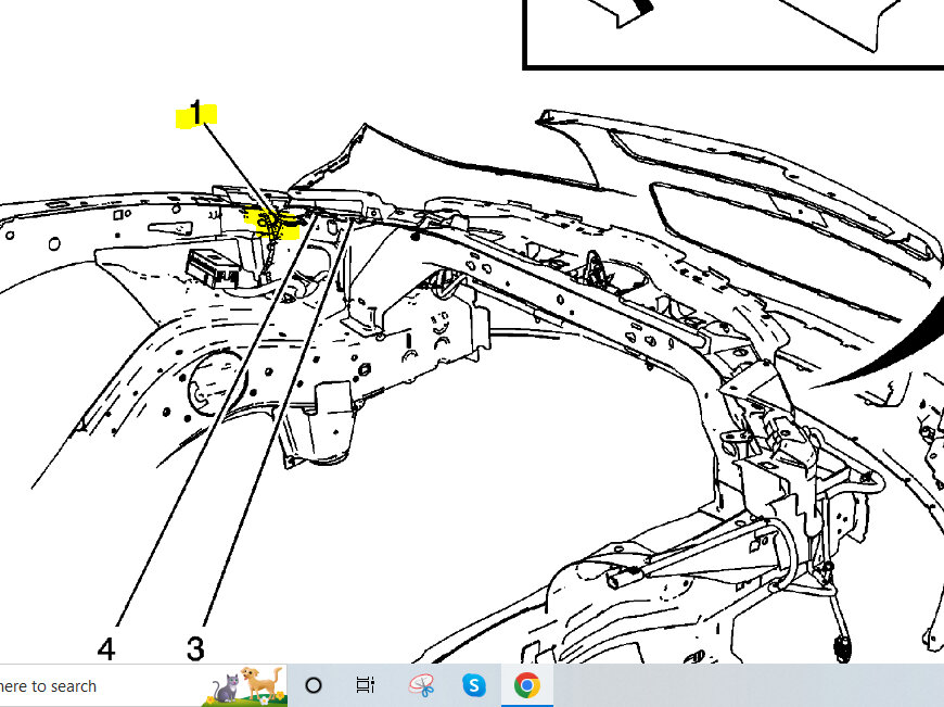

There will be a black wire at the headlamp connector. Follow that to the ground location and inspect it for corrosion, damage, or if it is loose. Or provide a new ground wire.
Pic 2 below shows the ground location.
Let me know what you find.
