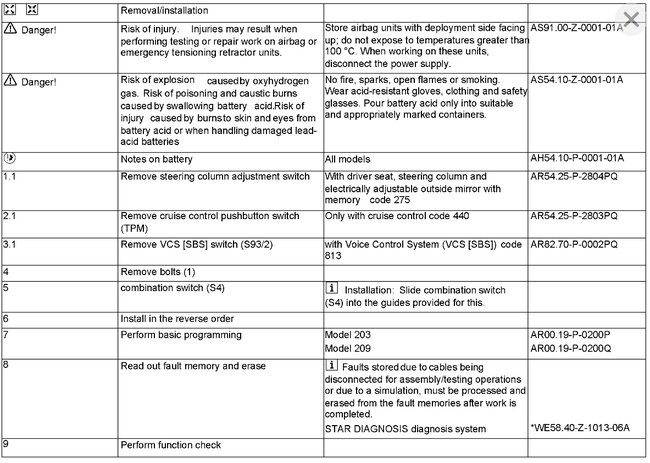

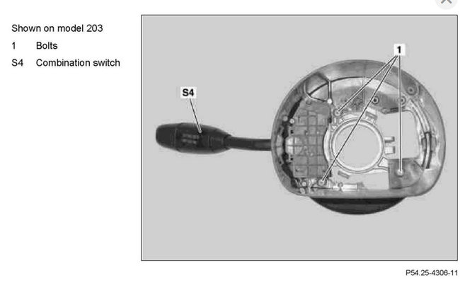

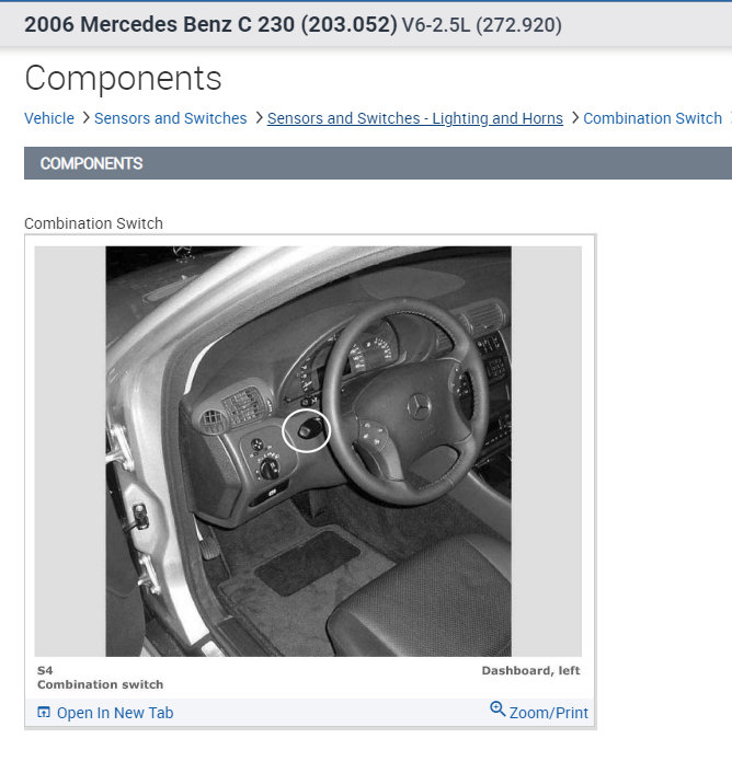

These C230 use the same switch from 2001 to 2007. So yes, the switch out of a 2003 will fit your 2006 vehicle.
In order to replace the switch, the steering wheel will need to be removed.
Take extra causing while working around air bags.
Here is a helpful guide:
https://www.2carpros.com/articles/turn-signal-switch-replacement
I have attached replacement steps below for your reference.
