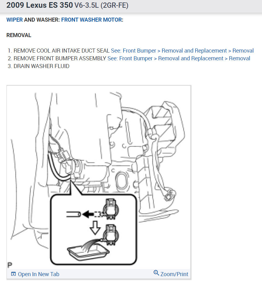

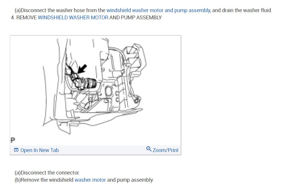

No sound at all and no spraying from the nozzles of the windshield fluid nozzles. where is the motor on these underneath the car?
Apr 24, 2021 at 8:47 AM
  • 55,433 POSTS

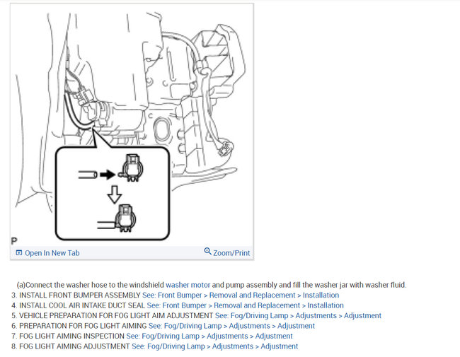

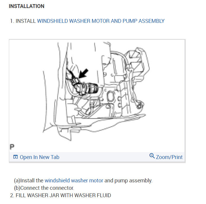

Yep, it sounds like the washer motor has gone out which is common. here is how to do the job in the diagrams below. Check out the diagrams (below). Let us know what happens and please upload pictures or videos of the problem.
Apr 25, 2021 at 12:20 PM

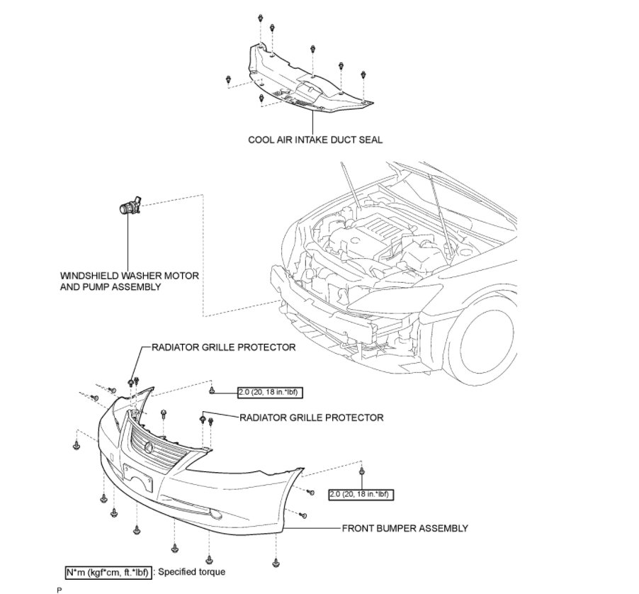

Thanks. Remove the bumper cover?? Lexus must be kidding if this is true.

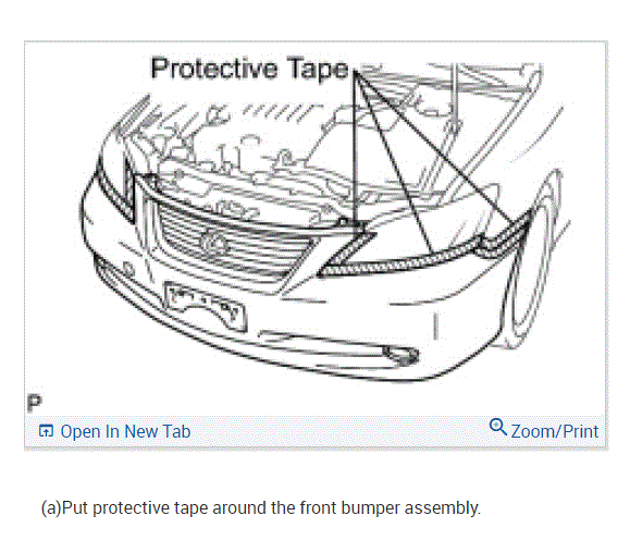

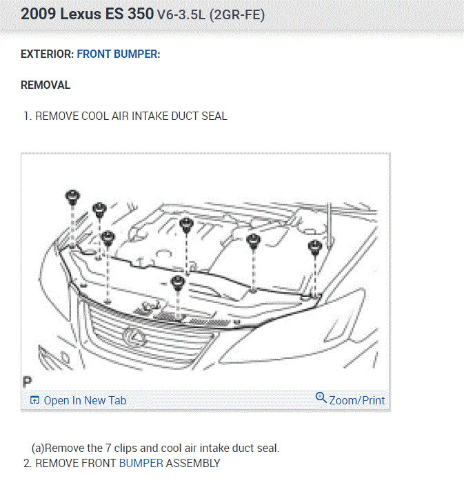

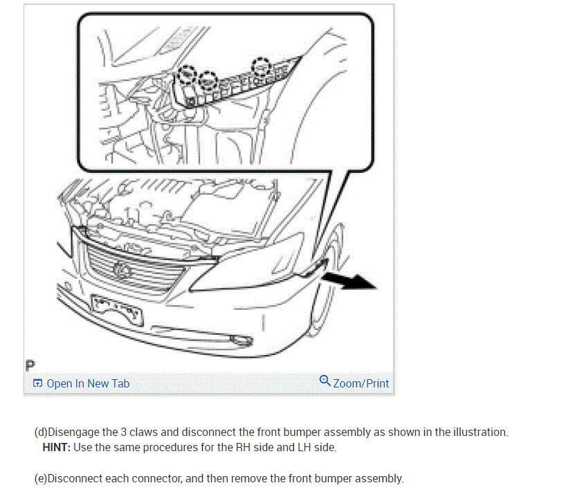

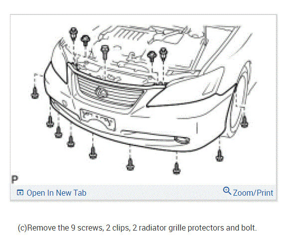

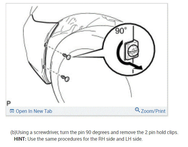

What am asking is, do i have ti remove the bumper cover just to replace it? Based on what the manual says?
Apr 27, 2021 at 1:03 PM
  • 110,244 POSTS
That is required to access the pump. I attached the directions specific to the removal of the front bumper cover for this vehicle. Install is the reverse of removal.
Let me know if it helps.
