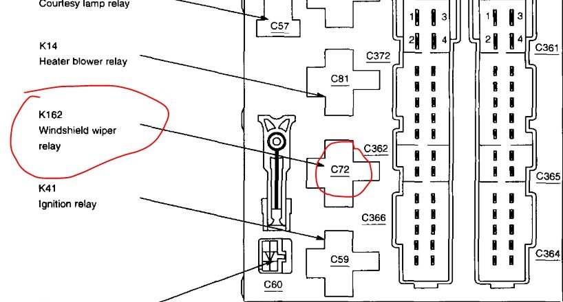

On this vehicle, there is a wiper park switch that allows the wipers to move to the park position. When you have the wipers on low or high, the motor receives power from fuse 20 in the fuse box. When you go to delay or off, then power is provide via the GEM module to the wiper relay. Have you replaced or checked the relay?
I attached a picture of the relay location. Also, try switching the relay with one in the relay box that has the same part number. If there isn't one, here is a link that explains how to test a relay:
Here are a few links that you may find helpful when testing:
Let me know what you find.

Thank you for the info, I did change the relay switch. It still didn't work properly. I tried tracing the wires back to the battery to find a loose wire or burned wire but nothing. I will check the voltage tomorrow.

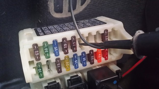

I checked the other fuses in the fuse box and found five of them that were not working. I also checked the terminals where they were. Im not sure if I did it right but some didn't have any power and some had power on one side. I attached a photo to show you how I did the test for the terminals.

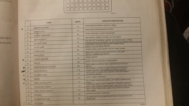

The fuses that weren't getting any power or only had half are the ones I have with a dot next to them in the following picture. The fuse number 30 does work that was a mistake.

Dave, with the fuse removed, it will only have power on one side. The fuse is the jumper that takes it through. Now if you told me only one side had power with the fuse installed, then the fuse is bad.
Now, and I apologize, which fuses get no power? I can't really read what you attached. I see the dots, but I can't make out what is beside them. LOL sorry.

No worries, I don't know if this matters or not. When I used the tester on the battery, the connectors for the positive cable didn't have a good connection. When I moved the tester around on the connectors, some spots didn't have a charge. I'll try to get a video of what I mean. As far as the fuses, it was the following:
19- Mirror Heater
27-Cigar Lighter
29-Rear Window Heater
31-Illumination
32-Radio
33-Side Lights (Left)
Wednesday, September 11th, 2019 AT 5:02 PM

If none of those fuses are getting power, it sounds like the fuse / relay box itself may be bad. At this point and since there are so many, the box needs removed and inspected for damage, corrosion, or anything that would prevent power to so many different fuses. Once it's removed, you will see the plugs that go to it. Check to see if there is anything disconnected or if pins in the plug are pushed back and not making contact.
