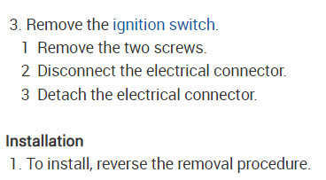

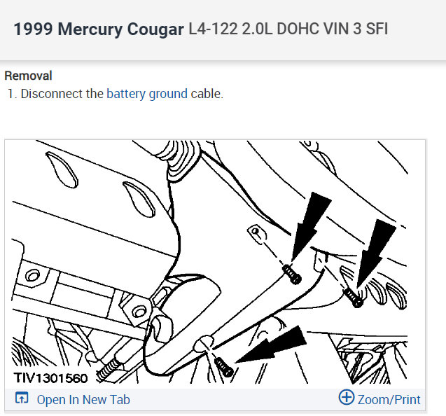

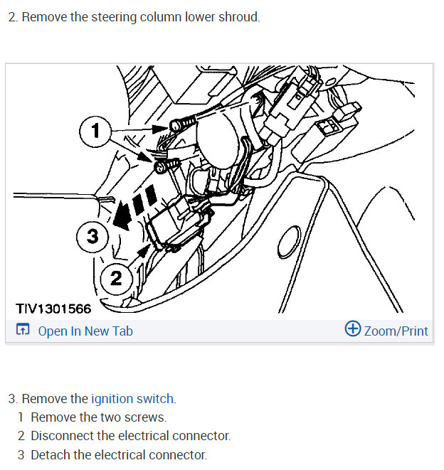

i have a 1999 mercury cougar with 111000 miles on it. it has an automatic transmission. i was driving about 65 mph the other night with my lights on when the car lost power, and the lights and everything went off for a few seconds and then everything came back on for a few seconds (including the windshield wipers which weren't on to begin with) and it kept going on and then going off. so i coasted to the side of the highway, put the car in park, turned off the key and then started it. it started right up so i drove it about 3 miles and it did the same thing again. it did this 3 times in the time it took me to get home which was about 6 miles. i haven't drove it since and that was 3 days ago. if my description doesn't make since its because i'm a female. can someone help.

This happens when the ignition switch overheats because of a bad connection internally. Here is how to swap the switch out to help fix the problem. Check out the images (below). Let us know how it goes
