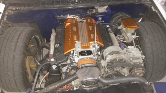

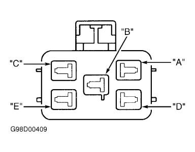

I have no idea how to read that. I know some electronics but what i was looking for was was the power out of the pigtail/connector to the windshield wiper. This is the connector and B I have ground, D I have twelve volts but I was needing to know if that is for high. Do you have to have power at E too? I think that is fuse power but I do not know? When I turn the wiper switch inside to hi the power comes on for D to twelve volts and goes off if I turn it to anything else, so I would think the switch is fine. Thank you for helping this has been driving me crazy. I thought about taking to electric specialist since it is all custom wiring. Here is picture of engine to so you can see how little is in there.
Edit : After looking at it more I understand how to read it somewhat now, and I see the color wires. I think mine has some I will check tomorrow to see so that diagram might come in handy then. But you can see why I am having issues I think, lol.

Does this look right?
May 5, 2018 at 8:44 PM
CMINION718
  • 6 POSTS
That is it, thank you heyman. Now the question is, I do not get any power on C so does that mean it would not work because no power on that line? would that be a fuse or relay? I could not find any blown fuses but it could be somewhere else in wiring since a lot of it is custom.

No power on C = no power to the wiper motor. The logic board on the motor uses the power from C to activate the motor based on the inputs from the other pins.
You need a good ground on PIN B
Battery voltage through a 25 amp fuse to PIN C
Now the other pins are the controls.
Turn the wiper switch to HIGH and you should get battery voltage on PIN D
Now for low speed constant wipe it should show battery voltage on PIN E.
If you switch to the intermittent/pulse wiper function the voltage on PIN E will go lower as the intermittent wipe interval gets longer.
For the washers function it applies battery voltage at PIN A and also turns on the washer pump in the bottle. When you press only the washer function with the wipers OFF the wipers will sweep and return to park as long as you are holding the washers on. When the wipers are ON the washer function only triggers the washer pump and the signal on PIN A is ignored.
To test the wiper motor and verify it works is easy. Disconnect the plug. Run a jumper wire from battery negative to PIN B on the motor, Run a 25 amp fused jumper wire to PIN C on the motor.
Now take a short jumper and apply battery voltage to the various motor side pins to test the functions
Voltage to PIN D and the motor should come on at high speed.
Voltage to PIN E and you should get low speed wiper.
Voltage to PIN A and you should get 1-3 sweeps and back to park. (depends on the actual motor logic)
Hope that helps.

Everything runs through that connector both power, ground and control feeds to the wiper motor. A bad relay can cause a lack of power.
Pin A - Dark green wire - This is the wash/park connection on the OEM harness. This is fed battery voltage directly when the washer button is pushed. However it is also fed battery voltage through a 24 Kilo-ohm resistor whenever the wiper motor switch is in any position other than off.
Pin B - This is a heavier black wire that goes directly to a good ground.
Pin C - This is a yellow wire, It is the main motor power feed, and goes to battery power through a 25 amp fuse. It also splits off to feed through the wiper switch.
Pin D - This carries battery voltage when the switch is on high speed only.
Pin E - This carries full battery voltage for low and high speeds. And a reduced voltage on this pin also allows for the intermittent wiper speeds.
Attached you will find the connector and two schematics. The first is the original. The second is stripped of the washer and intermittent controls. It will give high and low speeds only.
Which switch do you actually have for the wipers? The factory switch or something else? If it is the OEM switch you may as well use it and get all the functions. The wires are all needed to control the motor anyway. (other than the red wire for the washers if you did not want to bother with those)
