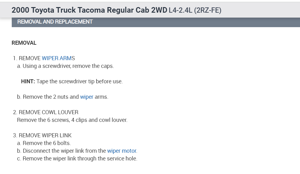

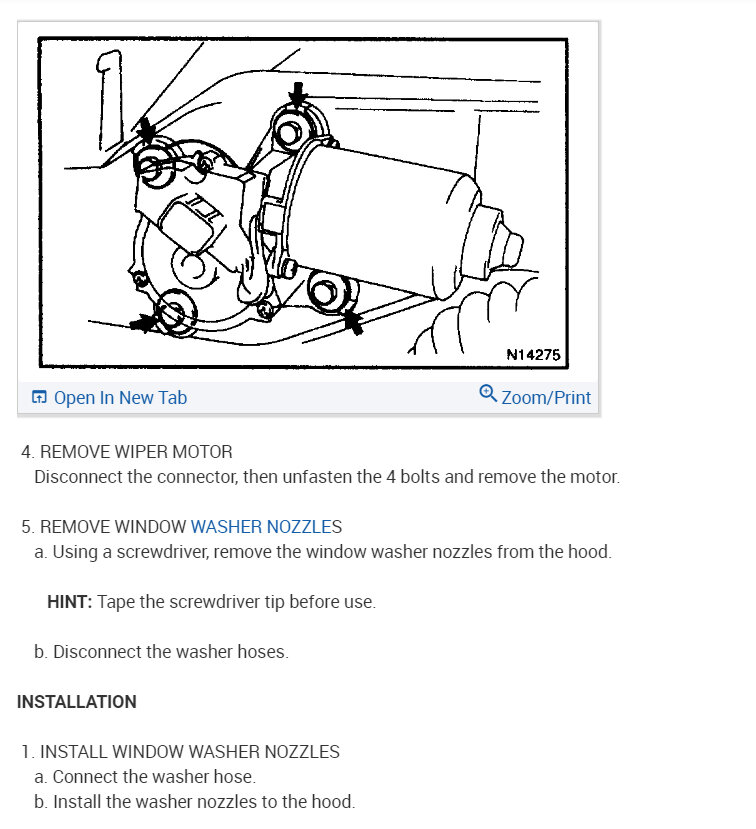

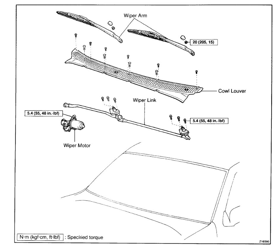

I see the linkage is timing incorrectly which causes this issue. You may just have the motor arm on upside-down if you can upload some images of the linkage and motor, I can help. in the meantime here are the instructions on how to replace the motor and linkage arms. Check out the images (below). Let us know what happens and please upload pictures or videos of the problem.
