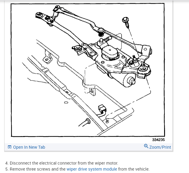

How do I replace the windshield wiper motors?

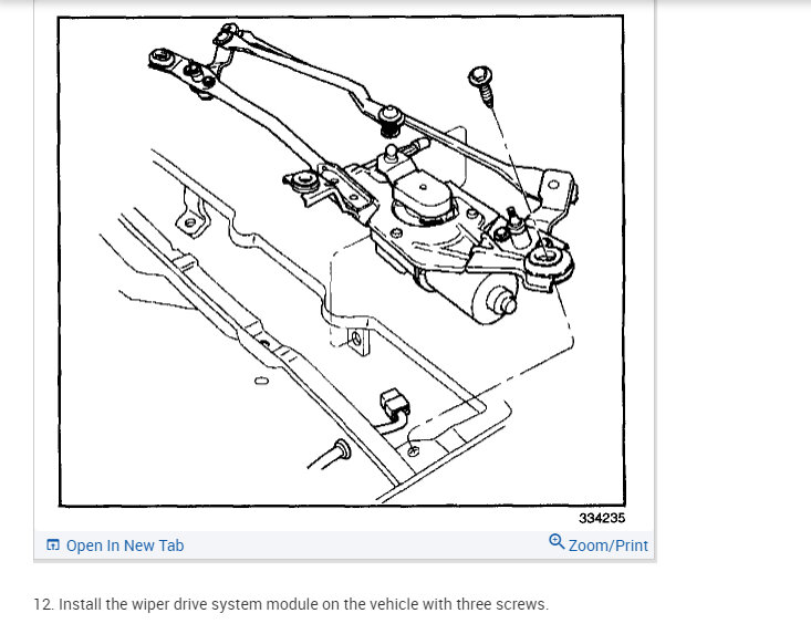

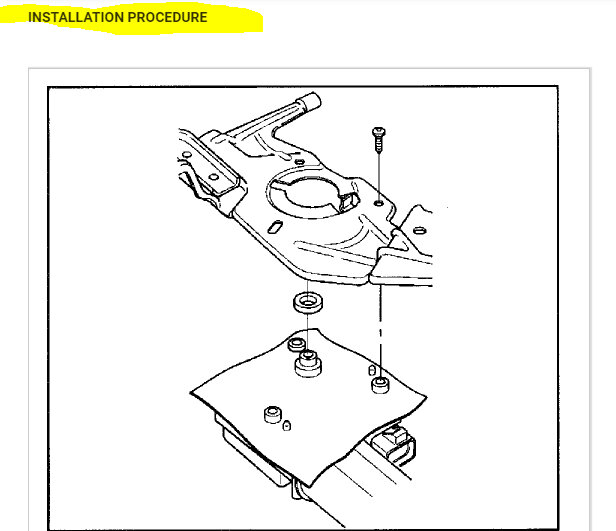

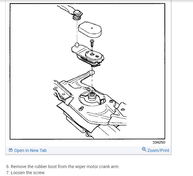

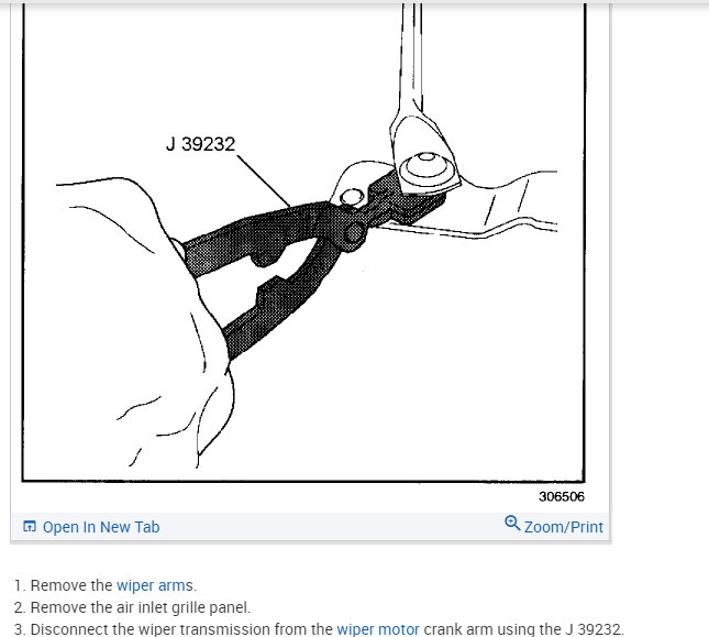

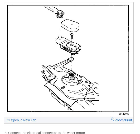

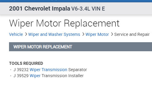

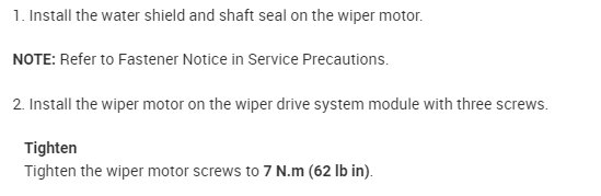

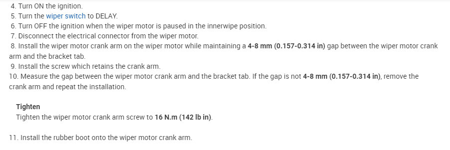

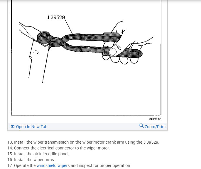

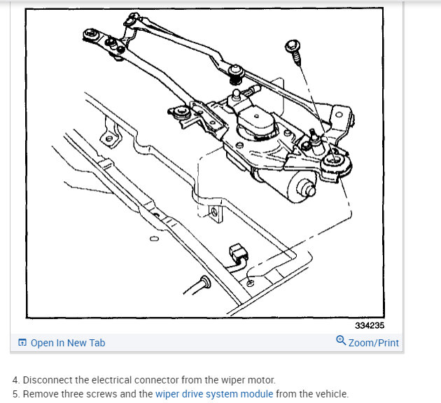

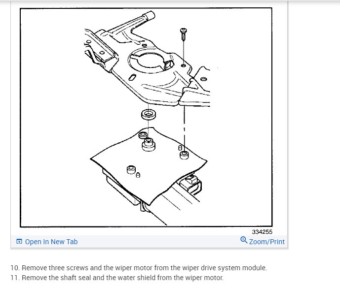

As far as the wiper motor is concerned, you will need a couple of special tools to remove and install it. Most part stores will lend them to you if needed. Also, the tools required are listed on the first page of the directions.
If you look below, I attached the directions for replacing the wiper motor. Take a look through them and let me know if you have questions.
Take care and let me know if this helps.
