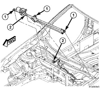

I am trying to find the windshield wiper motor on a friend's car and cannot find a diagram. Where I expected to see it there is a brake fluid reservoir. Any idea where to find a diagram of how to get to it?

It is on the passenger side tucked under the cowl cover. Remove the wiper arms, remove the three push pins from the cowl, then the seal at the engine bay area and remove the cowl cover. Motor will be readily visible then.
