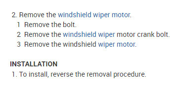

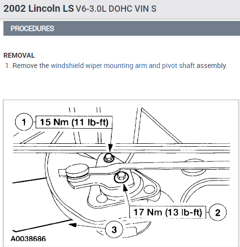

Can you describe step by step how to, remove and replace a windshield wiper motor for the car listed above?
Feb 11, 2021 at 11:27 PM
DANNY L
  • 5,648 POSTS
Hello, I'm Danny.
Here is the information you requested. I've attached 2 picture steps below on how to replace the windshield wiper motor on your vehicle. Hope this helps and thanks for using 2CarPros.
