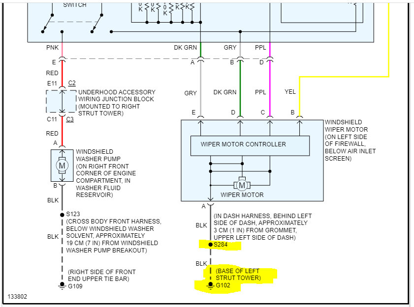

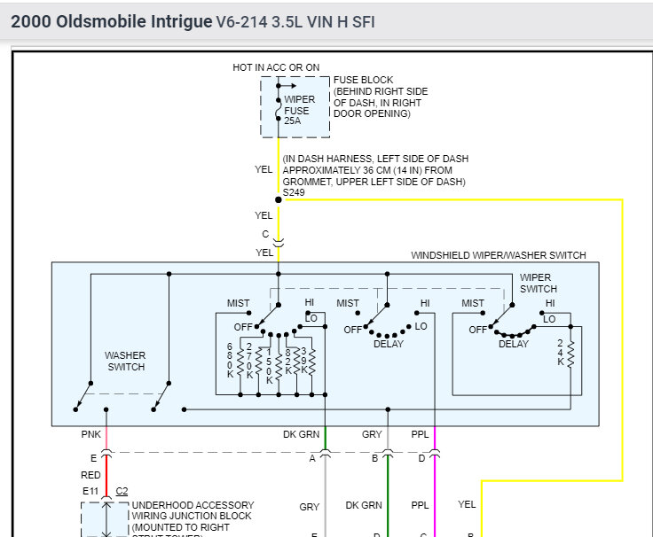

If you have power to the motor, either the motor is bad or there is no ground supply to complete the circuit.
There should be a black wire in the harness at the motor. Disconnect the connector and check the black wire for continuity to ground.
I attached the wiper wiring schematic circuit below, so you have a reference. If there is power, the motor is good (new) it should run if there is a ground provided.
Let me know what you find.

Thanks, I'm going to check the ground circuit out and see what I can find. Thought maybe switch but there's power to the motor wires. It's driving me nuts.

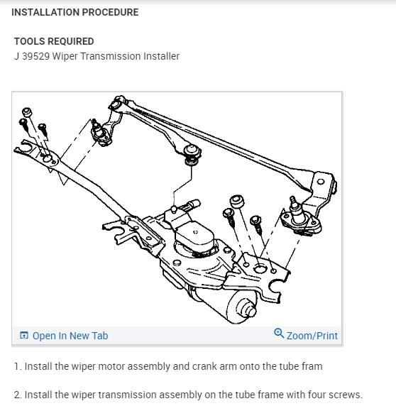

Well, it was the ground circuit. I traced down the ground distribution and cleaned up and redid every ground. The ground for the wipers was corroded and actually had a broken wire at the ground point under ABS unit. i also ran a new ground lead from the wiper motor body to a clean spot on the body. Turned them on and the linkage bind up and popped apart. The motor runs but the wipers don't move. I think I have the cam on top of wiper motor shaft out of position, but I'll try to address that tomorrow. Thanks a million. I'm glad I finally figured it out.

Thanks for the update. I'm glad to know you got it working. The ground was the only thing left I could think of. LOL I'm glad that took care of it.

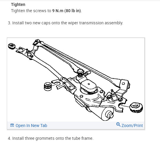

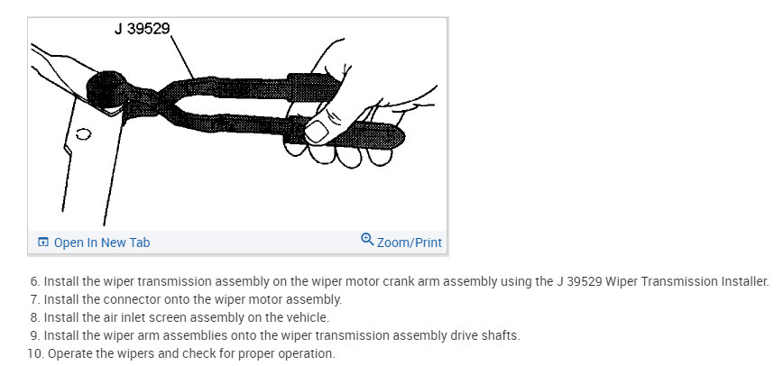

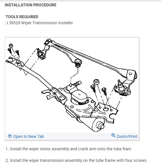

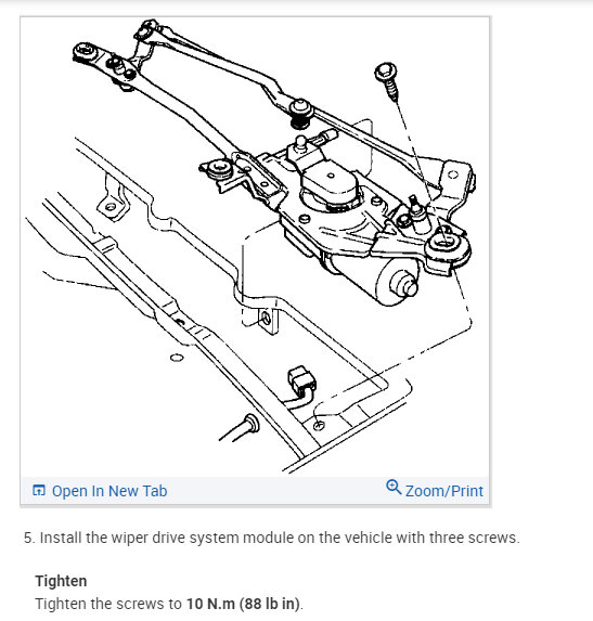

As far as the linkage/wiper transmission, I attached directions below for the installation of everything. I hope it helps.
Take care and let me know how things turn out for you.
