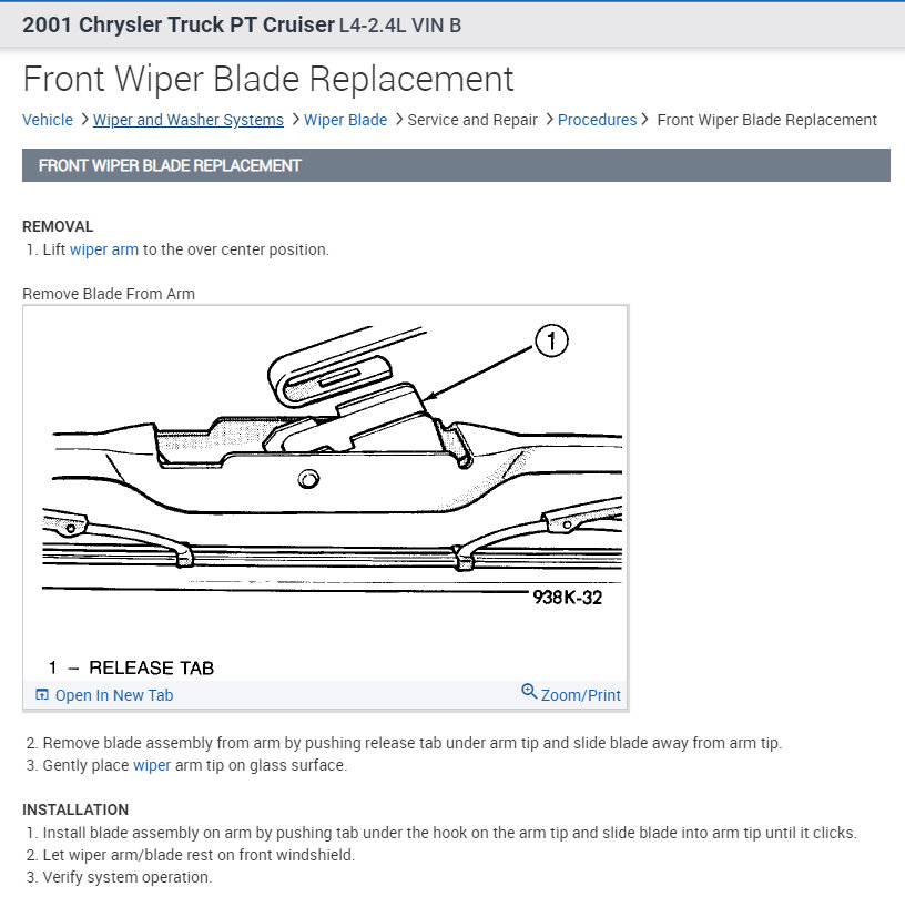

I press the tab to remove the old blade but I can’t get it off.

Sometimes the wiper can be a little hard to remove due to just being stuck on the arm.
Take a look at this video, we did a wiper replacement on a PT cruiser:
https://youtu.be/GHIh5M4zO0g
https://www.2carpros.com/articles/how-to-replace-windshield-wiper-blades
Let me know if you are able to get this done.
