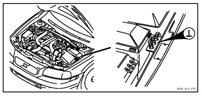

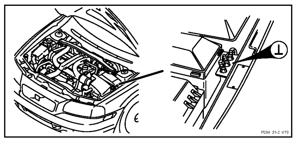

The ground wire will be brown. Its grounding point is the left front strut tower. See pics 1 and 2
Try to splice a new ground wire in place at the wiper connector and as a test, ground it to the negative battery cable to see if things work properly at that point.

Hi Joe, I could not find the ground to the strut, but I made sure the ground was tested and is good. I am thinking it's the switch. Any other ideas?

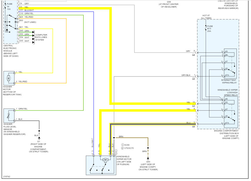

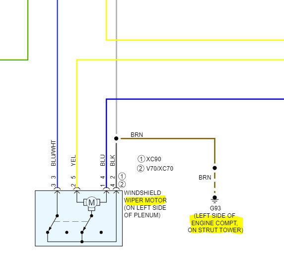

Before we replace anything, let's try one more thing. Disconnect the wiper motor. At the connector, there will be a blue wire and a yellow wire. With the key and wipers on low or high, check if either of those wires has power.

If you are not getting power to the yellow or blue wire, I think the low/high wiper relay is bad or we have a connection issue. At least, that is what we need to check next.
If you look below, I highlighted the power wires for the motor to run. Both of these wires come through the relay.

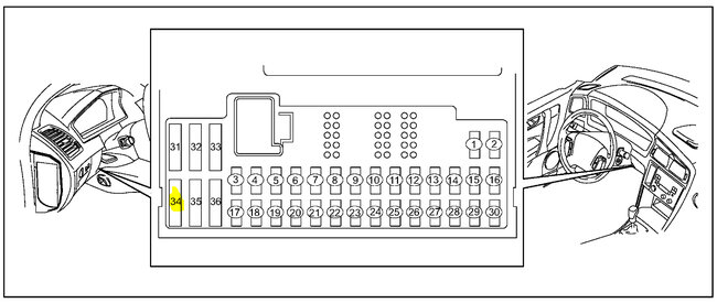

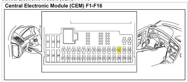

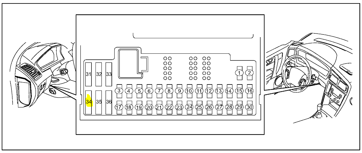

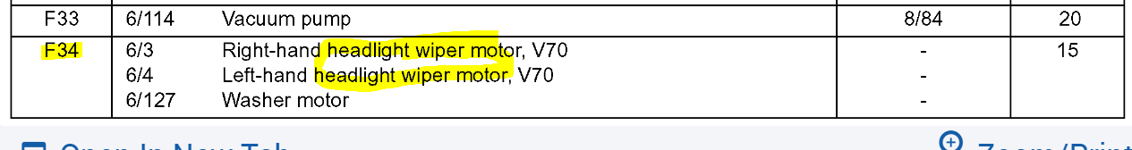

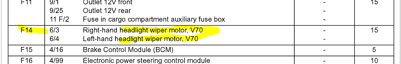

I have one last fuse to check. Also, please confirm for me that pin 85 of the high/low relay isn't getting power with the key on and the switch on high or low.
Also, check fuse 34 under the dash on the left side as well as fuse 14. I'm looking at the legend for the wiper motor and it is showing two different fuses for the headlamp wiper motor. Ugh!!! One is likely listed wrong.

Hi Joe, I checked the fuse with the multimeter and it is good.

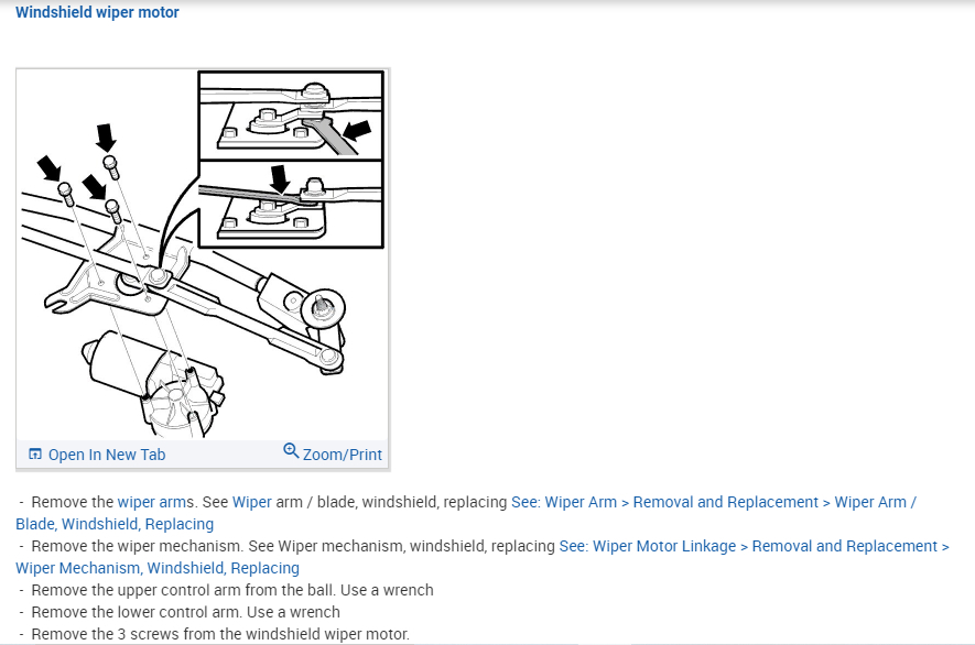

  • 110,248 POSTS

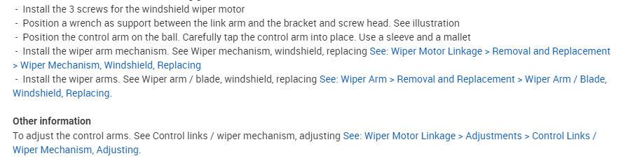

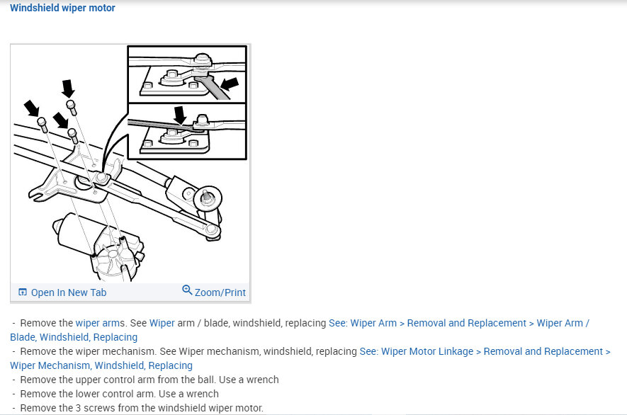

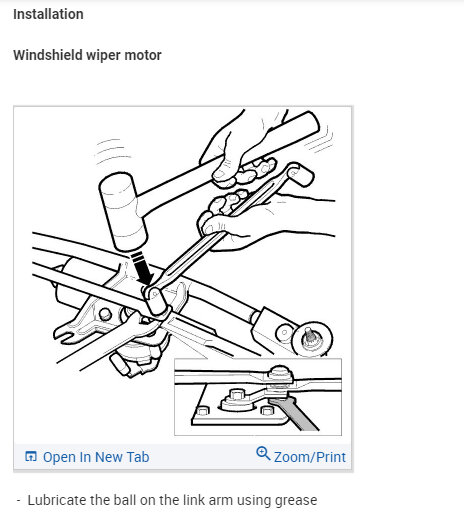

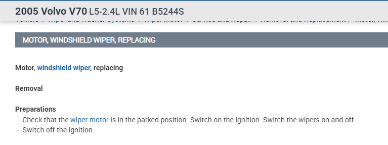

Okay. Based on all the tests, it sounds like the motor itself is bad. If you look below, I attached the directions for the removal and replacement of the motor.
Take a look through them and let me know if you have questions.
Let me know how things turn out for you.
