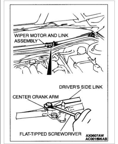

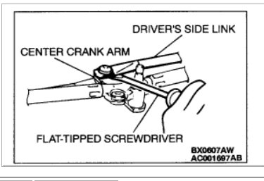

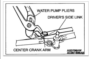

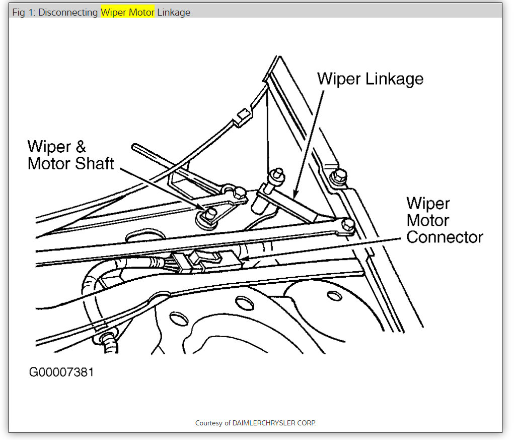

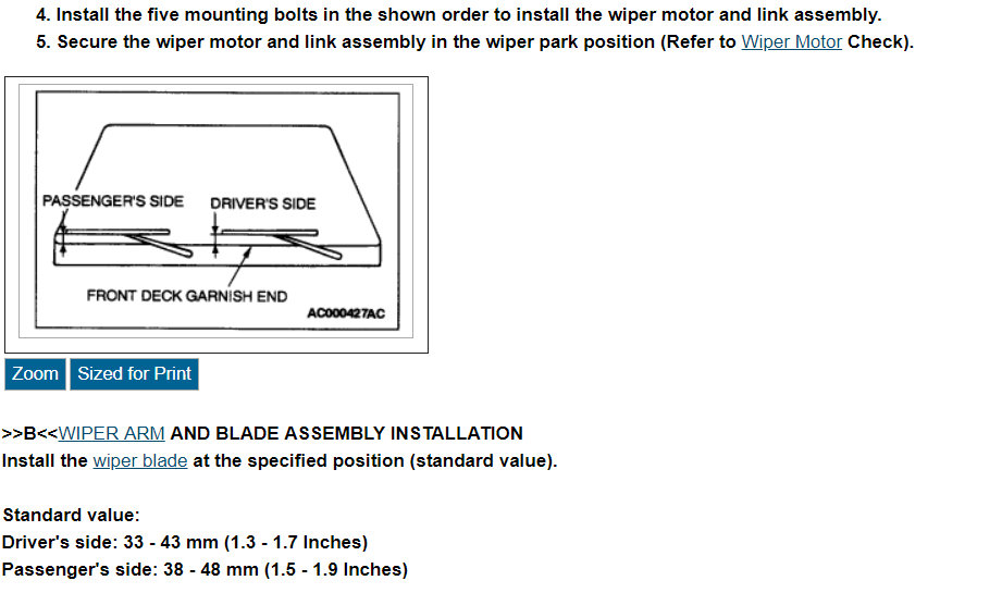

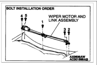

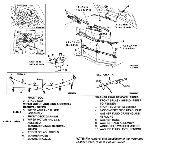

Wipers work on both Hi and Lo speeds, do not work on intermittent speed. Also, when turning off wipers they do not go to a park position.
May 10, 2018 at 5:08 AM
  • 55,588 POSTS

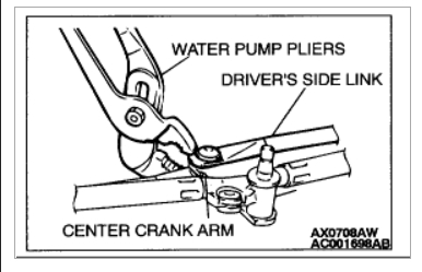

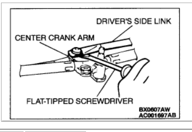

This sounds like the wiper motor is no good and needs to be replaced. Here are diagrams to help you get the job done. Check out the diagrams (below). Please let us know what happens.
