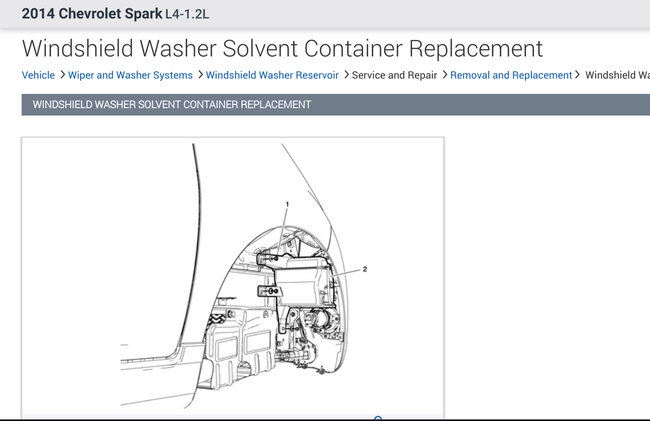

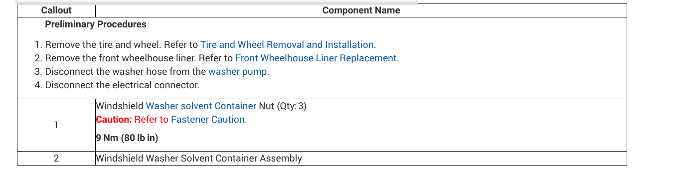

Hi. I'm looking for instruction on how to remove the windshield washer reservoir from the car listed above. Looks I'll have to remove some parts to get to it.

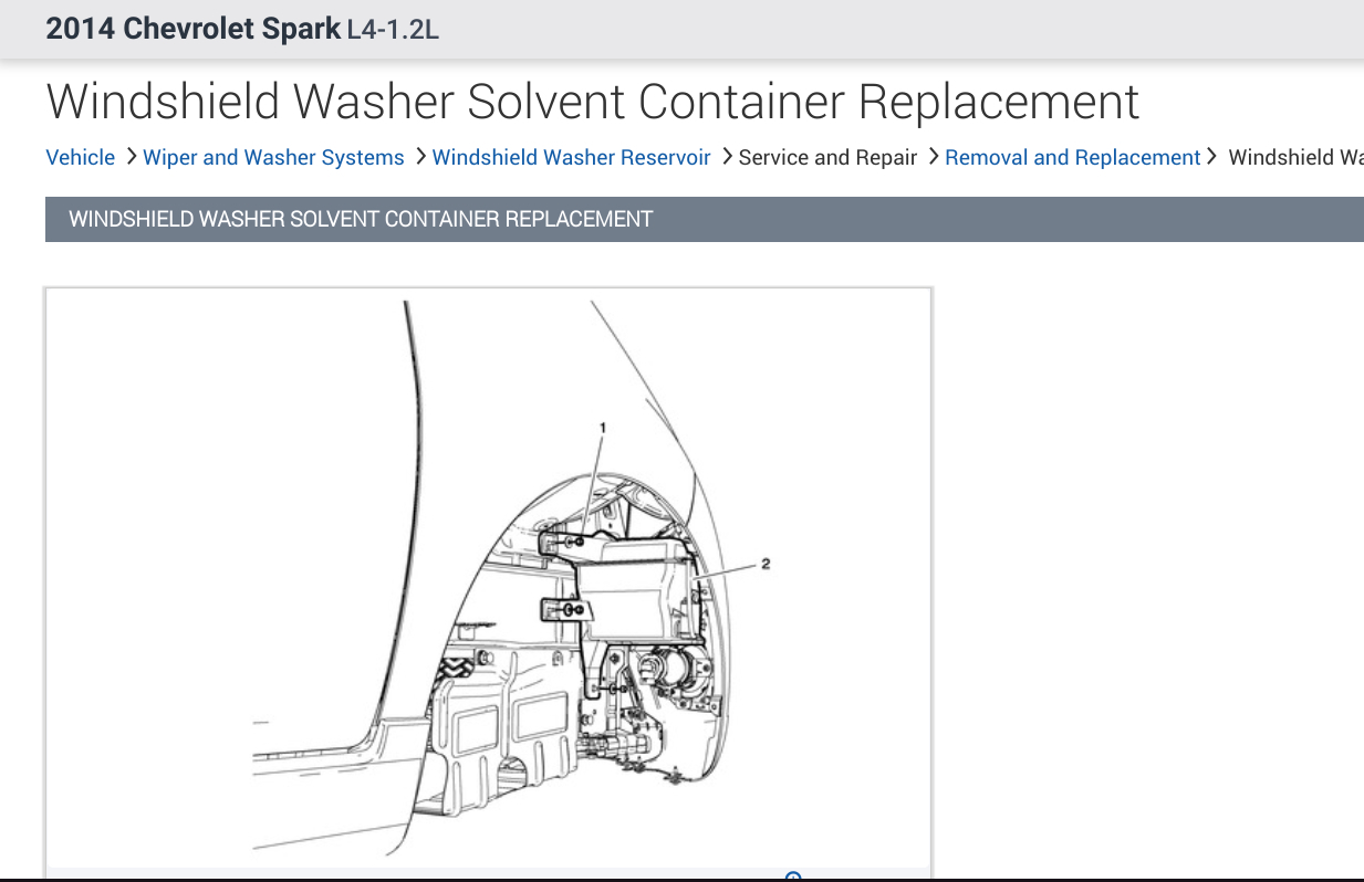

The procedure is pretty easy. It calls for you to come in through the fender well. I have included the manufacturer's instructions for the removal and installation of the windshield washer reservoir for your vehicle in the diagrams down below. I hope that this helps.

Ah, much easier than I expected. Thanks!
