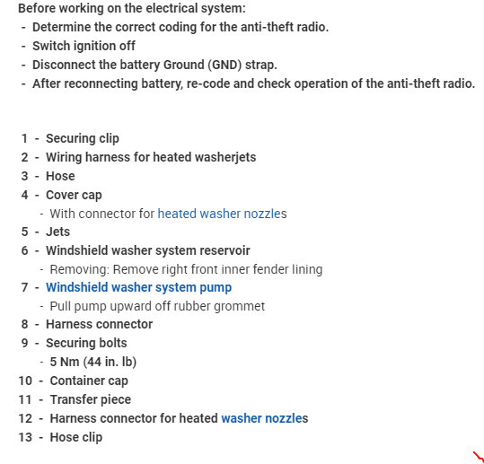

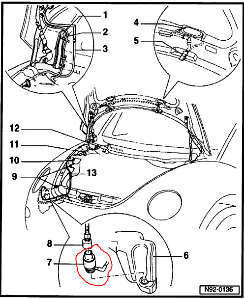

What to disassemble to access the pump motor for replacement ?

The actual pump is mounted in the washer fluid reservoir. If you remove the reservoir from the vehicle there will be an electrical wiring harness connector a a rubber washer line to disconnect.The pump is just a pull out/push in connection in a rubber grommet to seal the pump to reservoir. I've attached pictures below and circled in red.Hope this helps and thanks for using 2CarPros.
