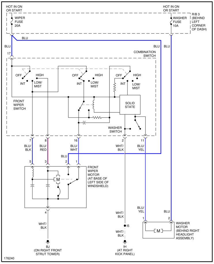

I have a problem with my windshield washer. I have tested my pump directly to the battery and found that its works normally but when i connect it to the car the wiring can't work. I would like to know is a problem of short-circuit and i would like to ask for a Diagram of windshield washer circuit.

See diagram below for WWS system layout.
Please first check that the washer fuse 9, 10A, on the dash fuse board is still intact.
https://fuse-box.info/toyota/toyota-mr2-spyder-w30-1999-2007-fuses

If the fuse is good next check that you have 12V, with ignition on, at pin 2 at the washer pump. This is the blue wire.

If no 12V is present, then next check that the blue wire between fuse 9 and the washer pump is intact.

If 12V is present at pin 2 at the washer pump, next check that a ground is applied to pin 1 when the washer switch is activated. If no ground is activated when pulling the washer switch then next check the wire, blue/yellow, between the pump and washer switch.

I would like to thank you for the help you have given me with my windshield washer pump. I followed step by step all the steps you gave me to follow the found that it was the pump which was not working. I replaced it, now everything is okay.
