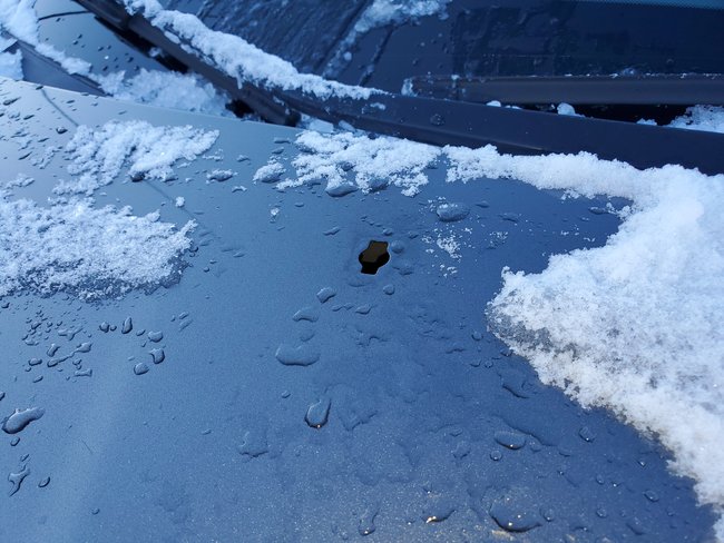

The picture below shows the open space where a button is supposed to be where the windshield washer exerts from to the windshield. Now, it only drips down to the hood of the car and to the ground. Is this an easy fix or is it complicated to fix.
Feb 7, 2021 at 9:22 PM
  • 110,244 POSTS
Yes, it is an easy fix. First, go to the parts store and purchase a replacement. Next, open the hood and locate where the insert belongs. The insert will clip into the opening. One you have it in, you will need to attach the hose that provides the fluid.
